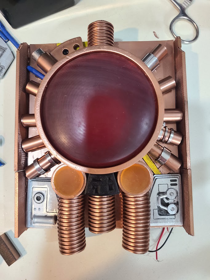

    BT-1 is getting a facelift starting with a brand new eye. I bought the Hot Toys BT-1 last year and I really liked the attention to detail. I realized my BeeTee's eye wasn't accurate or detailed enough so we're starting over. I resin printed the eye and the two smaller lenses. I really love the way the eye effect turned out. I'll have to post another log with the video when I take one.
