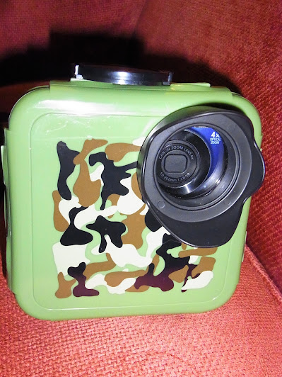

CHDK will allow you to do pretty much anything on a Canon P&S camera, but if you plan on shooting over very long time intervals, you need a large battery or mains power, since Canon P&S cameras  don't have a sleep function (actually I am not aware of *any* of the shelf low end camera that does). The idea here is to eliminate the need to lug around a heavy lead acid battery or large LiPo... or perhaps a large solar panel.
This little project builds on the weatherproof box idea above, and will allow you to use very little power (uA) during the big sleeps, and thus should allow you to take an SD card full of sunsets using just the camera's own battery (or whatever small lipo battery pack you have).
The basic work flow is as follows... Program our timings on the 'duino. Set the camera up in its weatherproof box. Point it West (or East for sunrise). Let it time-lapse the sunsets/sunrises for the next week/month.. Come back when it is done, and hope someone hasn't spotted it and run off with the results.

Arduino pro mini clone, nokia 5110 diaplay, 18650 lipo, 8205A dual mosfet, RTC module and a big mess 'o wires.
Note the yellow tape, holding down the power button on the camera, just visible in the video, this ensures the camera powers on the moment we feed it from the LiPo. Not pretty, but it works.
