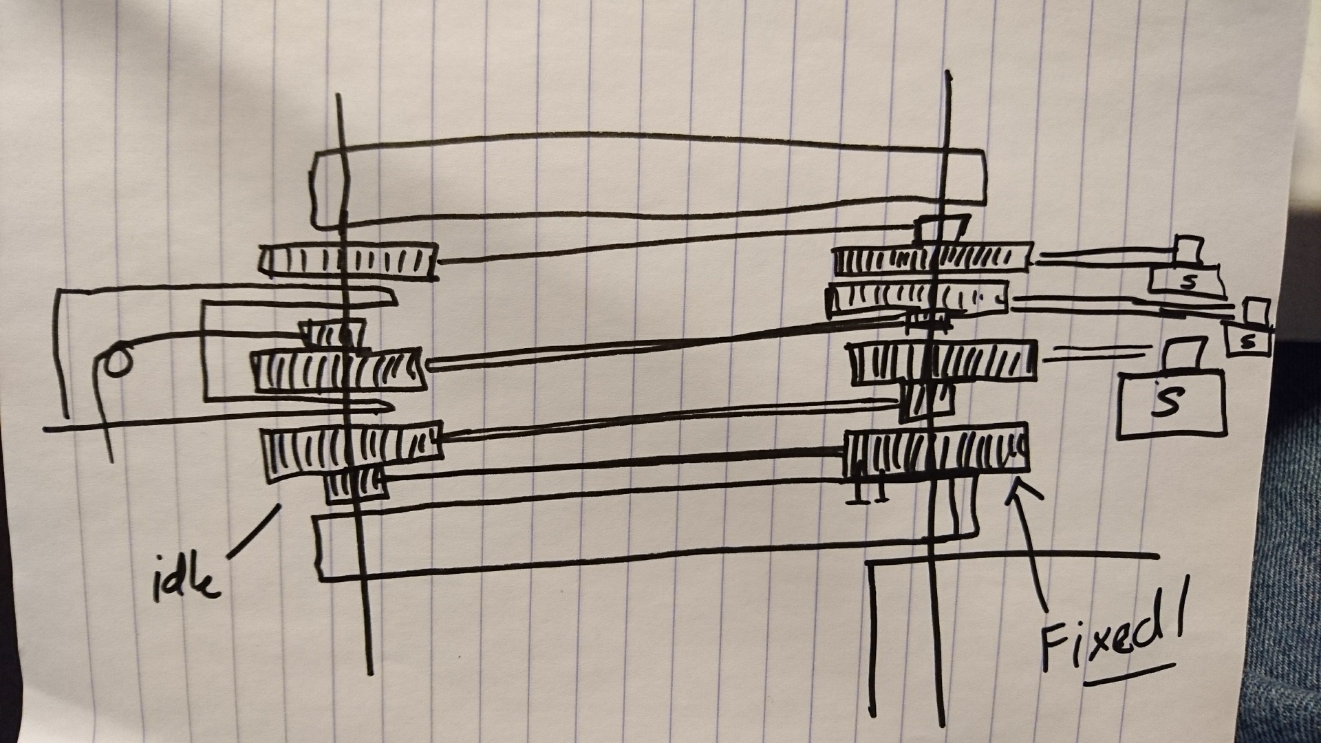

I have been furiously working to get out v0.2 that fixes many of the issues I found in v0.1 (the first prototype). I did a fair bit of design work in Autodesk Inventor because I am most comfortable with it. Once I felt good about the design, I moved over to Onshape and started remodeling the design but this time I made it highly parametric. The idea is that you can change a few parameters to make the parts suit your on hand components and personal goals. Everything was going well until I took a break to work on the kinematics of the new layout. I immediately found a core flaw that caused the whole redesign to fall apart like dominoes.
THE PROBLEM
Can you see it? The bottom belt can't do anything. I swear I thought about this being a problem and then figured a solution around it but here it is. I have a solution for this but I have to start from the ground up again. This design is very interdependent and all the parts have to work in concert. I actually like the new direction better but it has delayed me a week.
I am obviously still working on the design and am not ready to publish step by step instructions for this project. However, in a show of good faith, I have uploaded my working prototype files and firmware. I can't stress enough that no one should build it directly. There are some easy things that could be fixed. (belt tensioners, fixed arm lengths, increased mechanical advantage, plastic reduction)

sander wrote 05/10/2017 at 08:53 point
Does this help?
Nicholas Seward wrote 05/10/2017 at 08:56 point
The bottom two belts can't move relative to the arm.  The three stage reduction is really just one.  This exact layout got me too.
sander wrote 05/10/2017 at 09:02 point
ohh yes, so in the end it should move to the base maybe, but that takes room..
unless you have a small stage in the other stepper pilar maybe... with just a m8 bolt (short).  hmmmm
http://www.epenko.com/wp-content/uploads/2017/05/hellios2.jpg
Florian Festi wrote 10/05/2017 at 08:46 point
The drawing is 90% right. The pulley marked with "fixed" needs to be fixed to the base not to the arm. That way the idler pulley can use it to move itself around it. So instead of the last pulley the arm moves.
Florian Festi wrote 10/07/2017 at 00:02 point
I guess there is no way to do a 2 step reduction this way (other than moving the intermediate shaft elsewhere).
But a 3 step reduction is probably what's wanted here anyway. The first joint has twice the arm length to deal with when fully extended. And it only costs a bit of extra height of the arm and a double idler pulley.
smunter6 wrote 05/10/2017 at 01:02 point
Is there a reason you can't use a live shaft on the shoulder axis? Connect the upper and bottom pulleys together, and stack the wrist belt/pulley on top of it on another bearing.
Nicholas Seward wrote 05/10/2017 at 04:30 point
I don't quite follow.  Could you sketch something out?
smunter6 wrote 05/10/2017 at 22:41 point
http://imgur.com/t6uwVz4
Does that make sense? The x's are bearings.
Nicholas Seward wrote 05/11/2017 at 00:35 point
So the middle pulley can slide up and down?  Its not making sense to me yet.
smunter6 wrote 05/11/2017 at 00:39 point
The middle pulley can rotate on top of a shaft that connects the upper and lower pulleys. Then the upper and lower pulleys are fixed together and don't both need to be driven by separate belts.
Nicholas Seward wrote 05/11/2017 at 00:47 point
Oh.  Yeah that can be done but the new design works with a dead shafts and a bunch of duplicates of the same compound pulley idler.
