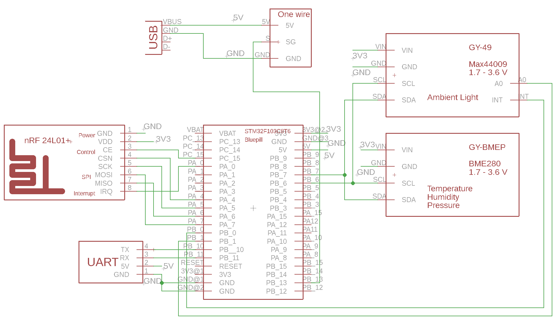

STM32 RF sensors Node Concept
  • Always connected to a power supply (no low power worries)
  • usage as RF dongle for a Raspberry pi
  • RF repeater with color status
  • Fixed sensors node (wireless nodes are more efficient but this one is simpler)
  • Control node (hopefully when the gesture gets working with the APDS9960)
STM32 RF sensors Node PCB v2
also on github
  • Added USB connector for power supply, although not connected to the uC USB, this connector is very handy to make a space efficient node housing, similar to a smart USB dongle.
STM32 RF sensors Node v1 Board
  • It is possible to connect either a MAX44009 module or an APDS9960 in the middle I²C slot.
  • Note v2 has USB connector in addition (not depicted here)
