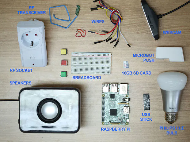

In a very simple and inexpensive way, you can create a DIY remote that will trigger all your favorite appliances, lights and devices by setting up pre-organized scenarios based on your daily needs. The main place of transition of your house is your doorstep, where you leave/enter your house, the place where you go from one scenario to another. That’s why we decided to create a master remote control installed right at the entrance of your smart home so that you can tell what you want to your home right when passing its threshold.
FEATURES
This project can be done in about an hour and can cost as low as $40.
Optional: MicroBot Push

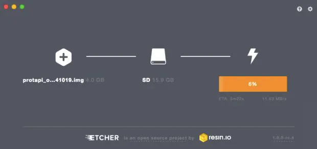

Prota OS can be downloaded for free on https://prota.info/prota/pi/. It’s only 3.8GB and easy to burn on a SD card (make sure to use a 16GB card).
Follow the instructions of Raspberry Pi foundation to write the OS image on your SD card. Extract the .img file from the zip folderPlug in your SD cardDownload and open Etcher, select the image and the drive and start the process. That’s it!
Once Prota OS is burned on the SD card, you can follow this simple installation guide to set up your Prota hub (less than 1 minute!). You only need to define its name and password, your time zone and your email address and the rest is completely automatic!
That’s it! In less than 15 minutes and with no hassle, you transformed your Raspberry Pi into a Smart Home automation hub!
