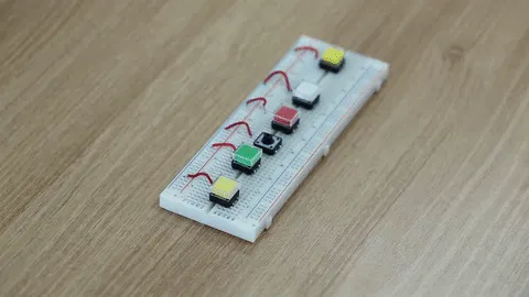

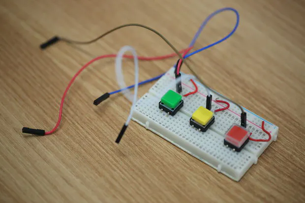

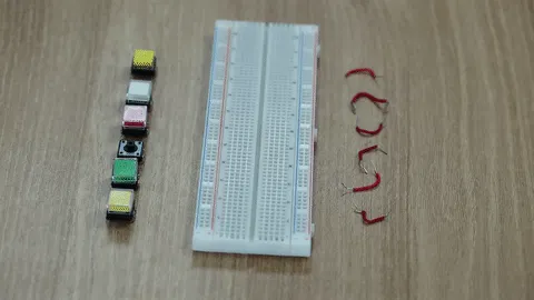

4Step 3: CREATE YOUR SMART BUTTONS ON YOUR BREADBOARD AND CONNECT TO PROTA PI
A breadboard is a board that helps you connect electronic components together and to your micro-computer Raspberry Pi. A small breadboard can be enough for this project (the GIF above were taken from the DIY Jukebox project wth a bigger one.
First, let’s install the buttons on your breadboard. Separate each button enough. And connect hook-up wire between one of the leg of the button and the minus (-) line. That will allow us to use only one jumper wire for ground connection.
See GIF above
Now connect a jumper wire next to the other leg of each button (it must be on the same line number). This will make the data connection between your Raspberry Pi and the button to transform the physical push on the digital interface.
See 2nd GIF above

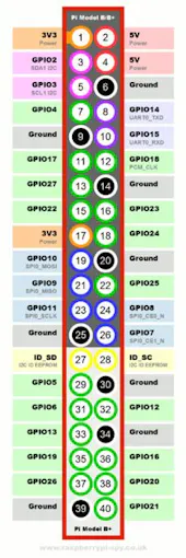

Now it’s time to connect those wires to the GPIO pins of your Raspberry Pi. Connect the wire in the ground line to a ground pin. Then connect each button jumper wire to GPIO pins, following the map below. For instance we chose here to connect with GPIO17, GPIO27, GPIO22.
Basically you can connect to any green pin on this map.
The physical connection is now done, we now need to set up the Prota Pi to recognize each button being pressed. For this we will use GPIO app in the next step.

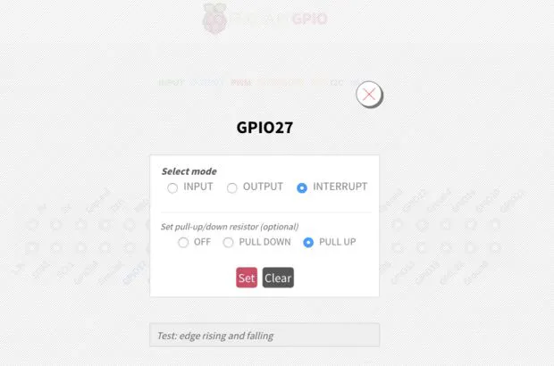

SET UP YOUR SMART BUTTONS ON GPIO APP
GPIO app is an app that allows you to create command names for physical elements connected to your Raspberry Pi, like those buttons. We will later connect these commands into automation workflows (step 7).
- Go to App Libraries and download GPIO app
- Open GPIO app
- Click on GPIO 17 and set it to Interrupt // Pull up
- Click on “Set”
Now when you press your button, it should display on your GPIO interface (as below) “Rising interrupt” and “Falling interrupt”.
This means your Prota Pi reads the action of pressing the button. Now you can do the same thing with GPIO27 and GPIO22. Make sure all dots are lighten up like below, meaning all pins are set up.
Test each button to see if you do have for each the message “rising interrupt” / “falling interrupt”, which confirms the connection is working fine.

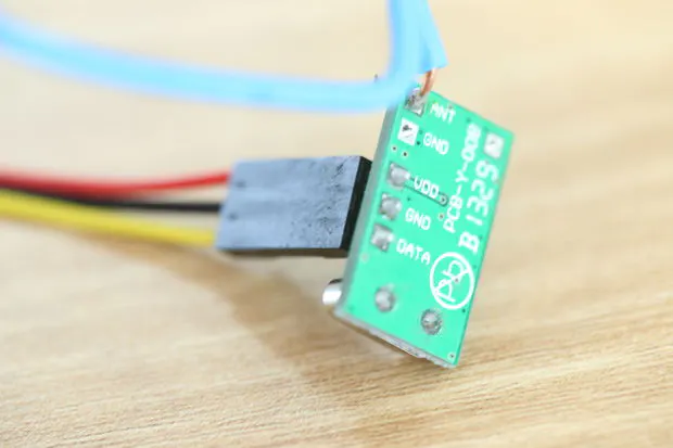

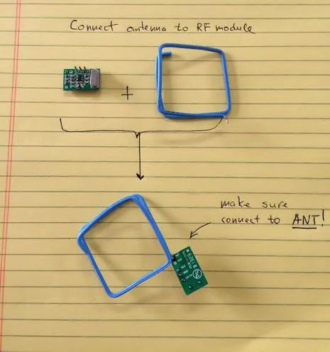

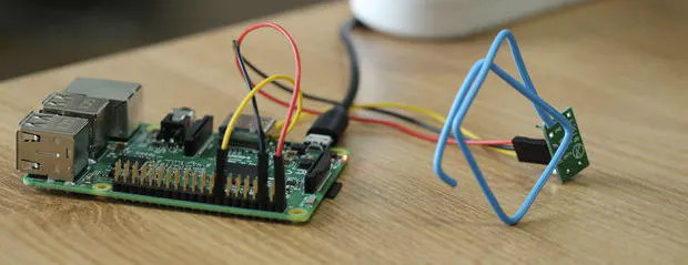

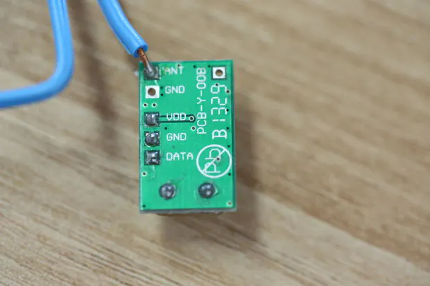

You need to solder the RF transceiver and home-made antenna together. Make sure the soldering connects the antenna to the ANT port on the RF transceiver.
You can have more information on how to make an external antenna in this article.
Keep in mind that the required length of your antenna will depend on the frequency of your RF socket. Our OS supports 433, 477 and 315 MHZ.
Once soldering is done, plug three jumper wires to your RF transceiver (433/477/315 MHZ).
VDD = Electric current (5V) GND = ground (select a ground PIN) DATA = has to be connected to GPIO23
You can connect those three jumper wires as we did on PIN 2 (5V), PIN 6 (GND) and PIN 16 (GPIO 23).
The last step is to connect the configured antenna with the RF socket.

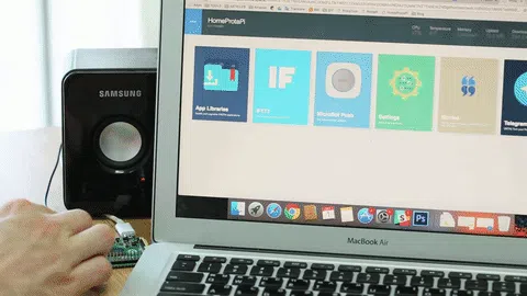

6Step 5: CONNECT YOUR SPEAKERS
Connecting speakers with your Prota Pi is very easy!
Just plug an AUX cable to your Raspberry Pi and transform those old speakers into smart speakers that can be turned on remotely or play automatically you favorite songs based on pre-programmed playlists. It allows you to simply play all the audio files stored on your storage device.
- To use Volumio, follow those simple steps:
- Plug a USB stick with your favorite music in one of the USB port of your Prota Pi
- Go to App Libraries and download Volumio app Open Volumio
- Click on the bottom left button “Browse”
- There you will be able to select the songs you want to play. Go to Shared, select your storage device, click on right side icon and add them to your playlist.
Now that your speakers are connected, you will be able to link them to your buttons so that the music is triggered or turned off when you press on one of them.

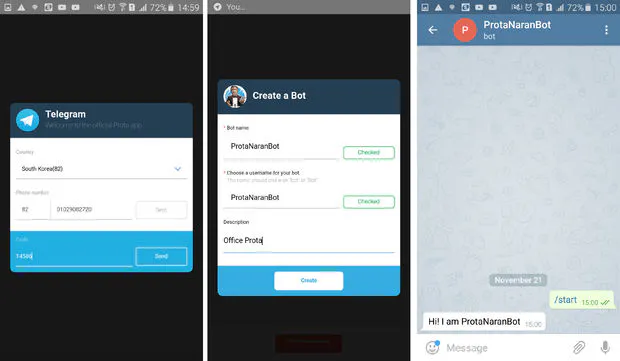

Your homemade webcam will be able to detect motion and warn you when something happens at home and send you a snapshot of it. Those snapshots can be sent directly to your smartphone via Telegram. Let’s set up a Telegram Bot that will be the gateway between you and your home when you’re away.
A Telegram bot is a virtual assistant that you can create on Telegram messenger app.
- Download Telegram app on your smartphone and create an account
- Download Telegram app on your Prota Pi (in App Libraries)
- Open the Telegram app on Prota and click on “Request Authorization”
- Set a name and username for your bot, then click on "Create"
Your bot is now created! It will allow you to receive snapshots from your webcam directly when motion is detected.
