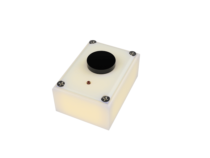

I then began to solder together the PCB, trying to make it as thin and small as I could. GPIO 15 had to be connected to GND, GPIO 2 went to VCC, and I added a tact switch between GPIO 0 and GND for flashing sketches.
After the board was complete, I started to create a model of an enclosure in Fusion 360.
I 3D printed the parts and assembled everything together after thoroughly sanding the pieces.
To test, I pretended to be walking slowly and then suddenly trip on a ledge. The LED lit up and 5 seconds later my phone was alerted. There is also a mechanism to prevent false flags. After it detects a fall, the user has 5 seconds to press the button, preventing a signal. You could also just push the button in the event of any other emergency, such as a heart attack or stroke.
