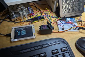

I intend to implement an emulation of a Time-Traveling module for ridding us from the tortures of Pipeline Hazards forever.
The simulation will consist of an LPCXpresso LPC1115 microcontroller simulating a machine with such improvement in its pipeline.
The main purpose is to have this built in future microprocessors.
The simulation will have all of the relevant data shown in a TFT touch sensing display.
