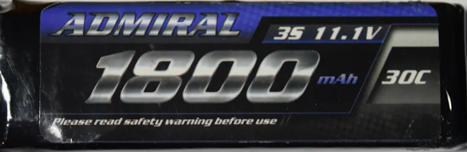

Now there was the question of “How do I power this?” I had to provide power for 2 servos, a Raspberry Pi Zero W, an ADC, a laser diode, and 2 motors. First I divided up each component into voltage requirements. 5V for the Pi, laser, and servos; 3.3V for the ADC and servo driver; 6~12V for the motors.
2, 5V regulators can provide enough current (3 amps) to power all of the 5V components. For a power source, I chose to use a generic RC LiPo battery that could supply 11.7V at 30C and had 1800mAh of capacity.
