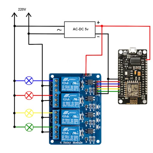

My Christmas lights have 5 wires- one of them common and the rest is colors(red, green, yellow, blue).
The common wire I connected to one plug pin and the other plug pin I connected to common pins of all relays in the module like it showed in scheme. Color wires I also connected to all relays of relay module.
For esp, I used 5V DC power supply which connected to plug.
The control pins of relay module I connected to esp in this way:
IN1- D1(GPIO5)
IN2- D2(GPIO4)
IN3- D3(GPIO0)
IN4- D4(GPIO2)

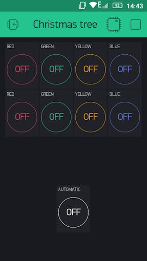

Blynk app
In the Blynk app is placed 9 buttons.
First row of buttons is in switch mode and they operate with digital pins of esp(GPIO5, GPIO4, GPIO0, GPIO2).
Second row of buttons is in push mode and they operate with virtual pins(V1, V2, V3, V4).
If you connected color wires to NO(normally opened) pins of relays you should change buttons output to off-1, on-0.
Automatic button is in switch mode and it operates with Virtual pin 5. If you switch it on, lights will flash automatically.
