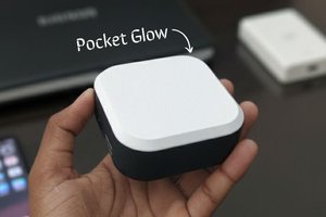

The drill press is being retrofitted with an LED light array.
This array was salvaged from an Ultratec Multifunction LED Emergency/Camping Lamp. This is a very poor piece of equipment: fragile, and without a proper charger for the 6V lead-acid battery, so it didn't last long.
I'm using the large lamp array for the light source. I cut it the main reflector out on a circular saw. This gave me a thin, flat lighting unit that will fit inside the light compartment.
I'll be using the 'battery charger' from the lamp as power supply for the light.
Niel Malan
Randy Elwin
Alexandra Covor
trax
littleBits
