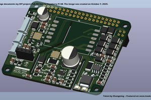

Power over Ethernet 802.3af isolated power supply board for powering your Raspberry Pi B+ or model 2 and its peripherals.
ELL-i open source cooperative is designing and making a standards following PoE 802.3af shield for Raspberry Pi models B+ and 2.
The shield has a flyback isolated power supply and supports real standard PoE. Your Raspi has 5 Watts of power to deal with, so you'll be able to power cameras and most small displays. Raw PoE voltages are available for hackers.
Sorry, you're still dealing with the USB Ethernet chip, as this is just an extractor. By request we can make a new model with ENC424J600 PHY/MAC but then somebody should write a Linux driver for it. Drop me a line if this is wanted. We already made a STM32 Nucleo shield with PoE and ENC424J600.
You can support us on IndieGoGo on the link below and get your own RasPoE !!!
The board takes power and data from PoE-enabled switch. The power is routed to the board where DC/DC module converts it down to 5 volts, while data is passed through transformer to the other Ethernet Jack. A short patch cable is used to connect the shield and Raspberry Pi, Raspberry Pi's own PHY handles the Ethernet communication.
No software setup is needed for the board, board handles the PoE negation automatically and powers the Raspberry Pi through the pin header's 5V connection.

  • New Raspberry Pi PoE boards on oscilloscope
    Teemu Hakala • 05/26/2015 at 07:01 • 0 comments
    May 23
    The new boards with protection diodes have arrived. After a quick soldering, we had a beautiful proto on our desk.
    We tested the boards, full 100MBit/s speed was reached. The next test was to see if our clamping diodes work as they should, so it was oscilloscope o'clock.
    The protection diode clamps the voltage spike to roughly 9 volts. Next thing to do was to plug the cable in and out ~100 times and see if the board would still connect. And connect it does! Now all that remains is to do a few cosmetic adjustments and launch the campaign.
