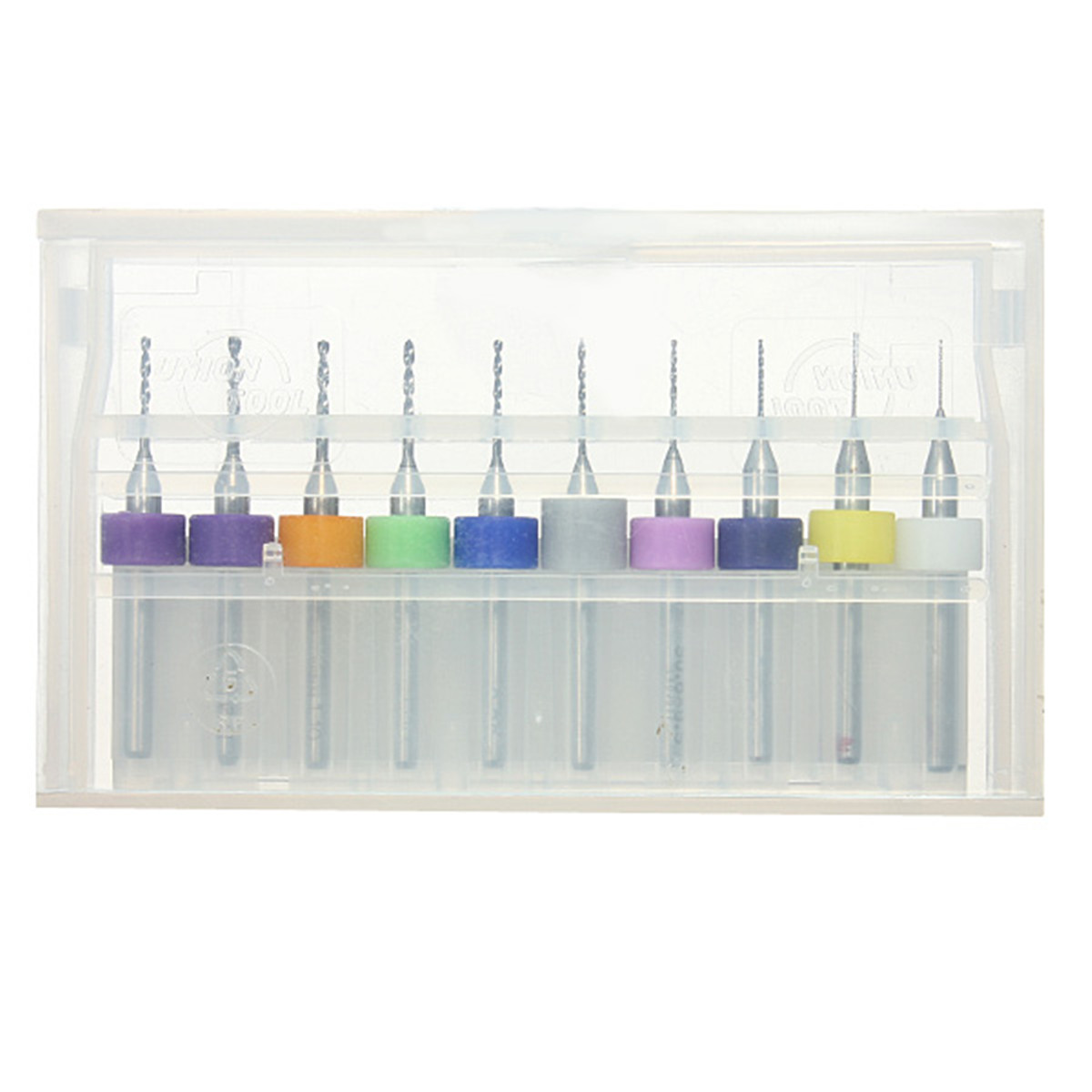

05/30/2015 at 07:23 • 0 commentsSo, earlier this week the drill bit set arrived-- A couple of points, first, on that:
It really, for the cost, is not a bad set. That said, seeing as I do not yet have a full CNC setup and have never worked with such small bits before, a couple of things to point out.
For one, it is not even worth bothering trying to use PCB bits without a drill press-- in all of two seconds, they will just break. I knew this up front, but even with the sort of shaky drill-press I have (while the Y axis is tight, the X axis has a tendency to 'float' due to vibrations when the drill is 'on'), a couple of other experiences worth mentioning.
Typically, when using a soft bit into a hard material, you can (or may even need to, especially if the bit is not sharp enough) perform a series of successive presses into the material-- part of the reason being to remove any extracted material from the bit, to keep it from completely seizing up in the hole.
However, that just doesn't work in this case, either because of the strength of the bits themselves, or that the tolerances are just so small. Ultimately, it is sideways torsion, less than downward force that will cause a bit to snap, and out of the box I broke two testing this process (also, for that reason, always remember to wear protective eye-wear).
So, what I found is that while yes, it is key to 'steady' or support the PCB from underneath while on the press, unless you have some sort of uniform type of solid sacrificial support, such as engineering foam, regardless, under the pressure of the drill, with a large enough sized board, it will start to bend.
The immediate tendency then is to back off-- but don't-- Go careful and, as always, slowly and the bit won't snap and you'll have a nice drill out.

I found the smallest bit I could in the shop [and still, I imagine it is 1.6 mm at best], but it is still much too large to fit through the maze of certain traces needed here]
Also, always wear eye protection when working with small bits, as they will shatter very easily.
