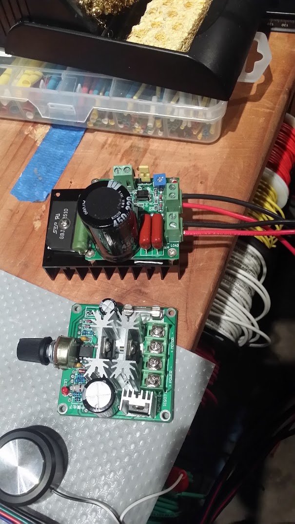

Picked up a different spindle controller, about $10.
old one below, new one above.
Says it is good for 300W,,spindle claims 400W, we'll see about that ;)
Wired it up power nearest the blue pot, and motor goes to LOAD, set the blue pot to zero and switched it on, spindle didn't turn so good so far. Turned the pot and the spindle popped into life.
This one actually says 0-5V PWM, but what the heck lets try it anyway
PWM + GND from TinyG
Added to motor controller and moved yellow jumper to J21
fired up chilipeppr
https://github.com/synthetos/TinyG/wiki/Gcode-Support
M3 S2000
and it jumped into life, set it to off with
M5
and it turned off, so great so far! Much better than the other one which would have the spindle on all the time.

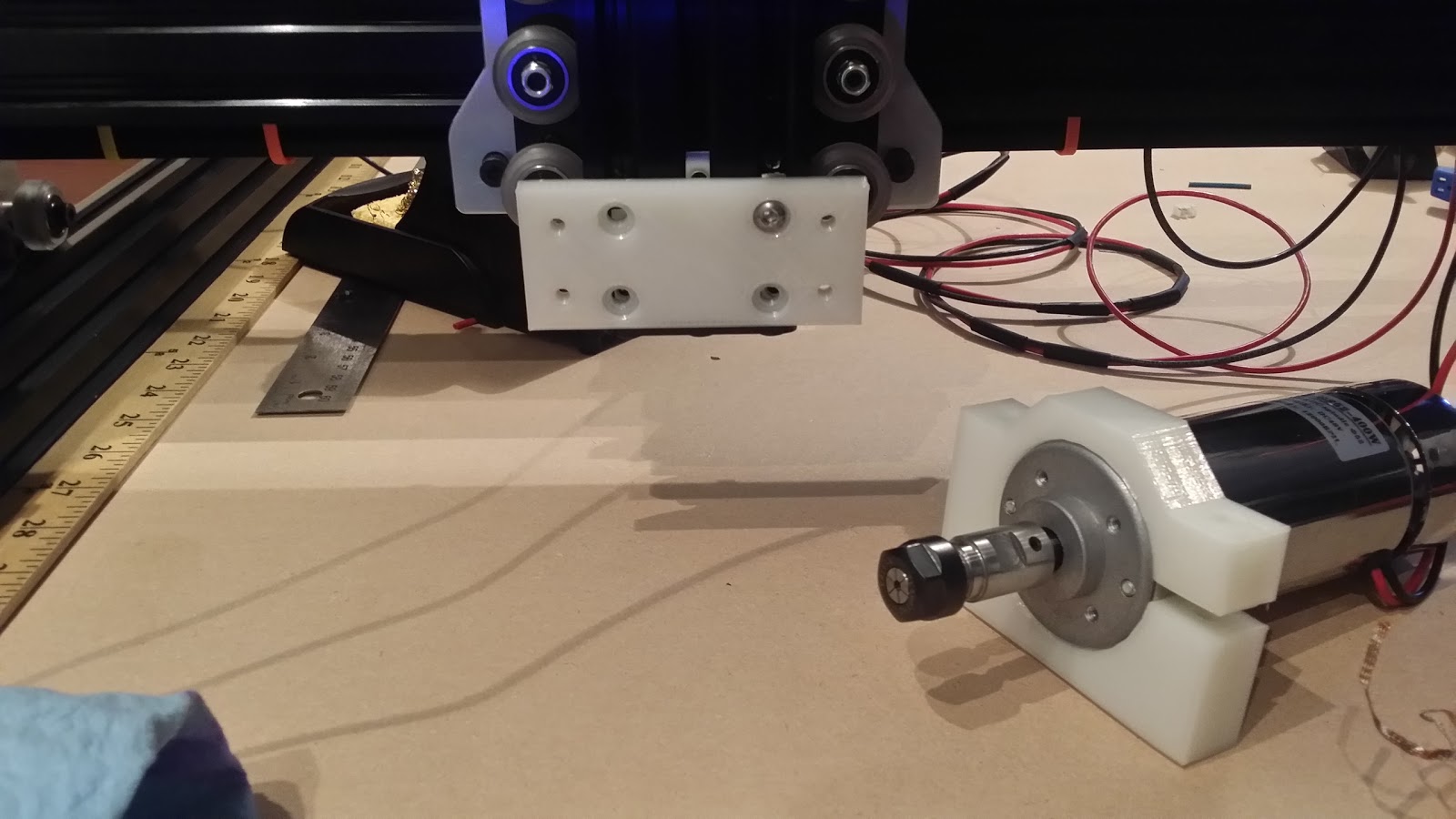

[p1pof] pwm phase off 0.000 [0..1]Spindle mount i made for the OX cnc with a band saw, drill press and a bi-metal wood hole saw ( even thought it claims to cut metal ok) 2" hole saw is 51mm , motor is 52mm so it is fine.
3d printed out of PLA
giant teeth !
no pics of the bandsawing, since i was bandsawing and can't run the camera at the same time ;)
rear plate , fuzzy! drilled it out on the drill press again.
came out ok, temporary wiring since i'm swapping out the speed controller and seeing how it all goes.
so we're ready to make our first 'chips/cuts'

I also 3D printed a temporary holder for the spindle, since all i have is a jubilee clip with the kit... It is glow in the dark since that's what was on the machine when i printed it.. Since its PLA it's only really good for a test mount while i CNC out a new one.
https://github.com/dhylands/3D-Printed-Parts/tree/master/OX

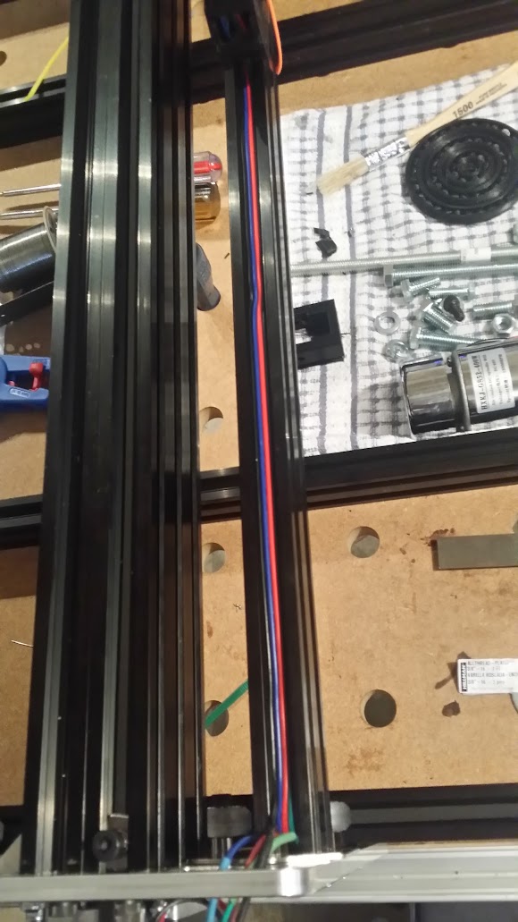

Wired up the TinyG to a 24V Power supply.
I also picked up some track from amazon, its a tad bigger than I needed, but it'll work.
Soldering up extension wires for the steppers, these will run inside the track.
tie wraps til i figure out where it all goes
ended up a little short here, can just add another.

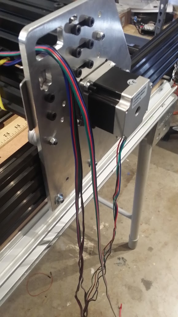

so while wiring up the two steppers for one side of the X and the Z i was moving it back and forth and thinking hmm while the strange resistance, of course since i was adding one piece of 4 conductor wire to the same place, i just soldered one motor to one end, then other motor to the other end of the wire then i'd pull them through and cut the wires. Of course that meant one motor was feeding the other....
Now to go back and add tho two Y motor's , i now realised i hadn't got that far yet and looking to see if the TinyG supports a dual mirror mode like the smoothieboard does, and it does https://github.com/synthetos/TinyG/wiki/Dual-Gantry-Configuration great, also noted that of course the other motor runs the opposite direction...
Right Y motor wiring added, leaving it with lots of cable for now in case of reasons.
threaded it into the extrusion then into the trunk , in the middle where it stops moving for the X.
out the other side, the holes below are for the wires to come out neatly but my awesome shims are blocking them.
ready to wire into the TinyG now.

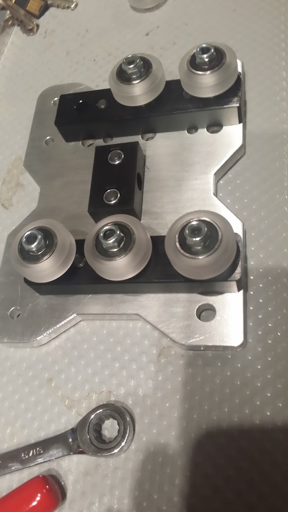

started feeling out the back plate.
add the wheels
and there's a problem, the nice cnc plates have two holes missing, there are four upper wheels, and only two holes.. so i figure lets try the badly made ones, whilst thinking to myself, this is going to be a mistake i should just add the holes.
two holes bad, four good.
so on to the other plate then, how bad can it be, its just finish rght? get the top side on, fits ok.
then fiddle around with it, take off the top wheels they all pop off, try to align bottom screws and eccentrics, take off back beam to able to get to the bolts.
sure enough, the holes don't line up so pretty much impossible to get those eccentrics in there without squishing the wheels, quick eyeball of the nicely CNC'd plate and it looks like it matches, so next adding holes to the back plate....i could just oval the holes but i'm sure there are other issues waiting for me with these SW3D plates.

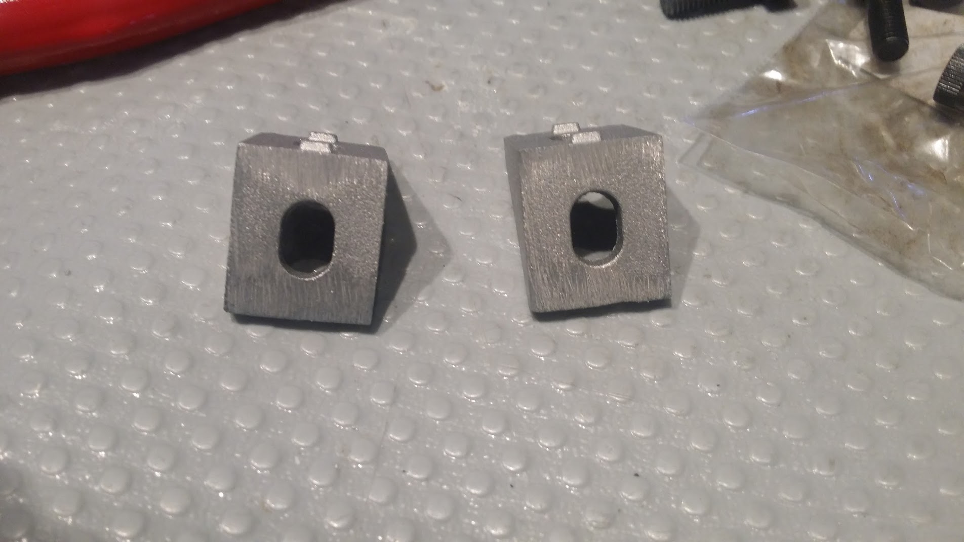

much better, but now i realise the two t nuts are in the wrong slot, the picture in the manual is rotated.. so it wants them in the vertical top slot at the front to mate with a right angle bracket, and not on the top.... i thought it was showing me all three together, the manual is a phgotocopy or poor printer so its hard to see some of the detail, he says.
handily there is a slot cut in the side to allow me to remove the t nuts, but not so handily no such slot on the place its meant to go.

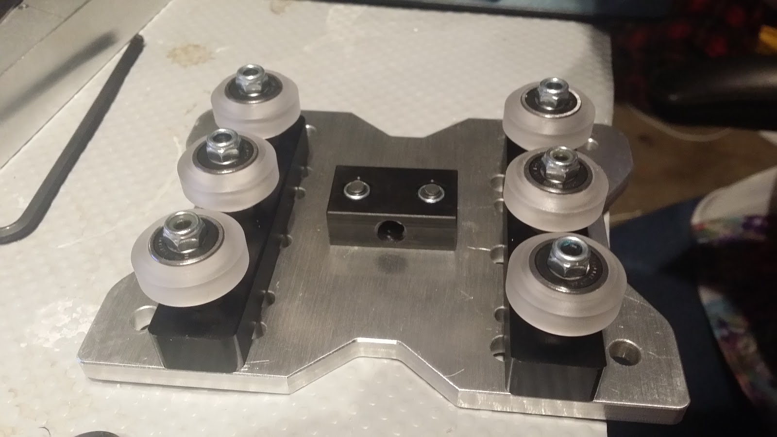

added the lower wheels.
motor and lower wheels with erratic offsets
adding top wheels.
managed to switch the camera to double pic mode..
i found it easiest to put the wheels together this way, bearing, bolt.
then add washer, and next bearing

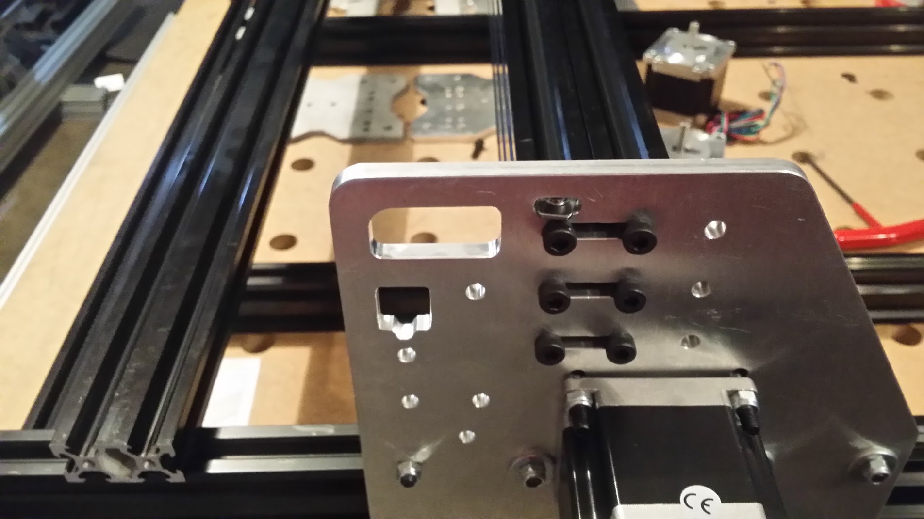

right side gantry plate
mounting them on the rail, pull out bolt til its flush, put the wheel in the V and push bolt into hole on plate. sorry about blurrycam.
All mounted, time to adjust the eccentrics and have it slide and not have up and down movement.
the right side upper wheels don't seem to be properly aligned holes or such, since two engage, and two ride free.
