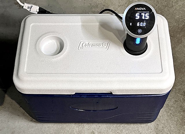

  • Normalizing a Group of Temperature Sensors (with a Sous Vide Cooker)
    Ed Mallon05/14/2026 at 15:29 0 comments
    Combining a Sous-Vide cooker with a cooler gets you a temperature control rig perfect for calibrating or normalizing a large batch of temperature sensors. And this kind of DIY setup has enough volume to handle a mixed batch of sensors from different vendors - although you will have to give them several hours at each temperature plateau if they have a lot of thermal mass. Sensors that are not water proof can be wrapped with food vacuum sealers that sous-vide chefs use for cooking.
