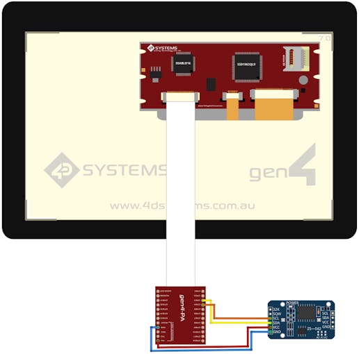

1BUILD
- Build the circuit as shown in the diagram.
