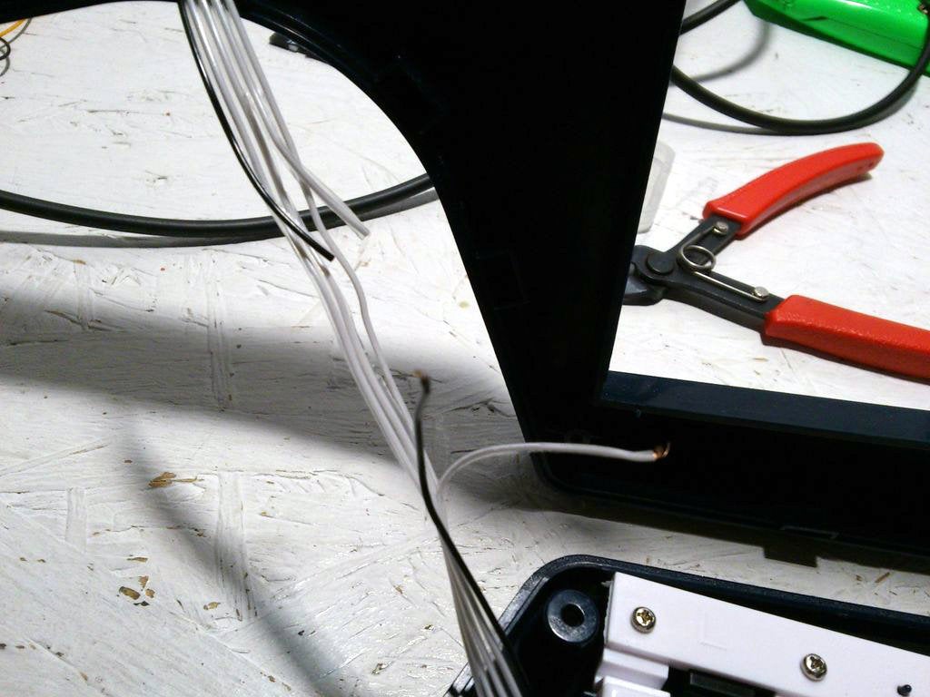

You can see which lines are +3.3V (VDD1) and GND by reading the silkscreen (see image). Use a razor/knife to slice about a 6cm length of these two free of the plastic ribbon joining the five wires running to the touch sensor PCB. Then snip them in the middle and strip the free ends. Slip a bit of heat shrink onto one of the wires, then solder a new wire to each pair of wires you cut. Slide the heat shrink over the bare wires and shrink it down to keep things from shorting.

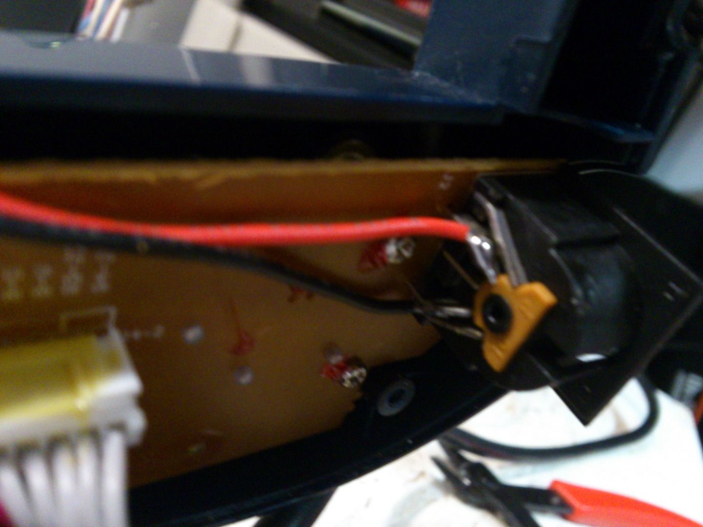

Now for the MIDI port. Solder a couple of long wires to pins 4 and 5 (the pins on either side of the middle pin, see image). The wires should be long enough to reach around the top of the keybed and down to where the XBee/MIDI IN circuit is going to sit, just next to the touch sensor. I recommend lots of solder and a hot iron to get a good bond, and then securing the two wires to the PCB just behind the port with a bit of electrician's tape, to reduce strain on the solder joints and keep them from popping free.

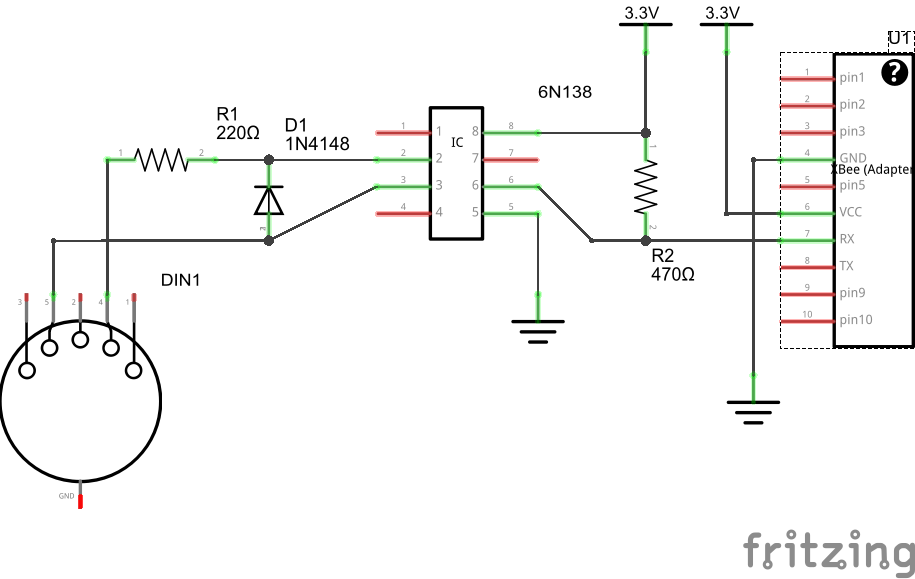

Whack together the circuit shown in the schematic on your perfboard. I always have a crazy difficult time keeping the pins on MIDI ports straight, since they depend on whether you're looking at the front or back of the port, and the things are freaking symmetrical. Refer to the helpfully numbered image if you share my issues.
