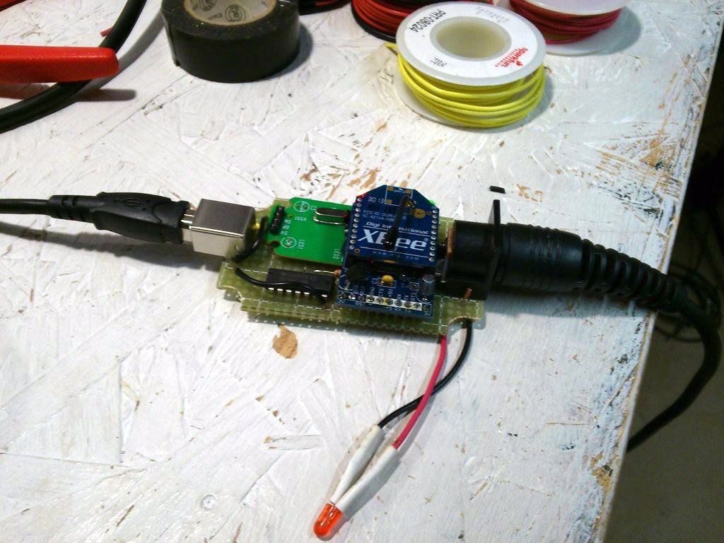

4MIDI Receiver and USB Interface
Now we will build a small box housing the other XBee, a MIDI OUT circuit, and a USB interface that we'll cannibalize from a cheap USB-MIDI interface cable. We can plug it into a computer via the USB port and play sounds in a DAW, or power it with a 5V adapter and plug a synth/sampler or sound module into the MIDI port.

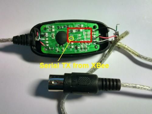

There are a lot of cheap (~$6) MIDI to USB interface cables floating around out there that seem to lack some important components on the MIDI side- particularly the optocoupler we used in our MIDI IN circuit. You can see its outline on the silkscreen in the two example images. Who knows why it's not there, maybe they still work sometimes. What does work (and is probably hiding under that black blob) is the class-compliant USB MIDI interface. We just send the serial data coming out of the XBee to this, and when we plug it into a computer it will appear as a MIDI device. We'll also send the serial data to a MIDI OUT circuit so we can use legacy devices on the 5-pin connector - feel free to omit this if you've decided DIN is dead.
Crack open your cheap USB MIDI cable and check out the circuit board inside. Find the silkscreen outline where the optocoupler ought to be, and the pads where the USB cable is soldered on. There should be silkscreen indicating which pads are 5V (red), GND (black), data+ (green), and data- (white). You may have to trust the wire colors if it's not there. Serial MIDI data (TX from the XBee) should go into the pad located where pin 4 of the optocoupler should be - I've circled it in yellow in the images. The pads in mine were big enough that I could drill holes through the PCB and solder header pins in place. This made it easier to fit into perfboard, but might not work if yours is manufactured differently, in which case solder wires directly onto the pads.

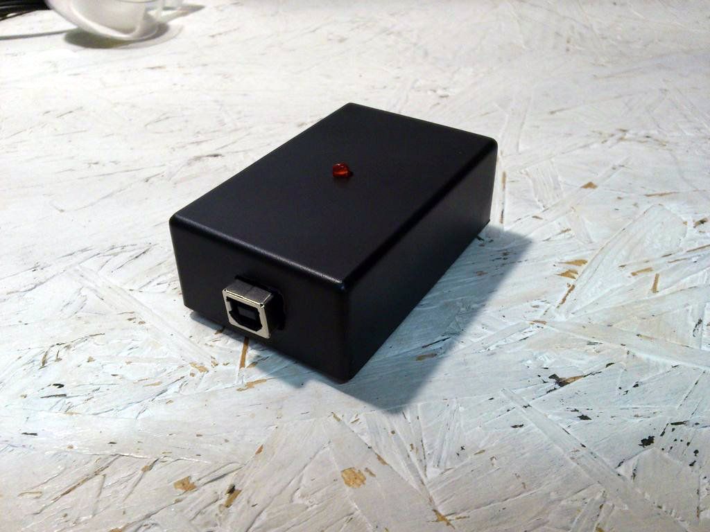

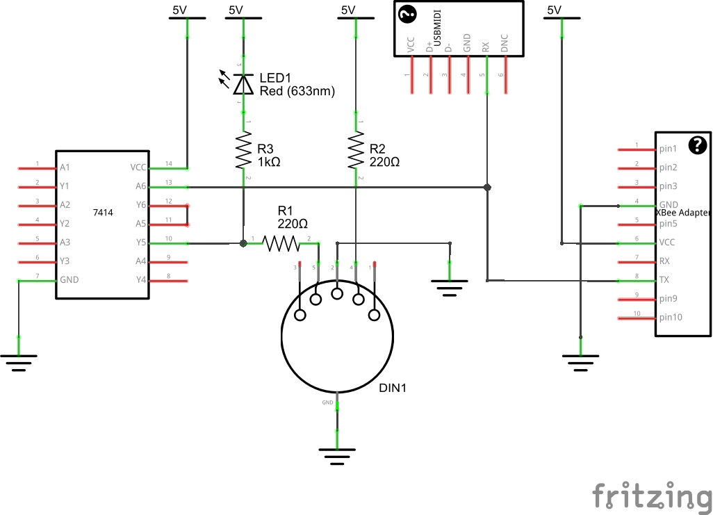

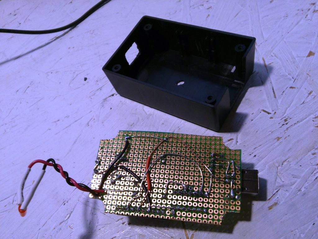

Build the circuit shown in the schematic on perfboard. Again, size your board so it fits snugly in the box. As you can see in the images, I had to have the XBee sit on top of the cheap MIDI cable PCB to get things to fit in the box. I used some electrical tape on the bottom of the XBee adapter to make sure nothing shorted. The required arrangement of components made my under-the-board wiring into a bit of a hatchet job, but perfboard doesn't have to be pretty. Attach the LED with flying wires so you can position it to stick out the top of the box. Cut holes in your box for the ports/LED (a rotary tool is very useful for this) and fit everything in. I found that by sizing the board to fit tightly in the box, there was enough support that plugging in cables didn't move the proto board around or stress the solder joints for the ports. The components fit snugly enough that I again didn't see the need to secure it with hot glue or standoffs.
Screw the box together, write "BeeTar" on the side, plug it in to your computer's USB port, fire up Ableton Live or something, plant one foot on the monitors and start rocking out wireless style!
