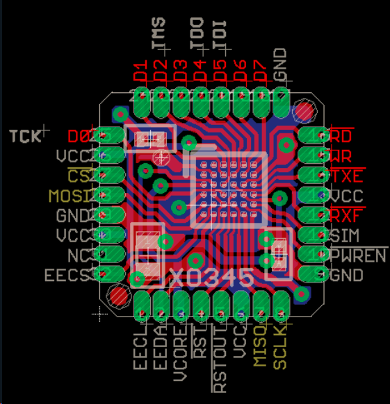

The implementation is straight forward: a 0.4mm pitch WLCSP FPGA sits on a board with an "inspectable" LGA to match the QFP-32 footprint. LQFP-44 IC for reference.
Feel free to contact me if you need one, PCBA only comes in lots.
Details
The Lattice Diamond project and Eagle board files can be found on Github. Pinout:
