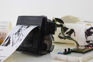

The ESP-01 has just the right amount of I/O to drive a thermal printer I bought from AliExpress for some 20 euros. It connects to a local WLAN and provides a simple web page where people can add items to a shopping list.
An LED shows if there is anything on the list in memory. When a button is pressed, the list is printed out and cleared from memory. This way the list can be created over time and when I go out to the supermarket I can just press the button and get my shopping list.

First of all, after being pointed at the smartness of arduino's Serial.print(int) method, I'm now using write() to actually write out the escape sequences to configure the printer. It works now, so I can set the correct heating parameters and character code table.
Hardware
Here's a picture of the breadboard (including some unused components and inefficient wiring):
The red LED next to the buttons indicates that there is something on the list, but not printed yet. Pressing the print button (in this case the center button of those five) makes the device print the list and clear it. The LED is off again:
The printing quality seems to good. The first line is a bit fainter than the following ones, but well readable.
I had to replace my power supply (USB wall wart) with a "real" 5V/1.6A wall wart to get this printing quality. The USB one I used earlier, although rated for 2A, didn't supply enough current. I was advised in chat to place a short or low value resistor between D+ and D-, but simply replacing it was easier. I'll now clean up the code and put it on github.
