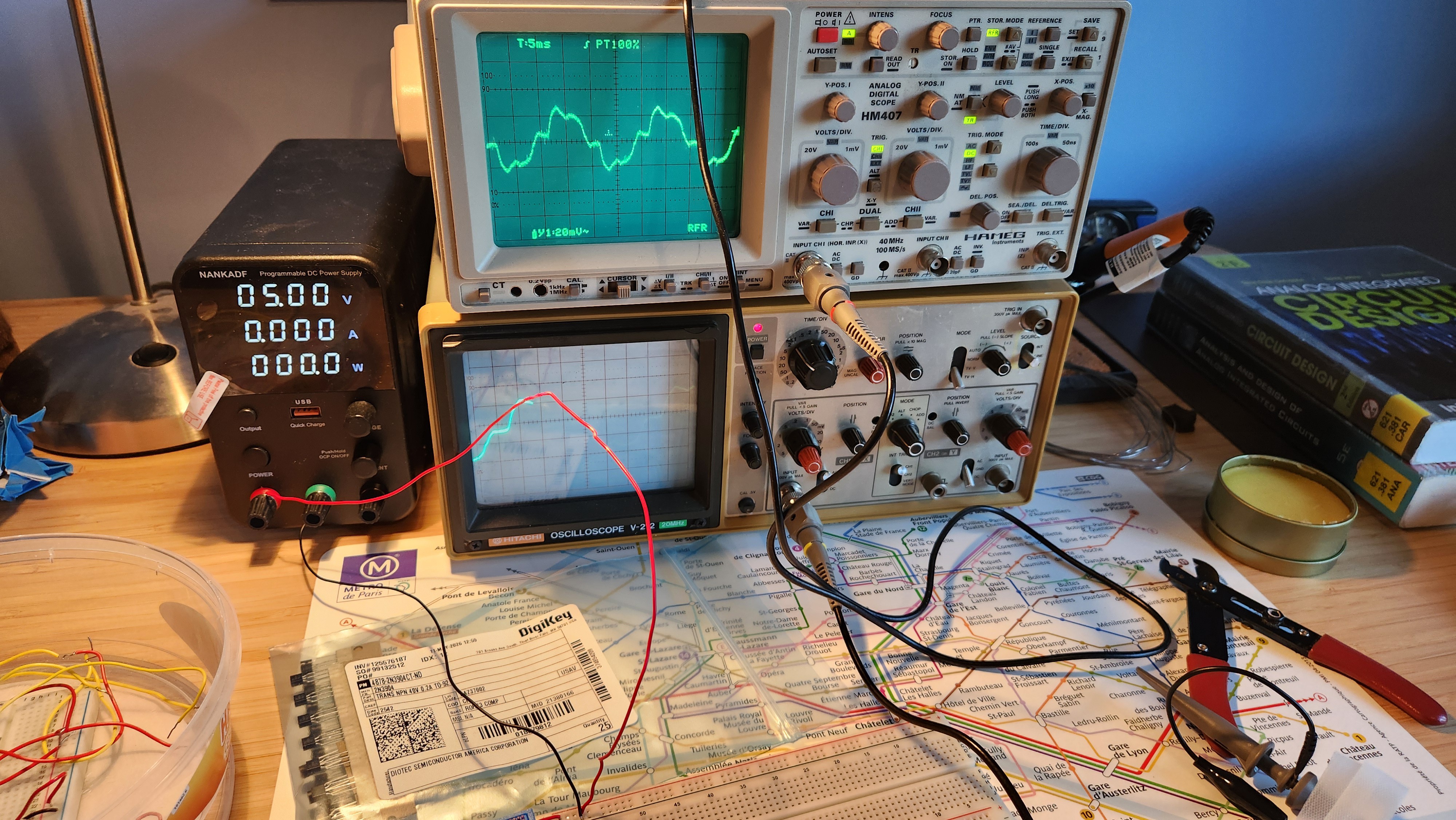

    Earlier this week, I connected up one of my TOGs (Top Octave Generators) to the output of my VCO through a CD40106 buffer. For some reason, I decided that the CD40106 didn't need power or ground at all, and connected the floating output, with no reference from the power supply rails, to my TOG.
    Around 5 seconds after connecting up the TOG, there was a large spark and audible pop as one of my NPN transistors upstream of the digital buffer blew up :(
    This caused a short circuit between power and ground. The power supply entered overcurrent protection mode but it was too late - the huge current had already fried one of my four delicate TOGs and made it unusable. At almost 2000JPY each, they weren't cheap, and with them being vintage replicas I was a little disappointed at this loss. So how did this happen?
    I realised I completely misunderstood what kind of chip the CD40106 actually is. It's not a typical inverter/buffer per se - it's a Schmitt trigger inverter. Schmitt triggers inverters are devices used for converting noisy or erratic analog voltages into cleaner digital ones. They work by latching the output voltage at either +Vcc or GND depending on the input voltage and reversing the polarity of the input. By chaining two inverters together, we can create a digital buffer.
    Schmitt triggers require a +Vcc and GND connection so that the output voltage can latch correctly. If there is no power supply rail, the output voltage becomes floating and behaves erratically, potentially drawing huge amounts of current (which I think is what happened in my case).
    This damage would have been prevented by a quick look at the datasheet, and it's absurd this happened as I'm usually quite careful with this sort of thing. Perhaps I relied on the schematic a little too much, as it doesn't explicitly show the power supply rails. TLDR: Always read...

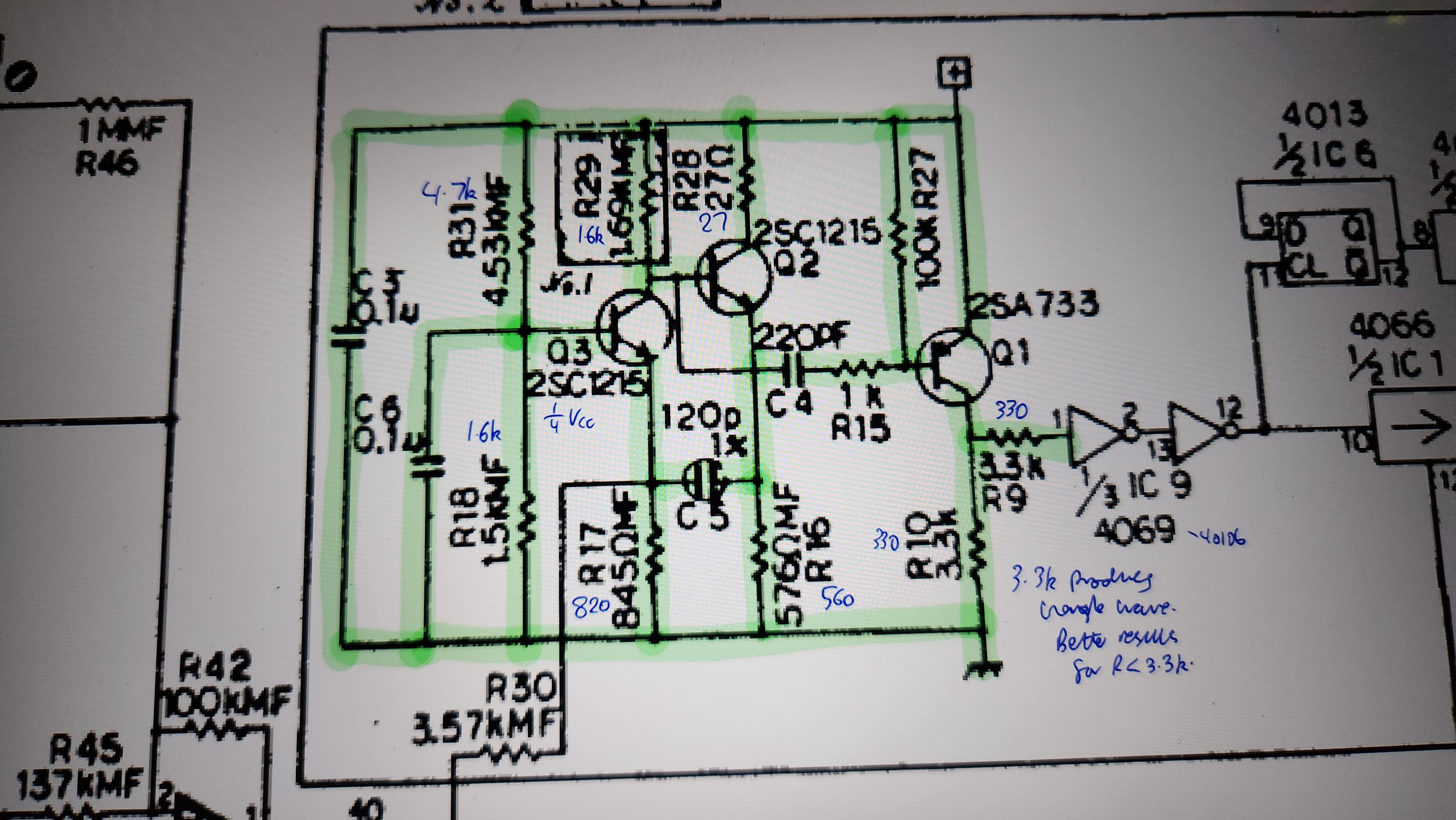

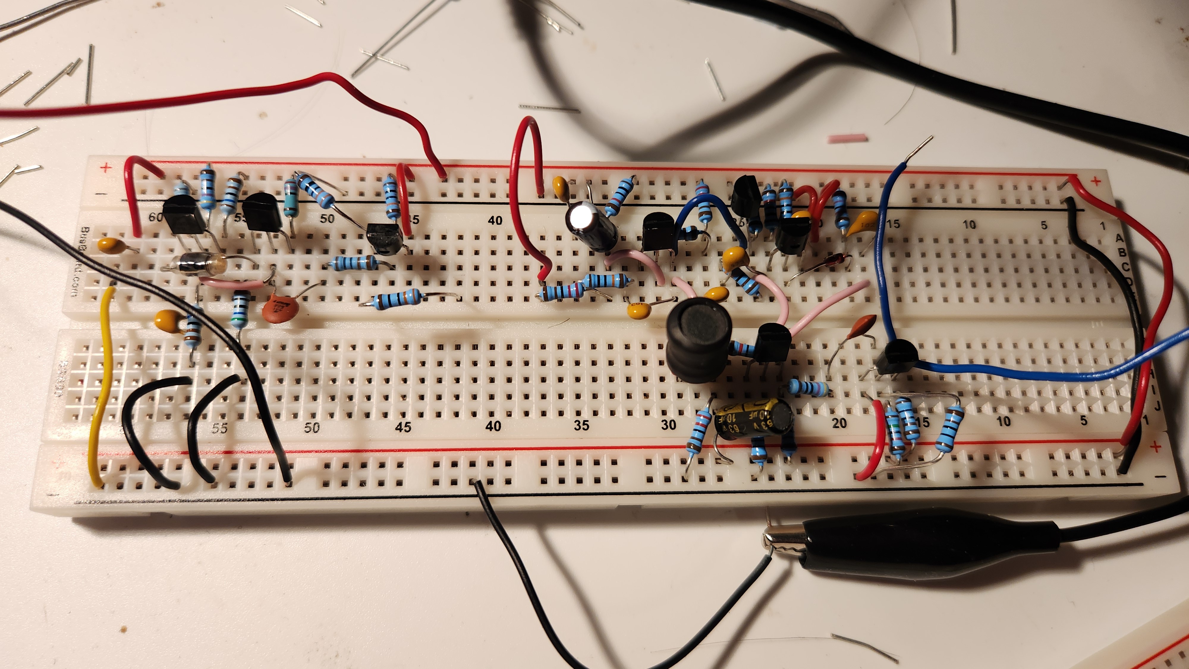

    I've still been able to work for a couple of hours each evening at home, and have been focusing on breadboarding both the Korg Lambda and Roland RS-505 Paraphonic master clock generators, and building up the MIDI to CV converter which will become a significant point of focus over the next few weeks.
    Many pictures this week and less theory :)
    The Lambda master VCO is on the left, and the Paraphonic's is on the right. Notice how many more components are required for the Paraphonic.
    I've found it helpful to store pdf versions of the schematics on my tablet, highlighting as I connect the components. Mistakes are less likely, and it's immediately obvious which parts still need connecting after a break.
    So...which VCO is better?
    My main concern in last week's update was the compromise between the large rise-time caused by the Lambda's first-order feedback, and the possible increased parasitics of the Paraphonic's second-order feedback.
    I had a suspicion that the Paraphonic's master VCO would be better performing, as the Lambda was designed as a budget synthesizer at the time of its release, but also questioned whether first-order feedback could be a better design choice. Over the past week, I've examined both circuits with the oscilloscope to get a real-world comparison, and the results are worth analysing.

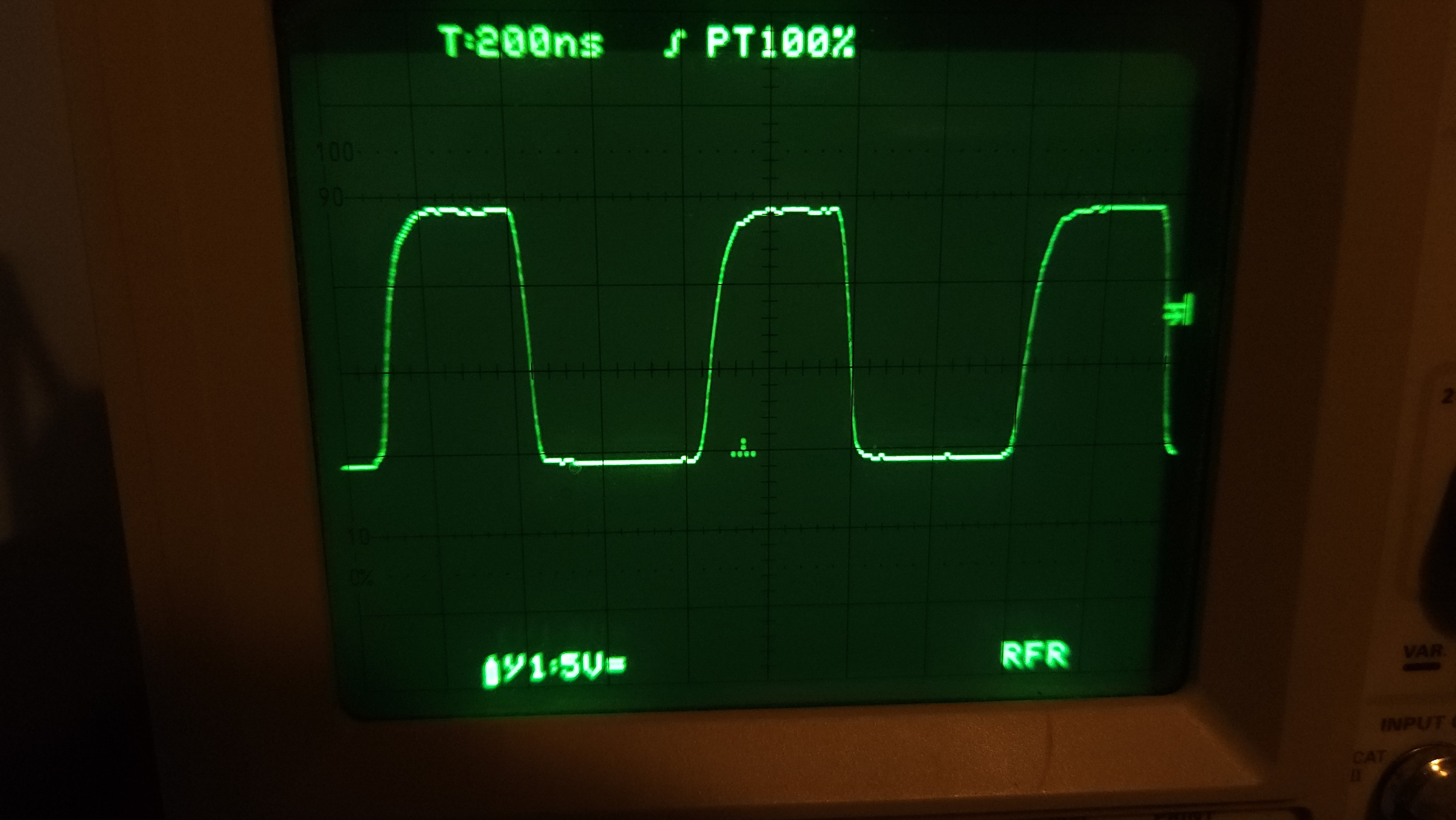

    Output of the Korg Lambda master VCO
    This is the output of the Lambda's master VCO. The first-order charging and discharging of the 120pF capacitor is very obvious on the waveform, and the rise-time is close to our estimate, at around 120ns by inspection. Interestingly, I found that when the output resistors R9/R10 were left at 3.3kΩ, the output appeared more like a low-amplitude triangle wave. Therefore, I decreased R9/R10 by a factor of 10 to 330Ω, increasing the quiescent output voltage of Q1, and this seemed to do the job. I still need to play around with different values of R9/R10 that give the best results.
    This VCO really impressed me with its fantastic frequency stability. Despite having a much less complicated negative feedback than the Paraphonic, the oscillation never varied by more than 8000Hz from its average frequency of 2.420MHz. That's a 0.3% maximum error, with standard deviation 0.2%! To put this into perspective, if the oscillator was tuned to A = 440Hz, then the oscillator's frequency would never go below 438.5Hz or above 441.5Hz. A perceptible difference, but much better than I was expecting, especially for a breadboard and my questionable wiring.
    Undoubtedly a good design; the only thing letting it down is the clock rise time.

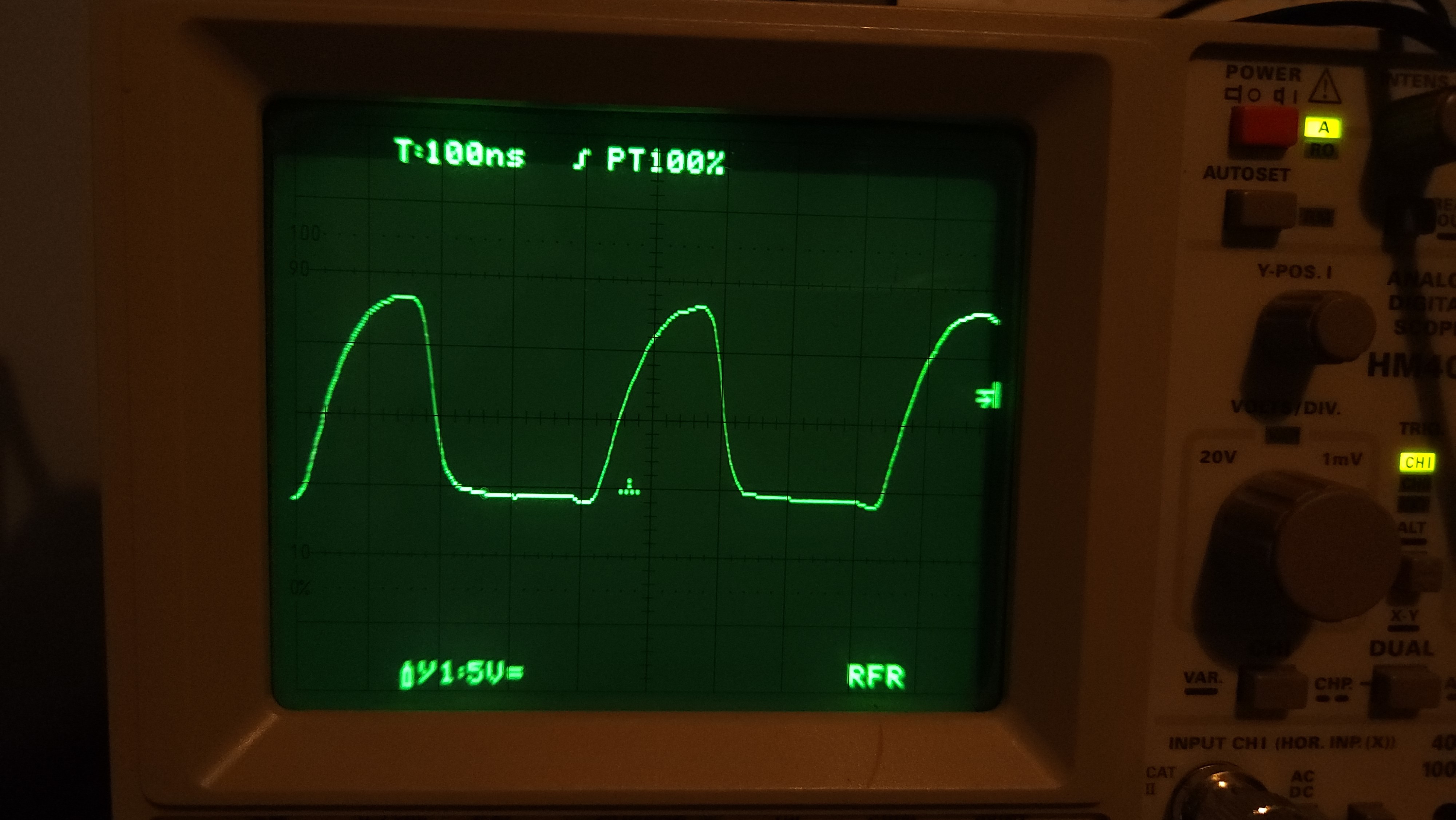

    Output of the Roland Paraphonic master VCO
    ...and here is the Paraphonic's master VCO output. I've supplied it at Vcc = +15V and Vee = 0V for simplicity in this picture, different from the negative power supply rail used in the original design. Everything else is unchanged, except for the lack of a varactor diode used for precise frequency trimming which doesn't really affect the behaviour or stability.
    The rise time is much less than the Lambda, at around 40ns, which makes it more attractive for feeding into the clock dividers of the top-octave generator to follow. If you look closely, the ringing caused by second-order effects is definitely there, but it's very well controlled and small compared to the oscillation amplitude. I made sure to use a film capacitor in the LC tank instead of a ceramic one to try and help with...

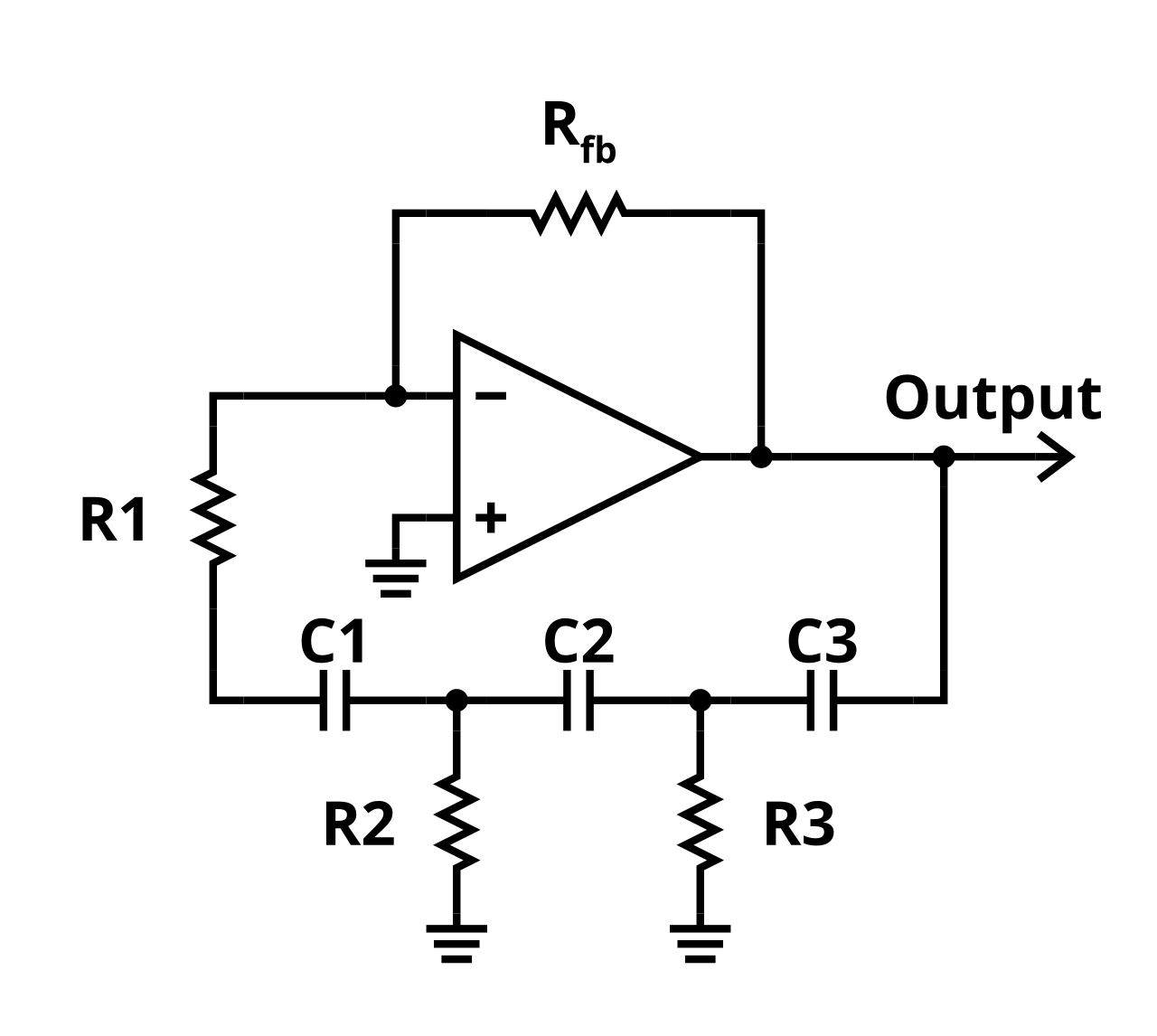

    Relaxation Oscillator Calculator - Stompbox ElectronicsThe relaxation oscillator is one of the most commonly used oscillators for producing square and triangle waves. It takes the form of an op-amp configured as a RC discharge network (R3 and C) which creates a periodic oscillation. The relaxation oscillator is the working principle behind the legendary NE555 timer chip.
    The output of this circuit will be a square wave as the Schmitt trigger flips between its two output states, with the...
