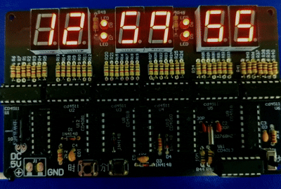

24h to 12h clock Hack
08/16/2025 at 05:26 • 0 comments![]()
I got this clock on AliExpress for ~$4, my 11yo boy put it together and soldered it up with my help.
It worked first try, nice clock.
What I didn't like was the 24h format and the blinking colon LEDs was too bright.

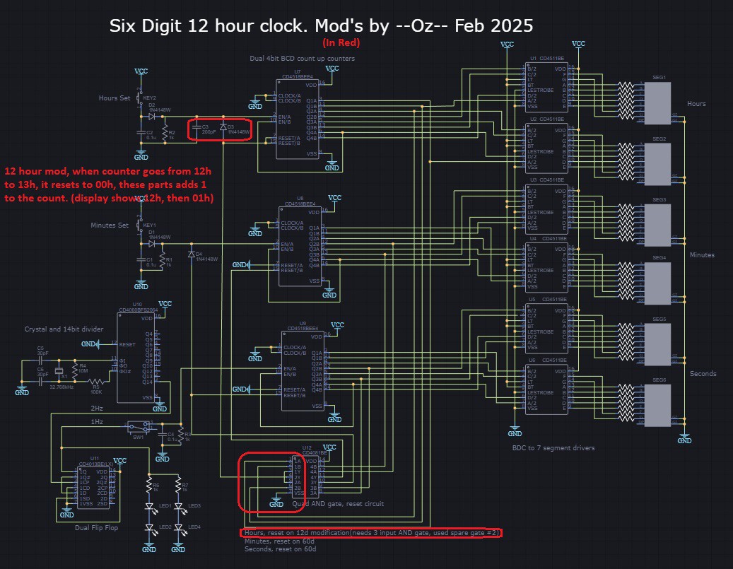

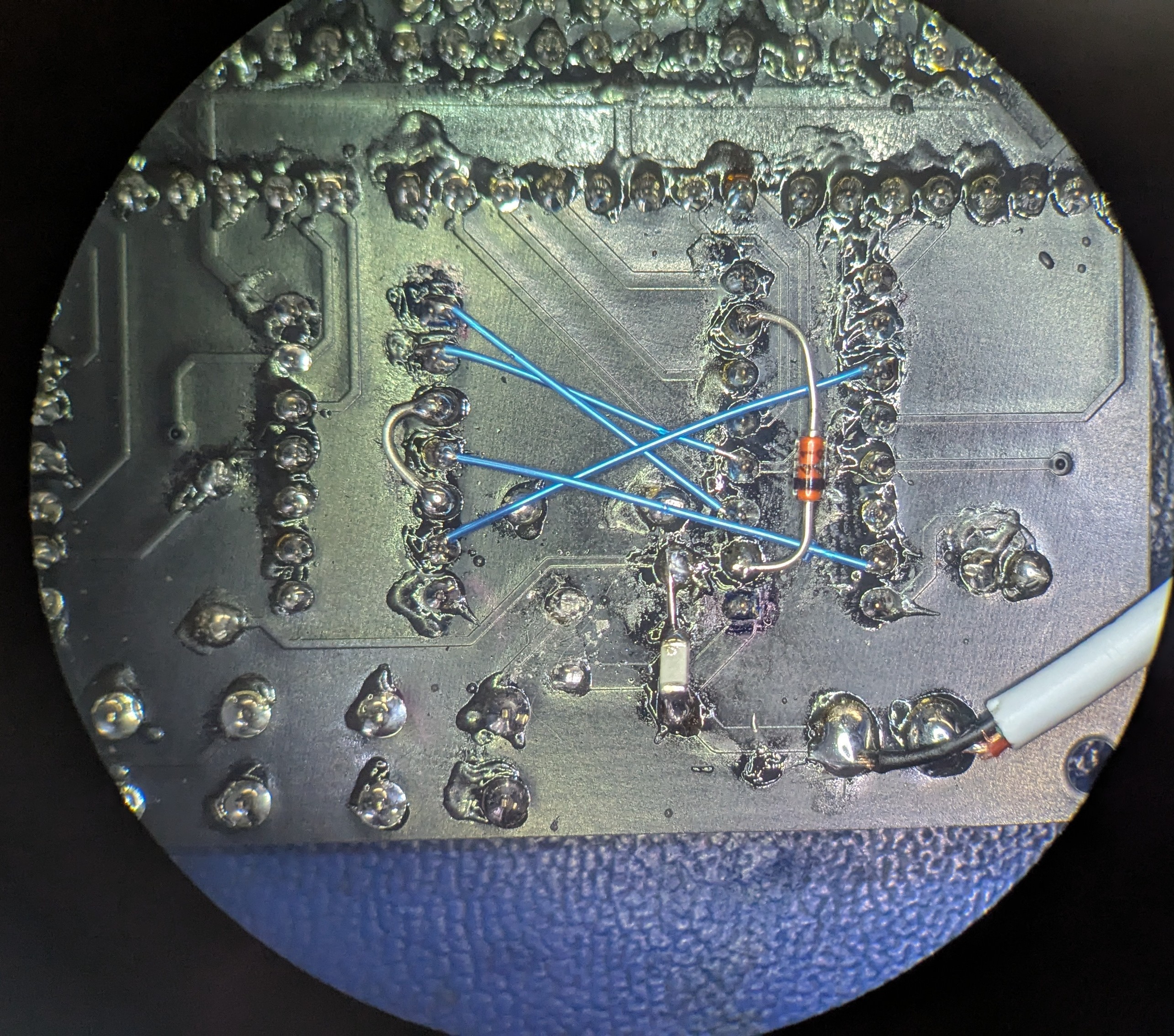

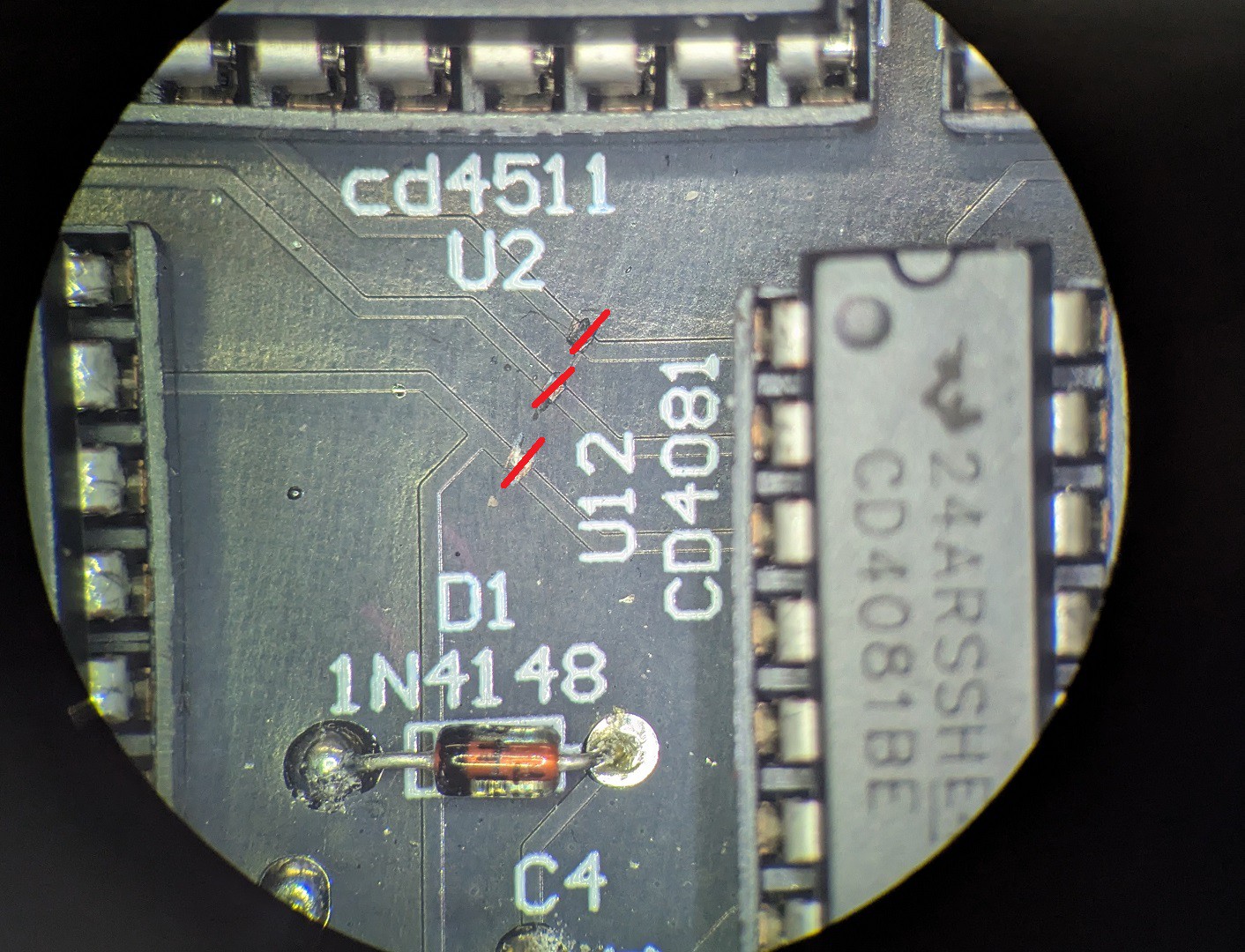

The mod was to cut 3 tracers , add 5 jumper wires, a diode and a cap (220pF), all marked in red in the schematic.
The way I did the 12h hack was to reset the hours when it rolls over to 13h. I needed a 3 input AND gate, and U12 had 2 spare 2 input AND gates, combined = 3 input AND gate. The cuts/jumpers decodes the hours and sends a reset via the diode to the hours counters. I found it was more stable adding a 220pF cap for the reset. You can see the SMD cap on the back of the board below the blue jumpers.
