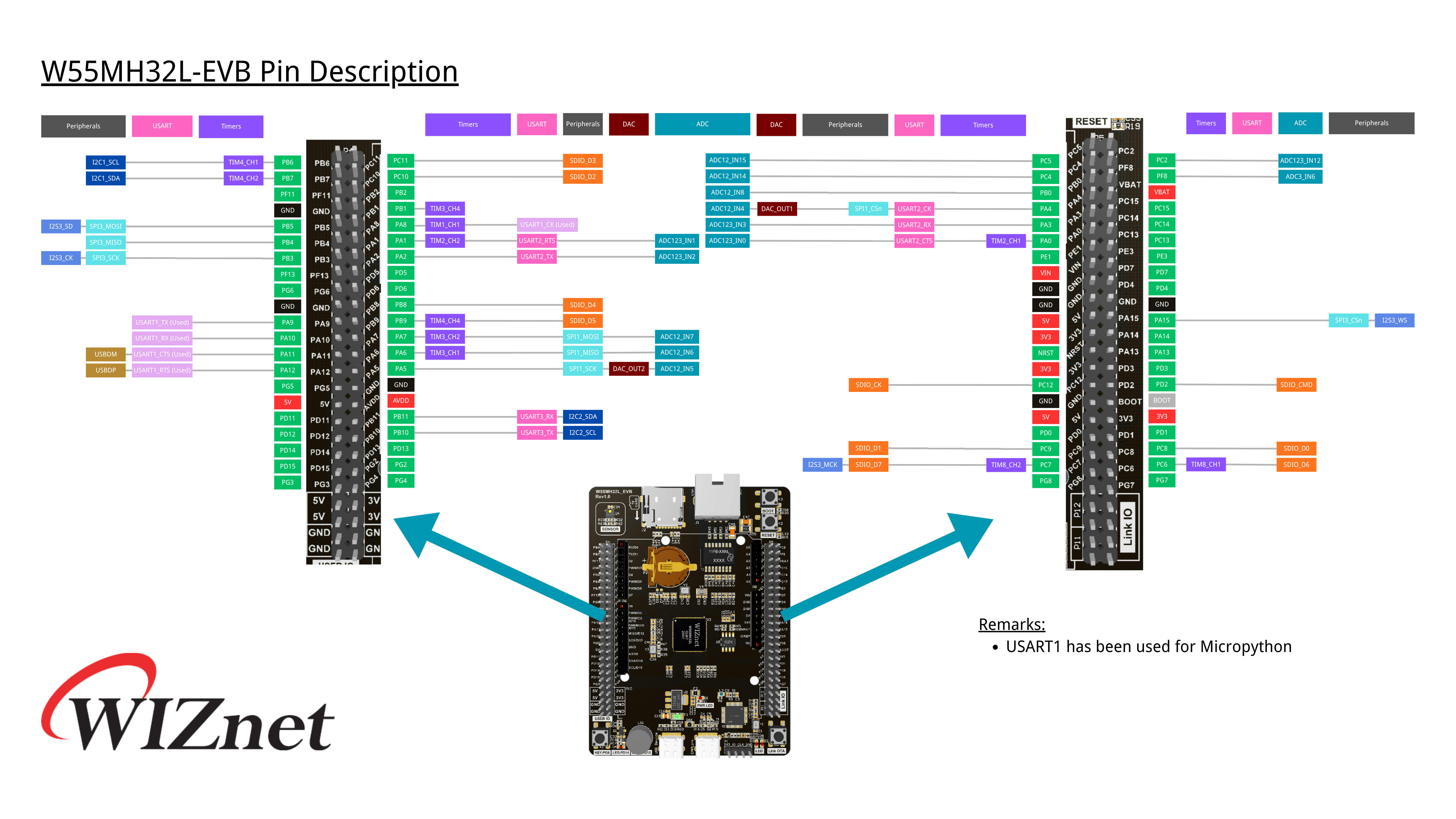

    For this post, I sat down with my W55MH32L-EVB board, a pack of jumper wires, a FT232RL USB to TTL board, a WIZ850io network module and the official pinout diagram to get actual signals moving across physical pins.
    Step 1: Decoding the Pinout Diagram
    The first hurdle when moving from software to hardware is realizing that pins wear multiple hats. Looking at the W55MH32L-EVB pinout, each physical header pin corresponds to a GPIO label (like PA2, PB10, PD14, etc.), but it also lists alternate functions in color-coded boxes (UART, SPI, I2C, ADC, timers).
    A few important observations I made early on:
    • Check the reserved peripherals first: Looking closely at the pinout remarks, USART1 is already dedicated to MicroPython’s REPL / USB bridge. Trying to take over USART1 for external devices will mess with your Thonny interactive console. To talk to external hardware, choose an available spare peripheral like USART2 or USART3.

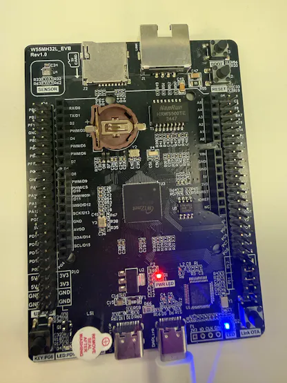

    Accompanying me on this journey is a W55MH32L_EVB board. Browsing the quick reference guide, the first thing that caught my eye was its support for MicroPython. Having standard Python syntax available on bare metal makes the learning curve much friendlier. The board also features an integrated Ethernet port, allowing it to interface directly with local networks or the internet.
    Picture of W55MH32L_EVB Board Connected to Laptop
    Getting started physically was pretty straightforward: I plugged a USB-C cable into the DAP-LINK port to handle power and programming, opened Thonny IDE, pointed the interpreter to generic MicroPython, and had a working session right away. Something interesting I discovered was that MicroPython uses Read-Eval-Print Loop or REPL. It is an interactive programming environment that takes user inputs, executes them, and returns the result immediately.
