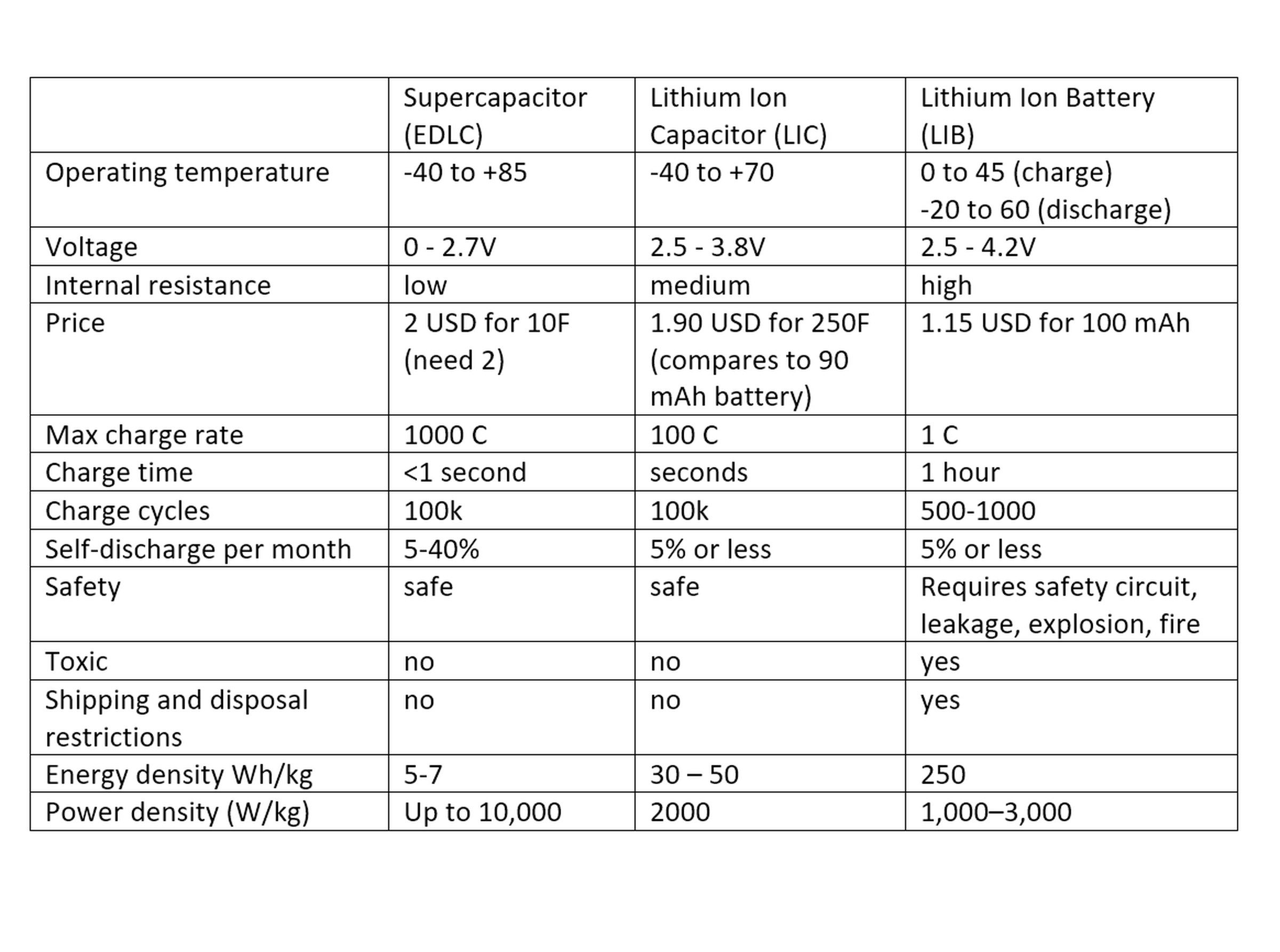

Batteries versus capacitors
I compared Lithium Ion Batteries (LIB) to Lithium Ion Capacitors and supercapacitors. LIBs have highest energy density, but they have limited charging cycles so after few years they wear out like batteries in smartphones. In addition they are dangerous, they need protection circuits to stay safe, they have dangerous chemicals and need to be disposed with chemical waste and they have a narrow temperature range, at freezing temperatures capacity is severely reduced. A classic alternative is a supercapacitor, they have unlimited charge cycles, they don’t degrade but their energy density is 40 times less. Lithium Ion Capacitors (LICs) are new. They are something in between supercapacitors and batteries, they have 6 times higher energy density than supercapacitors but don’t have the disadvantages of batteries. Recently the price has dropped and in qty1000 it is less than 2 euro for a 250F 3.8V Lithium Ion Capacitor. A 250F LIC has the size of an AA battery and the capacity compares to a 90mAh battery, so it is a useful capacitance for a low power sensor application.

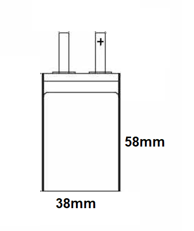

Below picture compares a 250F LIC to a 100F supercapacitor
New developments are LICs of 1200F in 18650 form factor and in pouch formfactor.

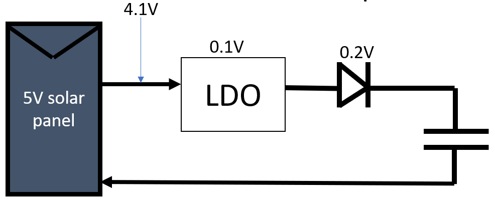

Design of an efficient and cheap linear charging circuit for a 3.8V Lithium Ion Capacitor
We learned that a circuit consisting of a 5V solar panel, a linear charger and a battery is efficient and very economic. Here's the block diagram of such a circuit.
A low quiescent 4V Low Drop Out (LDO) voltage regulatorand a diode charge the LIC to 3.8V. A diode the diode prevents discharging the LIC into the solar panel at night. This circuit is very efficient because of low voltage drop over LDO (0.1V) and diode (0.2V) and because the 5V solar panel operates close to Vmp. A field test at home showed that the circuit also works well under low light condition 100W/m2.
