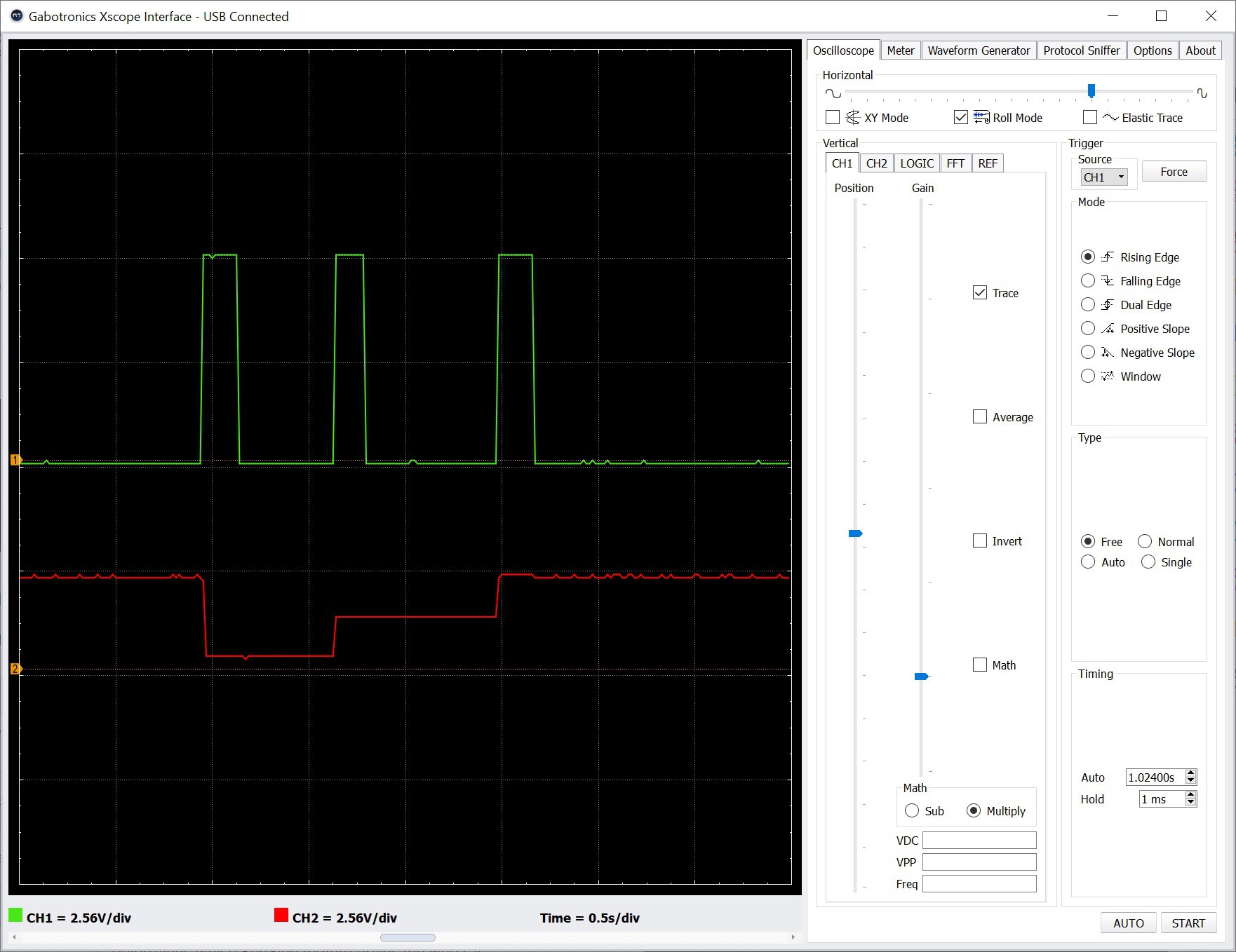

In simple analog synthesis, the controller outputs two waveforms for each note - TRIG and CV.
TRIG (short for trigger), consists of a short pulse that goes high when any note is pressed. Many analog synthesizers contain a circuit called a trigger-to-gate converter, which extends the pulse to the desired duration of the note and shapes the pulse using capacitors, resulting in a desired amplitude profile of a note known as an envelope.
The confusingly named CV (short for control voltage) consists of a DC voltage that represents the pitch of the note. Typically, higher DC voltages represent higher frequencies. Many synthesizers conform to the "1 volt per octave" rule, which states that as the frequency of the note doubles, the DC voltage increases by 1 volt. Incidentally, there are many other types of CV used to control amplifiers and filters for example, hence the confusing name.
Typical waveforms of TRIG (green) and CV (red)

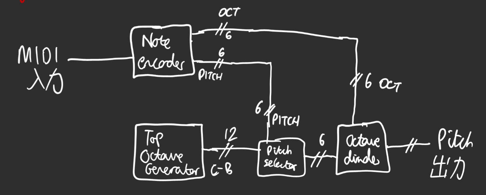

Current controller interface design
This is my current design for a controller interface that takes our MIDI signal input and converts it into a polyphonic pitch output.
- The note encoder takes our input MIDI message and identifies Note On / Note Off events, and outputs 6 pitches (eg. C, D, E, F) and their corresponding octaves (eg. 2, 3, 4, 5) that are played.
- The pitch selector receives the 12 outputs of the TOG and the 6 inputs from the note encoder, and buffers 6 waveforms from the TOG as decided by the note encoder.
- The octave divider takes each of the 6 waveforms sent from the pitch selector and divides their frequency by the required power of 2^n to reach the desired octave.
This is the least hardware-heavy method of implementing polyphony that came to mind. An important design decision was placing the octave dividers after the pitch selector rather than before it, which reduces the number of frequency dividers required from over 70 on a 6-octave keyboard to just six.
The next stage of this project will be to implement some code to achieve this on either a microcontroller or an FPGA.
