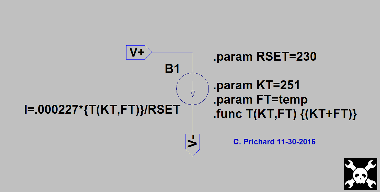

LM334 Macro
12/01/2016 at 20:56 • 0 comments![]()
Status. REVISED. (I CORRECTED the glaring Celsius Fahrenheit screwup.) I created the LM334 macro for special status; inclusions and exemptions untold. Enjoy!
*path @boinerz
.subckt LM334 V+ V-
B1 V+ V- I=.000227*{T(KT,CT)}/RSET
.param KT=273
.param RSET=230
.param CT=temp
.func T(KT,CT) {(KT+CT)}
.backanno
.end
