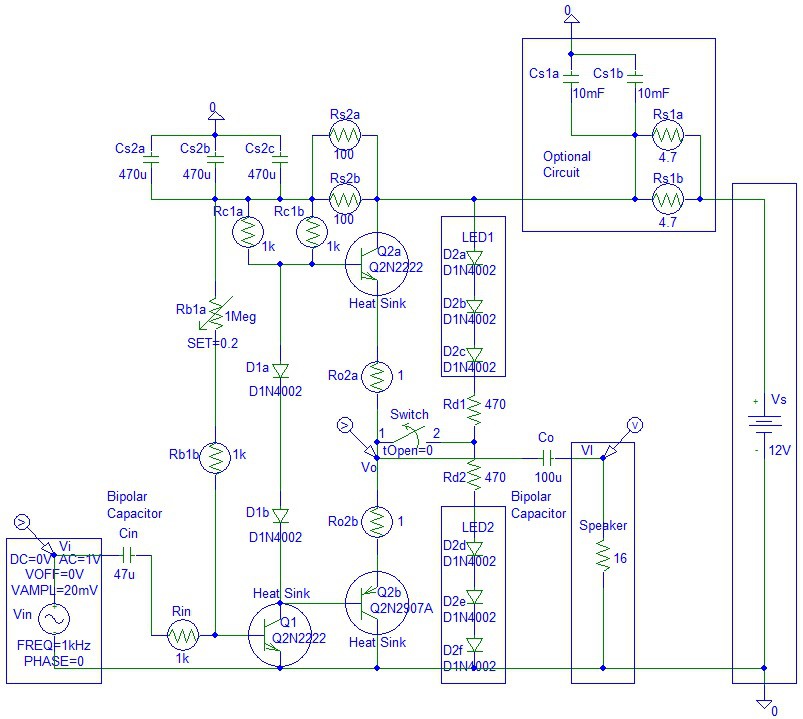

    I have drawn the circuit via PSpice software:
    Figure 2: Design the Circuit.
    The optional capacitor low pass filter circuit is useful when the amplifier is connected to mains powered 8 V power supply. The two 10 mF capacitors are needed to filter the possible 60 Hz or 50 Hz ripple. You do not need this circuit if the amplifier is battery-powered.
    I have chosen two 10,000 uF capacitors for low pass frequency of:
    Flp1 = 1 / (2 * pi * (2 * Cs1a) * (Rs1a / 2))
    = 1 / (2 * pi * (2 * 10 mF) * (4.7 ohms / 2))
    = 3.3863 Hz
    The maximum current across the Cs1a and Cs1b capacitors is when the voltage across the capacitors is zero:
    IcsMax = Vs / (Rs1a / 2) / 2
    (divide by 2 because there are two capacitors)
    The maximum voltage is 12 V.
    = 12 V / (4.7 ohms / 2) / 2
    = 2.5532 Amps
    The maximum power is at half supply voltage:
    PcsMax = VcsHalfSupply * IcsHalfSupply / 2
    = (Vs / 2) * ((Vs / 2) / (Rs1a / 2)) / 2
    = 7.6596 Watts
    Calculate the low pass frequency of the second power supply low pass filter:
    Flp2 = 1 / (2 * pi * (3 * Cs2a) * (Rs2a / 2))
    = 1 / (2 * pi * (3 * 470 uF) * (100 ohms / 2))
    = 2.2575 Hz
    The average current across the LEDs equals to:
    Iled = (Vs - 2 * Vled) / (Rd1 + Rd2)
     = (12 V - 2 * 2 V) / (470 ohms + 470 ohms)
    = 8 V / 940
    = 8.5106 mA
    The maximum current across the LED is equal to:
    Iled = (Vs - Vled - Vbe) / Rd1
    = (12 V - 2 V - 0.7 V) / 470 ohms
    = 19.7872 mA
    The 1 Meg potentiometer allows a clipping sound effect.

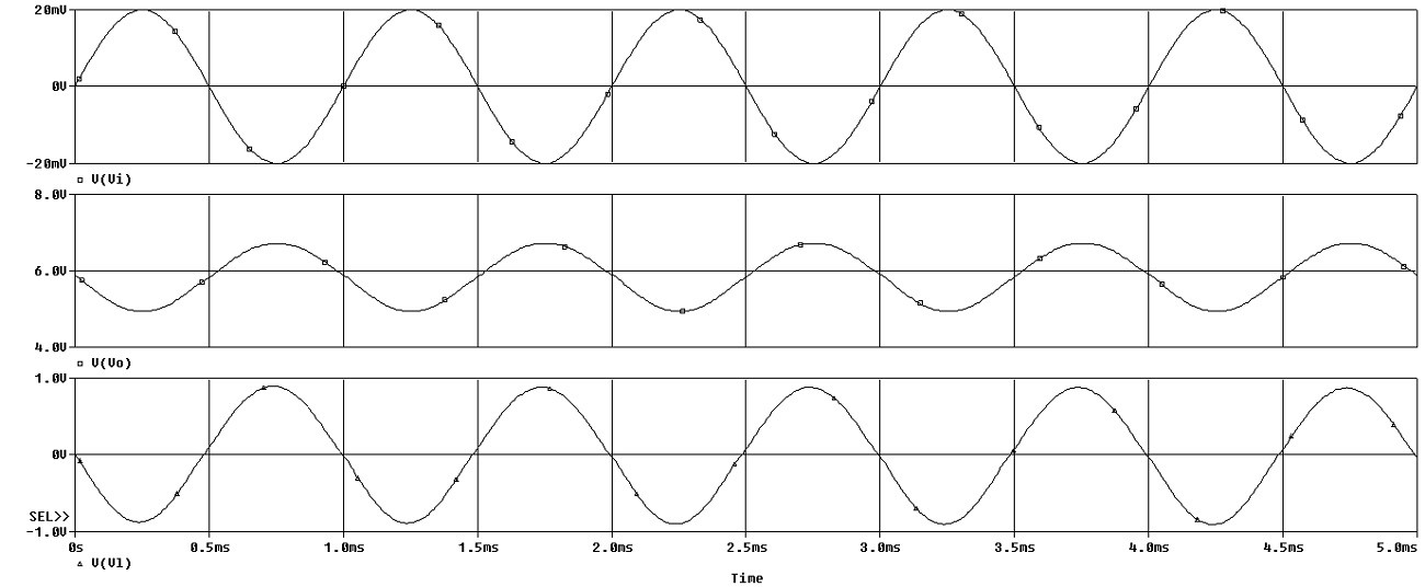

    Step 2: Simulations
    Time Domain:
    Figure 3: Simulations Transient.

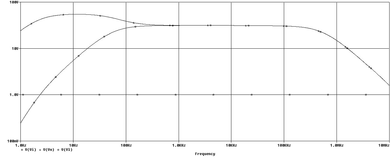

    Frequency:
    Figure 4: Simulations Frequency.

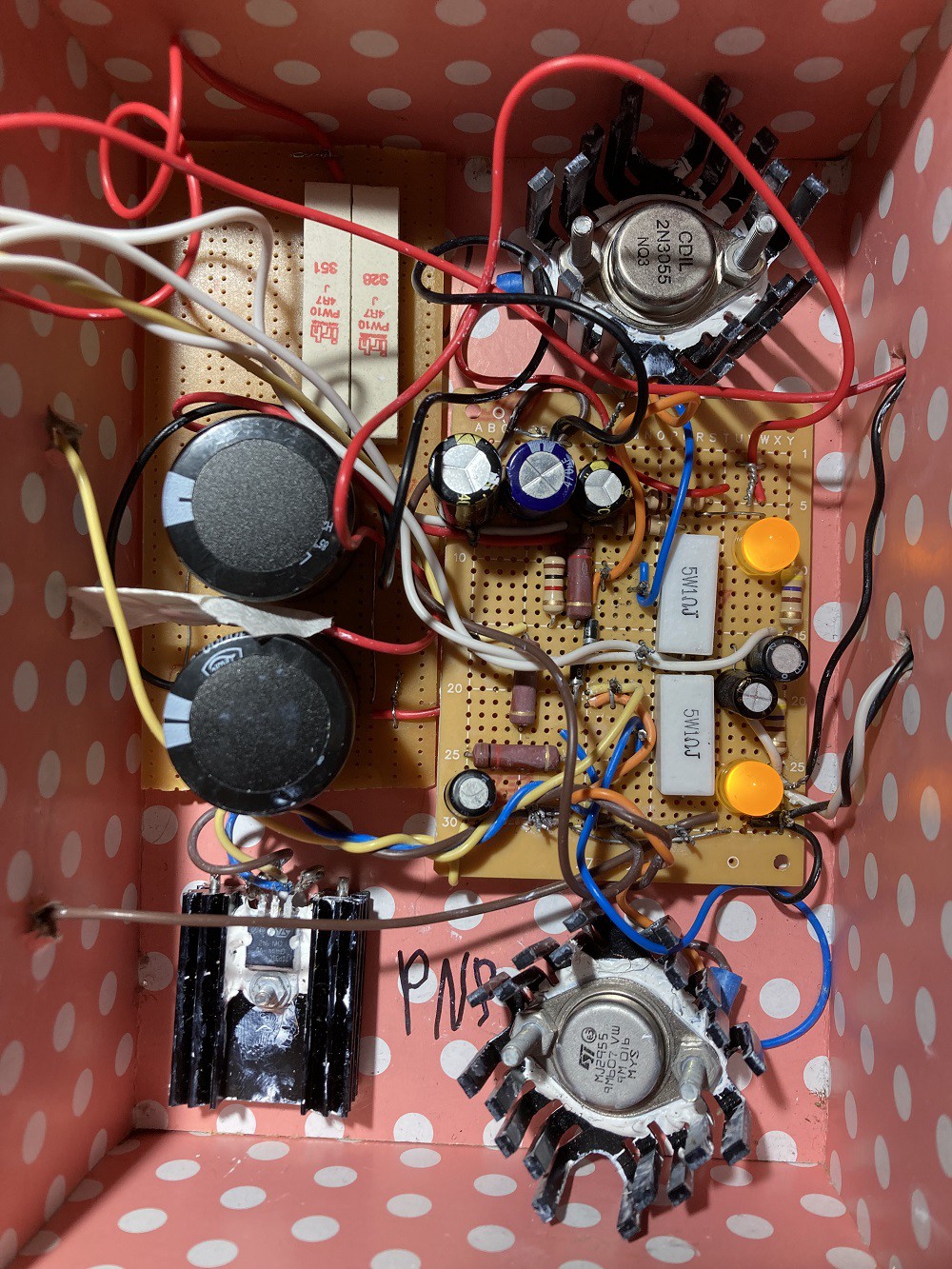

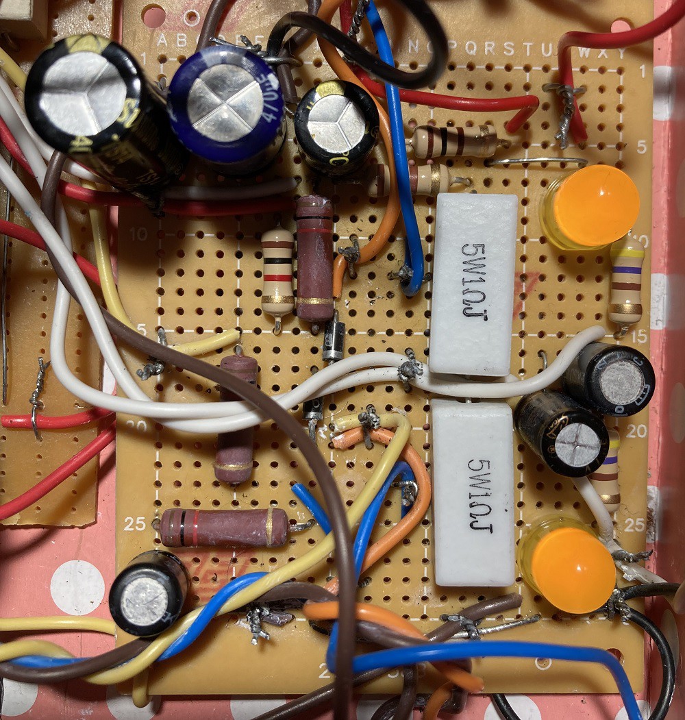

    Step 3: Make the Circuit
    I made the circuit on a small matrix board:
    Figure 5: Make the Circuit.

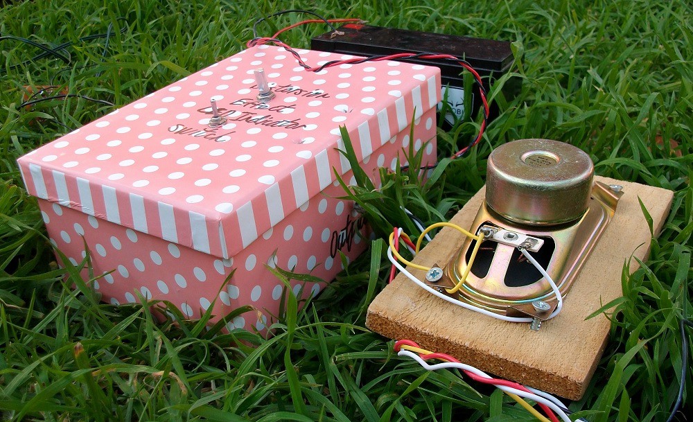

    Step 4: Encasement
    I used a cheap $2 gift box to save money:
    Figure 6: Encasement.
    I used big 10 mF capacitors and 10-watt 4.7 ohms resistors because I connected the circuit to a 12 V battery.

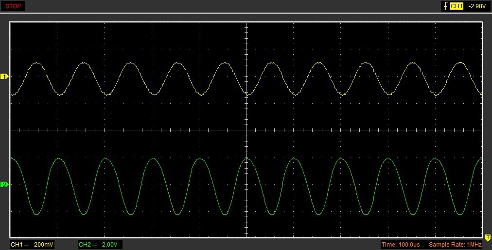

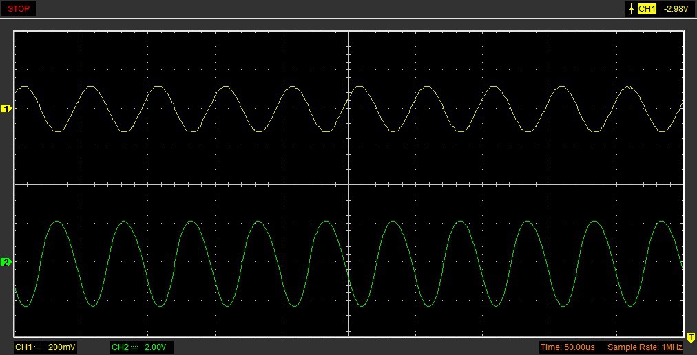

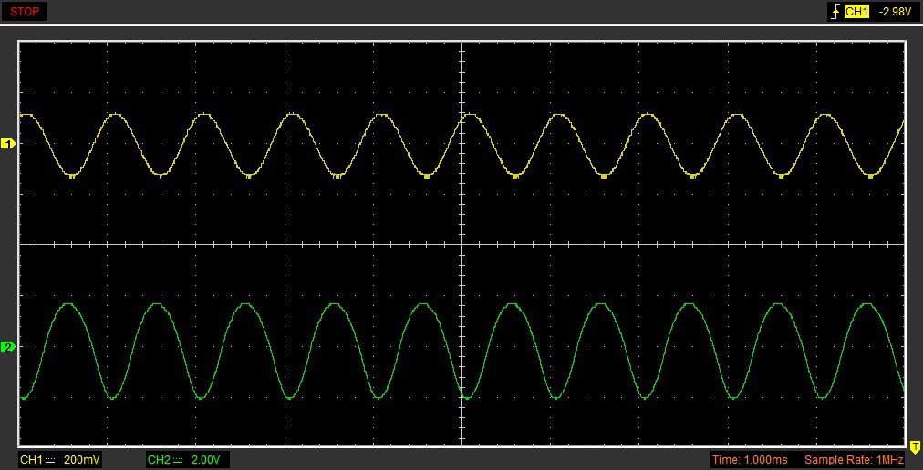

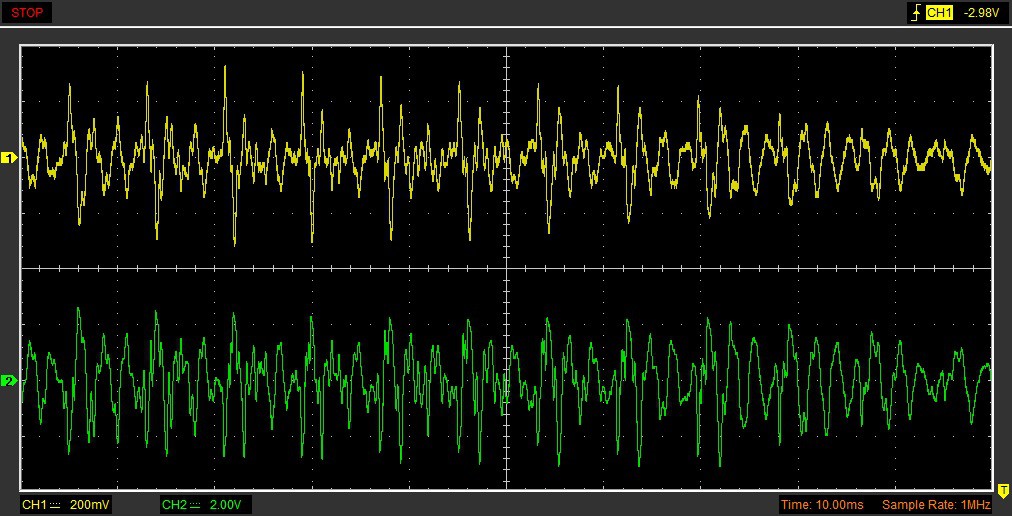

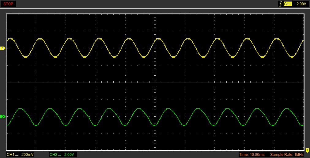

    Step 5: Testing
    I used a Hantek 6022BE USB Oscilloscope to test my circuit.
    The yellow plot is the input and the green plot is the output.
    Figure 7: Testing 100 Hz Sine Wave Input.
    Figure 8: Testing 1 kHz Sine Wave Input.
    Figure 9: Testing 10 kHz Sine Wave Input.
    Figure 10: Testing 20 kHz Sine Wave Input.
    Figure 11: Testing Voice Input.

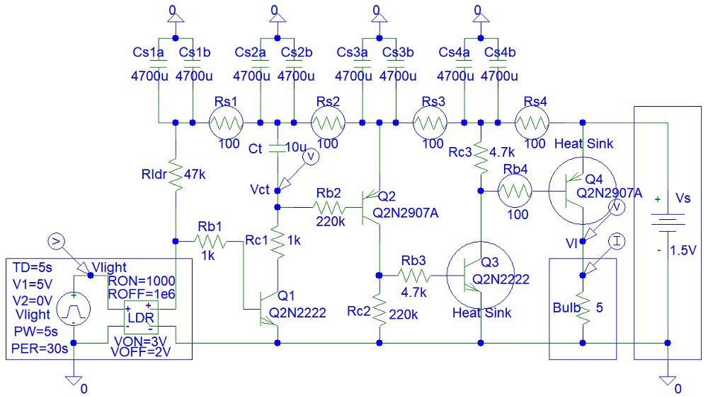

    I have drawn the circuit in PSpice simulation software, student edition version 9.1:
    The Vlight pulse waveform represents the presence of light in the room (5 V when lights are ON and 0 V in darkness, when lights are OFF). The LDR (Light Dependent Resistor) voltage-controlled switch changes resistance from 1 kohm to 1 Megohm when the lights are turned OFF.
    I used Rldr as high as 47k to ensure that the light bulb remains off and stays off unless the sensor is exposed to complete darkness. This is to prevent wasting battery power. However, the Rldr resistor is low enough to ensure that the Ct capacitor charges very quickly when the lights are OFF. I used a big light-dependent resistor that has a small resistance, thus allowing me to use a relatively small Rldr value. This is why I did not use a cheap photodiode.
    The switching action of LDR propagates through the four transistors from Q1 to Q4 to turn ON the light bulb. I connected Rc2 and Rc3 to ensure that the transistors are not disconnected when the light bulb is OFF.
    By making a few approximations, we can estimate the minimum required current gains (Beta parameters) for each transistor for the circuit to work:
    Beta4 = Ibulb / ((Vs - Vbe4 - Vcesat3) / Rb4)
    Beta3 = ((Vs - Vbe4 - Vcesat3) / Rb4) / ((Vs - Vbe3 - Vcesat2) / Rb3)
    Beta2 = ((Vs - Vbe3 - Vcesat2) / Rb3) / ((Vs - Vbe2 - Vcesat1) / Rb2)
    Beta1 = ((Vs - Vbe2 - Vcesat1) / Rb2) / ((Vs - Vbe1) / Rldr);
    We enter the equations into the Matlab file:
    clear all;close all
    Ibulb=0.3;
    Vs=1.5;
    Rb4=100;
    Rb3=4700;
    Rb2=220000;
    Rldr=47000;
    Vbe1=0.7;
    Vbe2=0.7;
    Vbe3=0.7;
    Vbe4=0.7;
    Vcesat1=0.2;
    Vcesat2=0.2;
    Vcesat3=0.2;
    Beta4 = Ibulb / ((Vs - Vbe4 - Vcesat3) / Rb4);
    disp(['Beta4 = ' num2str(Beta4)])
    Beta3 = ((Vs-Vbe4-Vcesat3)/Rb4)/((Vs-Vbe3-Vcesat2)/Rb3);
    disp(['Beta3 = ' num2str(Beta3)])
    Beta2 = ((Vs-Vbe3-Vcesat2)/Rb3)/((Vs-Vbe2-Vcesat1)/Rb2);
    disp(['Beta2 = ' num2str(Beta2)])
    Beta1 = ((Vs-Vbe2-Vcesat1)/Rb2)/((Vs-Vbe1)/Rldr);
    disp(['Beta1 = ' num2str(Beta1)])
    If you do not want to pay for Matlab you can use the free Octave software to obtain the following output:
    Beta4 = 50
    Beta3 = 47
    Beta2 = 46.8085
    Beta1 = 0.16023
    The required current gain (Beta value) for Q1 is very small.
    Q3 and Q4 should be power transistors. I used PSpice student edition simulation software, which does not include power transistor components.
    The circuit I designed is capable of driving high-current light bulbs. You can use fewer transistors when connecting a bright LED instead of a light bulb because LEDs consume less current than light bulbs. However, the LED will need at least 2 V to work, unlike the light bulb that needs only 1.5 V.
    I modelled the light bulb as a 5 ohm resistor because the current across the light bulb is 0.3 Amps. 1.5 V / 0.3 Amps = 5 ohms.
    The big 4,700 uF capacitors are used to prevent power supply oscillations due to power supply surges that occur when the light bulb is turned ON or OFF.

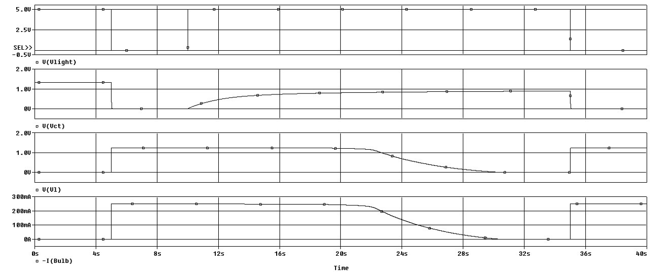

    Step 2: Simulations
    Simulations show that the light bulb turns ON very quickly after the lights are turned OFF and remains fully ON for about 15 seconds after the lights are ON.

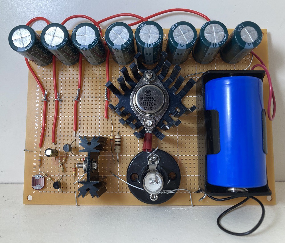

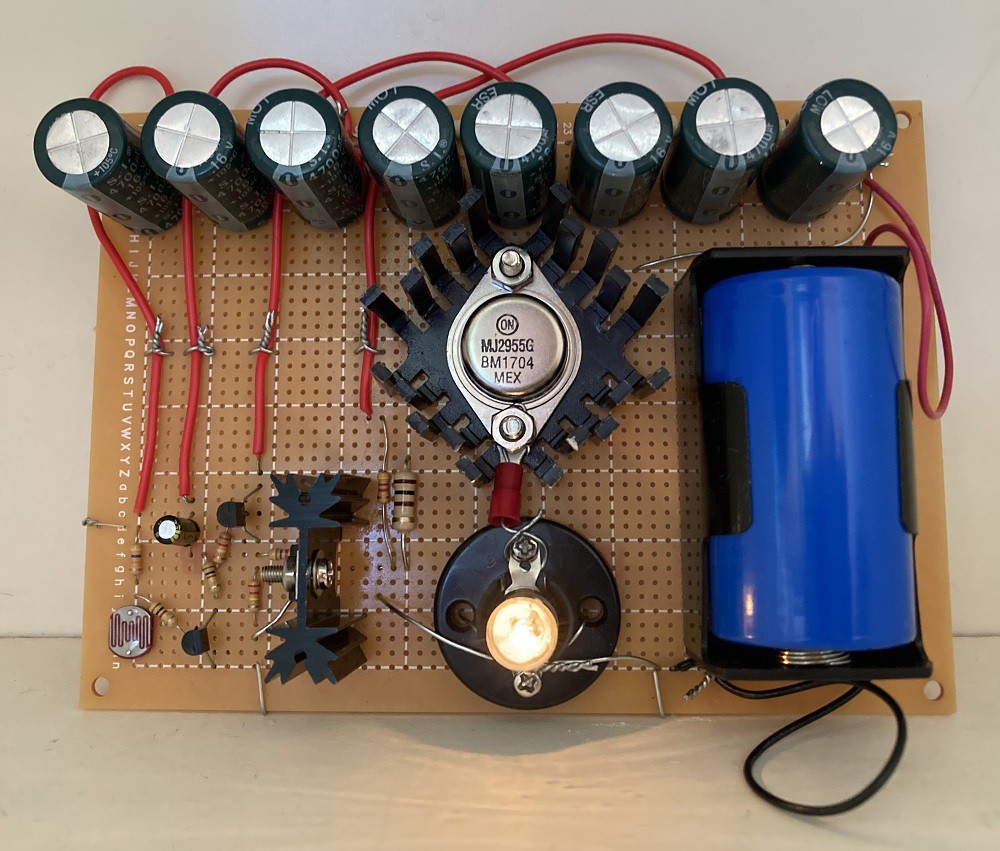

    I soldered the components with lead-free solder and with the use of a 60 W soldering iron:
    Step 4: Testing
    I tried testing the response of the LDR sensor by putting my hand on top of the sensor.
