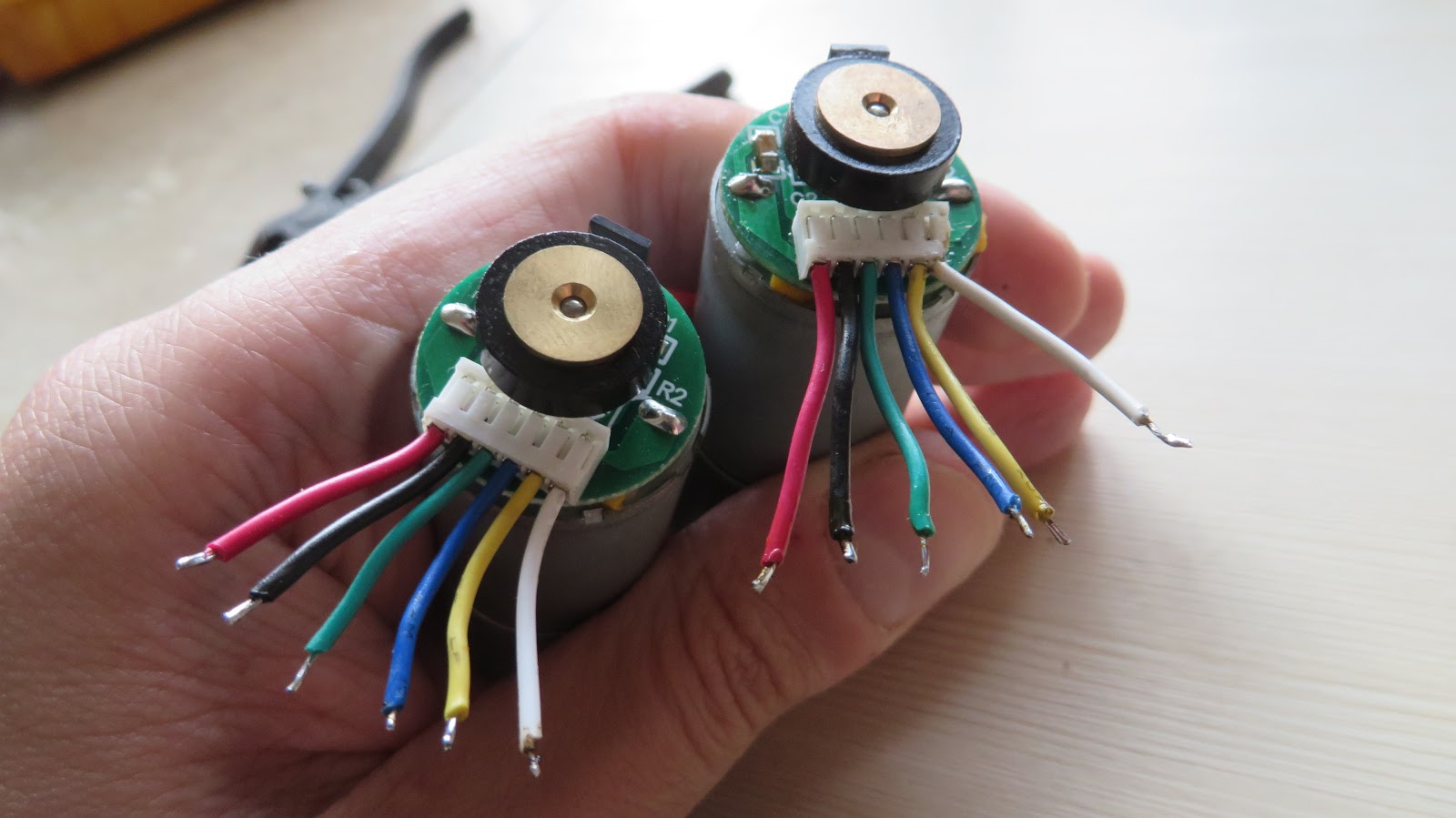

    Electronics: replacing motor's wires, fitting them with connectors that match distribution board.
    The wire that comes with motors was way too short, so I replaced it with the longer one, replacing the flimsy 6-pin connector with separate connector for power (motor wires) and signals (encoder wires).
    • Crop off the existing wires first. To see which color corresponds to which wire, see table on motor's product page.
    • We are going to separate signal and power lines on this motor. This

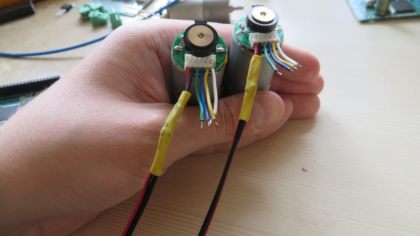

    is actually the best practice in electronics engineering because it minimizes crosstalk between them. Solder a longer wire to red and black wires and insulate them with heat shrink.
    • Let's lengthen the encoder's wires now. There's 4 wires total, 2 of
    them signal and 2 power wires. Now, which insanely popular cable fits the bill? USB - everyone these days has at least one in their house! Butcher any cable you don't want for perfect pieces of 4-wire cable.

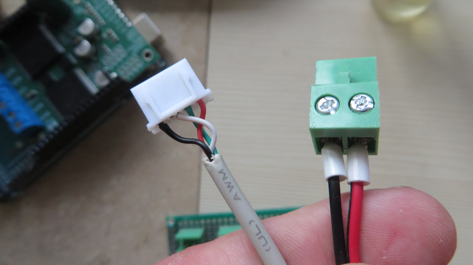

    • The opposite ends of motor's cables will need wire-to-board connectors.
    That's what the result should look like:
