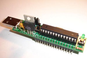

    code for arduino
    #include
    CustomSoftwareSerial* customSerial;
    void setup() {
    Serial.begin(19200);
    while (!Serial) {
    Serial.write("Mendooo Electronics");
    customSerial = new CustomSoftwareSerial(11, 10); // rx, tx
    customSerial->begin(19200, CSERIAL_7O1);
    void loop() {
    if (customSerial->available())
    Serial.write(customSerial->read());
    if (Serial.available())
    customSerial->write(Serial.read());
