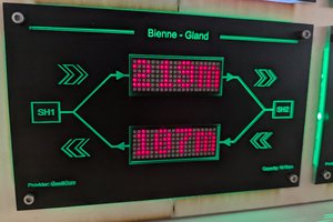

Step 2: Electronic Design
Serial Peripheral Interface(SPI) is an interface bus commonly used to send data between microcontrollers and small peripherals such as displays & sensors. It uses separate clock and data lines, along with a chip select line to choose the device you wish to talk to. The LED Matrix Display is connected to the Raspberry Pi's SPI pins.
| Raspberry Pi 3B | LED Matrix Display |
| 5V | VCC |
| GND | GND |
GPIO 10 (MOSI) | DIN |
GPIO 8 (SPI CE0) | CS |
GPIO 11 (SPI CLK) | CLK |

Step 4: Mechanical Assembly
Bitcoin Bar's enclosure consists of an interlocking box which is laser cut from 5mm MDF. The Front Panel has two slots: one for the LED Display & the other for the Acrylic Diffuser. The Back Panel has a hole for the power supplies USB cable which is plugged into the Raspberry Pi. The Bottom Panel has 4 holes to which the Raspberry Pi is mounted too.
You can find the laser cutting files (for both MDF & Acrylic) below or in the link: Bitcoin Tracker: Laser Cutting
