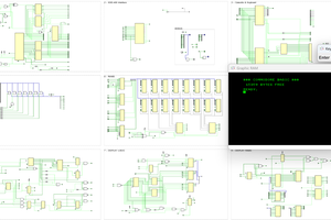

So how simple it could be to generate color NTSC composite? Look at the schematic below.
The external oscillator is required to have a stable and precise chroma reference signal. The chosen one run at 8 times the chroma frequency. As PIC core divide the clock signal by 4. The CPU is running at 2 times the chroma frequency. This simple circuit can generate 6 colors.
| colors | chroma output | video_y output |
| black | hi-z | hi-z |
| white | hi-z | Vdd |
| yellow | phase:180° | Vdd |
| mauve | phase:0° | Vdd |
| blue | phase:0° | hi-z |
| dark green | phase:180° | hi-z |
The dark-green color is almost unusable as it is too close to black. It require a TV with a good contrast. So I didn't used it in the game.
