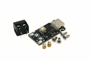

Prototype 1A:
Simple Constant voltage
Power SupplyVariable from
0.6V to 12V.
Will Include 5V and 3V Rails.
Voltage indicator will be
achieved using comparators and
LED Array.
This was chosen to reduce
cost as much as possible and
keep each board with
components under $2.75.
Status
(COMPLETED)
    BOM (LINK)
Schematic (LINK)
Gerber Files (LINK)
Prototype 1a: Rendering
Prototype 1a: Assembled
Voltage Test
Voltage Test
Load Sharing and Quick disconnect Test
Load Sharing / Uninterruptible Test

Dan Maloney wrote 09/18/2019 at 15:26 • point
I see what you mean about the silk screen. Not bad, but not stunning, which it should be.
Looking forward to more progress on this. Keep up the good work.
John Loeffler wrote 09/18/2019 at 15:34 • point
Yes and some of the Pads do not have soldermask in between I was only able to get 1 board of 3 working.  From now on I will be using JLBPCB which came back fantastic.
Dan Maloney wrote 09/18/2019 at 15:38 • point
Cool. Just keep the black on white - that's a really good look. Although I did recently see OSHPark offer some cool dark designs.
John Loeffler wrote 09/18/2019 at 15:43 • point
I saw that,  A transparent Soldermask that lets you see the copper traces.  This is perfect for finding the errors in my boards.
John Loeffler wrote 09/18/2019 at 15:48 • point
And you have to admit that is the perfect logo for this project
