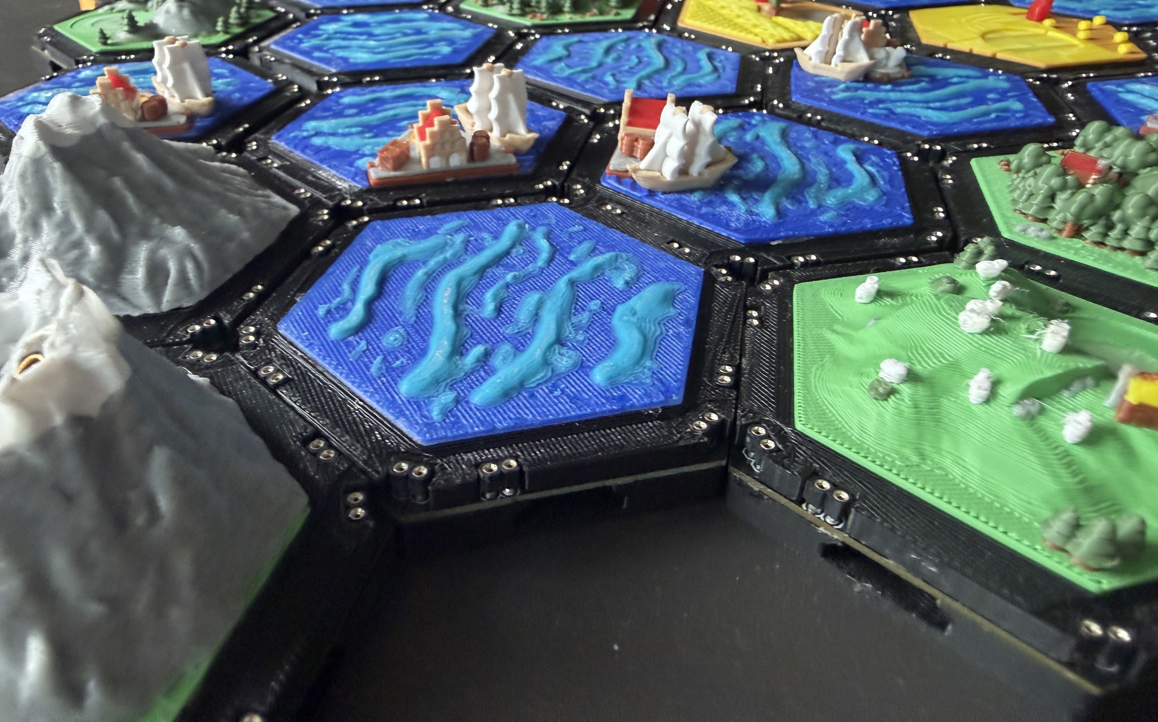

Hello everybody, i loved to play the Catan Board game when i was a child and still love it today. So i decided to create a digital AND 3D printed version. Im not able to create good looking 3D models so i picked them from thingiverse.com Thanks here to Dakanzla how created wounderfull tiles. (https://www.thingiverse.com/thing:2525047)
Okay the tiles are downloaded and ready to print. Next i startet thinking about what i really did want.
1. Ambient light (Vulcano with fire)
2. Dynamic Board like the Original
3. Individual Player Color
To do this i started to create the first Version form the tiles with EAGLE. I googled some thinks and had another great idea that it would be great to illumnate the numbers when they are rolled.  So i added a mfs522 RFID modul and put the circuit from the Keys in my numbers. Then i startet to order the PCB from jlbpcb.com.

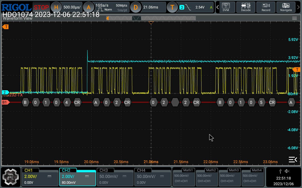

    I also worked on the data protocol in general and made it much faster. The old version had a noticeable delay, you rolled the dice and had to wait until the board reacts. Now there is nearly no time delay anymore, it feels like the board answers directly. Unlike on the picture, it has now a little bit of extra error detection.

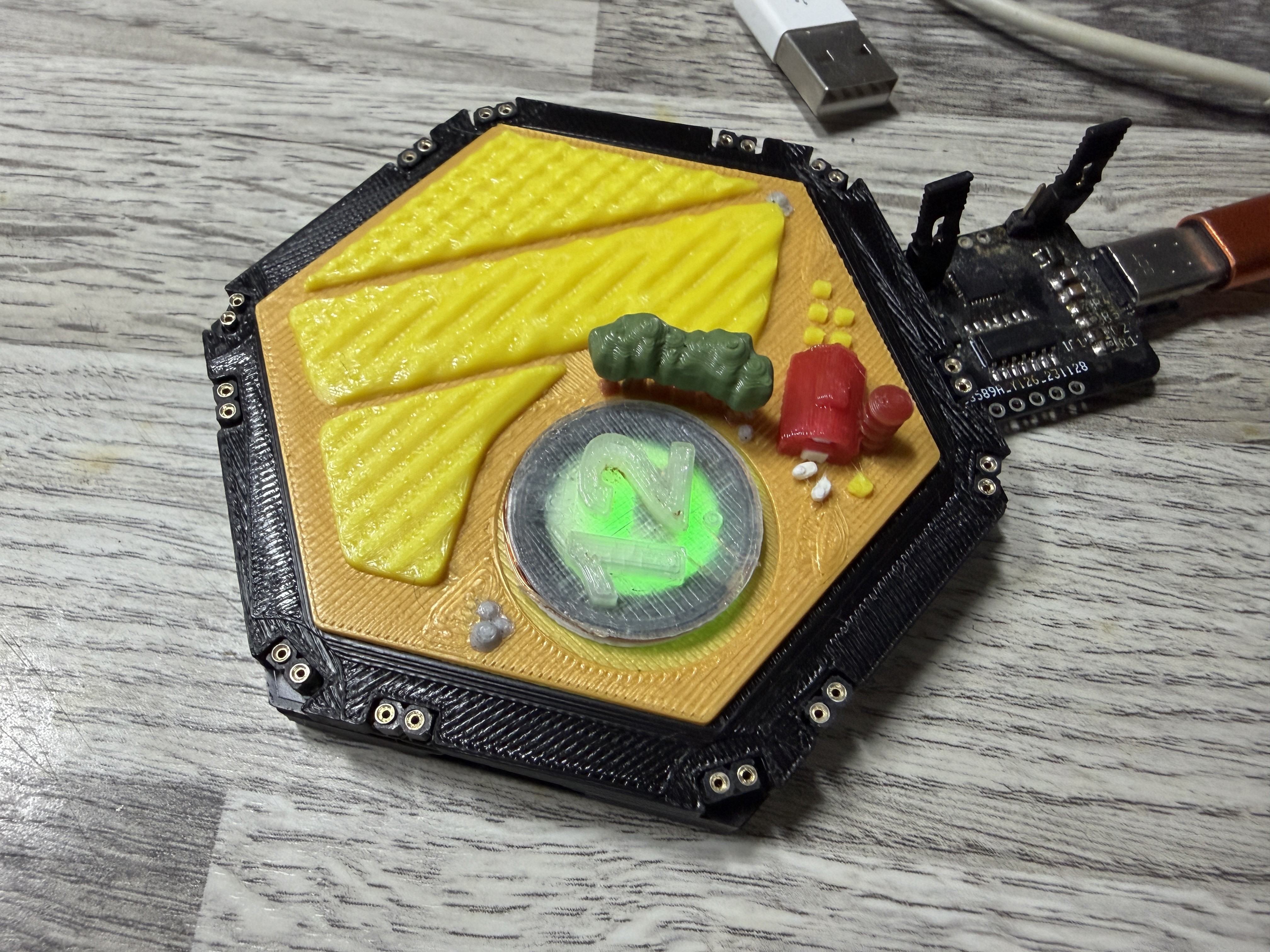

    Client Tile
    First of all i changed some in the PCB and schematic for every tile. They got an step down regulator and a linear hall sensor, i hope to get better results in detecting the Robber on top of the tile.  To drive the Tiles safe and without any problems in voltage drop i used a step down regulator so they can handle 12V. This step was necessary the voltage drop over all 55 Tiles is damn high. The typical  current at 5V was between 120mA to 200mA, so again the expected supply current was near to 11A.
    Master Tile
    Its alive, the first version from Master has opened his eyes. It‘s a single tile that will Control the hole game and the communication between all periphery. It‘s brain is an Atmega 1284,  there is a DS3132 Realtime Clock, a 4MB I²C EEPROM , a HM19 Bluetooth Modul and a 2.4 Ghz Wirless Modul (not Wifi).
    The DS3132 is used to get a time for logging some data and control and maybe for future use. The EEPROM is used to store some game Data, statistics and logging in development process.
    To connect the periphery with the Master there are two Wireless Connections. I prefer using most of the time the 2.4 GHz Modul, but i plannd using the Pixels-Dice from Jean Simonet (https://hackaday.io/project/28377-pixels). That‘s what the HM19 is for.

    Last some about the pictures, i had some trouble with the regulator so it looks so bad, i interchange R1 and R2 so the Voltage was at 1.3 Volt expect of 4.5. And i didn‘t change the Versionnumber but that‘s not the point.
    On Master side i have short circuit the USB-C connector to i need to remove it. It was terrible.
