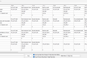

Kobold K2 - RISC TTL Computer
A 16 bit RISC computer with video display, from just a few TTL and memory chips. Online C compiler and simulator available.
The Kobold K2 CPU will be on a single pcb, constructed from TTL IC's. Its main characteristics are:
- 16 bit processor, 16 bit databus, 8 registers
- can access one Megabyte of memory
- no microcode
- every instruction executes in two cycles
To make it a complete computer, the K2 CPU will be connected to a mainboard, that will have:
- memory (RAM and parallel Flash)
- connector for video system, 80 x 25 characters text, graphics, and sound
- onboard mass storage 32MByte
- glue logic
- I/O connectors
Constraints are:- low number of parts (TTL)
- no off-the-shelf processor or microcontroller
- no programmable parts in the CPU
- no 74181 ALU
For the CPU part, 44 TTL IC's will be used.The video system has it's own project page: https://hackaday.io/project/172278-vga-video-gen

  • How fast is this thing, anyway ?
    roelh • 07/18/2020 at 15:47 • 2 comments
    It is interesting to know how the performance of the Kobold K2 compares to well-known processors. I did compare it to:
    • AVR (16 MHz)
    • 6502 (2 MHz)
    • 68000 (8 MHz)
    • 8086 (10MHz)
    Summary
    If you don't have the time to read the whole log, here are the results for a Kobold at 6.25 MHz:
    Kobold processor running the Sieve program
    There is only one classic test that is familiar, very often used, and easy to perform:
    It's called the Sieve of Eratosthenes.
    Here is the C source code for Kobold K2:
    The Kobold C compiler generates the following assembly code:
    For the speed, the inner loop is the most important. You can see here that the loop has 7 instructions, that is 14 cycles (every instruction takes 2 cycles).
    The prototype runs from a 25 MHz oscillator, and the cycle speed is 1/4 of that: It does 6.250.000 cycles per second.
    The whole sieve program (10 iterations) took 3.3 seconds (timed with an app on my phone).
    Compare with AVR
    I found in this article that the 16 MHz 8-bit AVR takes 14 sec to do the benchmark:
    So for the sieve, 6.25 MHz Kobold K2 is around 4 times faster than a 16 MHz AVR !
    Compare with 6502
    In this post someone describes the performance of his hand-optimized assembler sieve code for the 6502, taking 49 cycles for the inner loop:
    In our case, Kobold K2 does in 14 cycles what the 6502 does in 49 cycles. That makes Kobold 3.5 times faster.
    But Kobold's cycles are faster: 160 nS. For a 2 MHz 6502, cycles are 500nS. So this gives another gain of 3.125 in speed.
    So for the sieve, 6.25 MHz Kobold K2 is 10.9 times faster than a 2 MHz 6502 !
    And it does not even need hand-optimized assembler code to do this. The C compiler does its job well !
