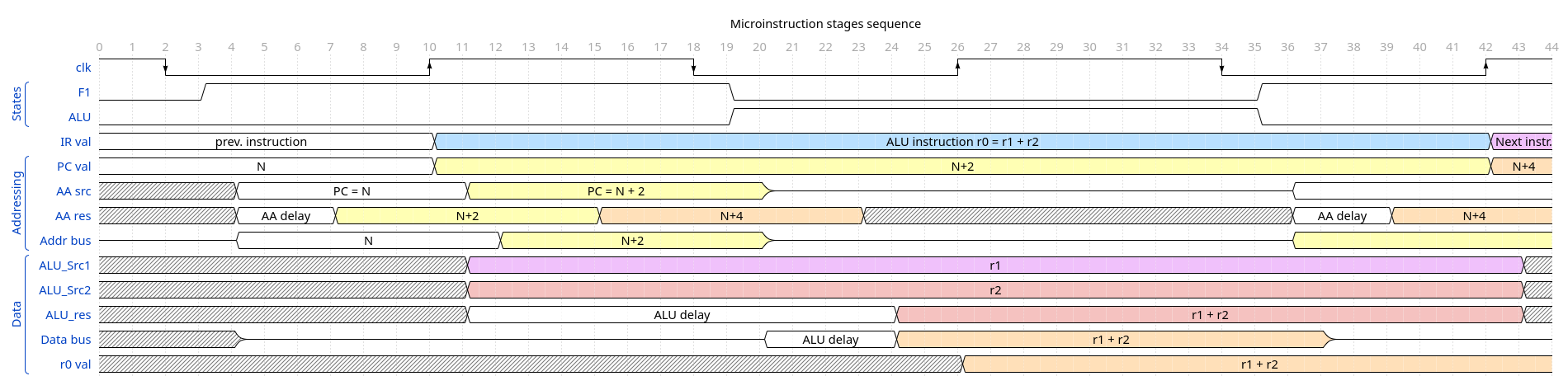

    The last time I made update to FSM design, it turned out working ok. But, returning to it now, I find that there is still room for improvement, especially regarding overall sequencing of micro-instruction stages.
    The overall sequence is as following: at the falling clock edge a new state is entered, and appropriate signals for selectors, bus drivers and register addresses to be written (write enable lines) to percolate through combinational logic circuits. Then, at the rising clock edge, all the registers (which have their write enable signals HIGH) get new data latched. Regarding data processing, as in example below for ALU instruction: the instruction itself has several bits that are used almost directly to set the ALU to do what instruction says, so the operation begins when there is still Fetch state. This gives time until next rising edge for it to output its result. On the other hand, between starting memory access operation (fetching instruction) and latching the value there is only half a cycle, which makes addressing very constrained by time available. The other half cycle for memory access is idle.
    Here is the example timing diagram showing this:
    I think, there is a way to make memory access time a full cycle, with moving setting of the select and enable signals at the rising edge. This will make them seem to be at the same time as latching, but in fact, the latching will be for values from previous micro-op, and there will be delay between rising clock edge and update to select/enable signals because they will be delayed by intervening combinational logic.
    This, along with tweaks to ISA prompts reevaluation and new update to FSM, on which I am working now.

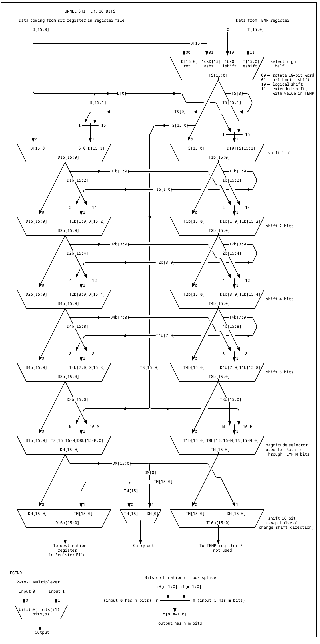

  • Funnel Shifter 16-bit diagram
    Pavel6 days ago 0 comments
    I had scaled up the model shifter described in previous log to the full 16 bit width. Along the way I found some inefficiencies in design, and corrected for them -- this made circuit to behave slightly differently in marginal ways, but overall change is positive due to some irregularities weeded out. This is mostly theoretical for now, as the circuit exists mostly as various diagrams I drawn while designing it; also I created the Verilog description, flashed it onto FPGA and tested -- it turned out to work correctly.
    Here is functional diagram of this circuit:
    As was written in previous log, this shifter makes use of additional register as source of data, the register is called TEMP, and it is outside of main Register File. This additional register is used only in subset of operations this shifter is capable of, namely, the Rotate Through Temp op (which is like Rotate Through Carry, but extended to several bits at once), and Frame Shift, where a contigous 16-bit field is extracted from combined Src and TEMP registers.
    The Rotate Through Temp requires special circuit I called Magnitude Selector. It consists of 2 parts -- the circuit that takes in 4 lines defining rotation amount (1b, 2b, 4b and 8b) and outputs 16-bit value containing from 0 to 15 ones, like this:
    0:   0000 0000 0000 0000
    1:   1000 0000 0000 0000
    2:   1100 0000 0000 0000
    7:   1111 1110 0000 0000
    15:  1111 1111 1111 1110
     through 16 lines; these lines, each ANDed with enable signal drive the muxes between 8b and 16b selectors. This makes it possible to swap a selected number of bits between TEMP register and shifted bits from Src register; the leftower bits of TEMP stay unaffected:
    This one is the more complex part of this whole circuit.

    I solved the staggering of ALU execution step and fetch of the next instruction.
    The state machine diagram is updated accordingly.
    The problem was in timings of propagation delays. All the registers are clocked on rising edge, and the update of gpr and IR should have been at the same exact moment. But in reality, there are several gate delays between rising edge of system clock signal, and the latching of particular register in the register file. On the other hand, instruction register is updated right at the system clock rising edge, thus control signals for the next instruction propagate at the time of latching registers for previous instruction, leading to wrong operation results.
    To solve this problem, I introduced "Shadow" register right after the Instruction register, that is latched some time after the IR:
    This new register is clocked with 90 degrees shift relative to system clock, so that instruction word is propagated to decoder a quarter of system clock period later, when all other registers are long latched to their values.
    Here is clock diagram for this:
    The system clock is derived from base clock by dividing its period by 2, and Shadow register clock signal is AND between base and system clock signals.
    2022-12-06 Update:
    I figured, there is no particular need to make additional clock phase -- all that needed is a sufficient delay between Instruction Register and Shadow Register latch signals. This can be accomplished by several consecutive NOT gates in the latching signal path for the Shadow Register. While tinkering with simulation, it become clear that delay of just 2 gates is sufficient. In real circuit it may better be done with longer delay, say 6 NOT gates, it will be 20-30 ns.
