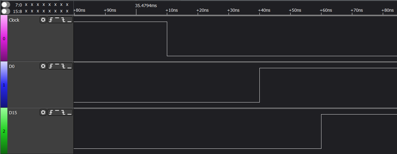

    Still working with the GPAR, the General Purpose Address Register. This design includes 4 chained 74HCT193 up/down counters. Each one handles 4 bits and the Adress Register can handle 16-bits in total.
    For some operations, the four 193 will work in parrallel, such as the RESET function, or the parrallel load.
    But, when using the INCrement or DECrement function, each one has to wait until the previous one is done computing to see if it needs, in turn, to increment or decrement. There is therefore an extended propagation delay for these functions.
    Using a 100Mhz digital Logic Analyzer, we are going to measure the delay when using the increment or decrement function. Note that this logic analyser can only sample the signal at 100Mhz, therefore the maximum speed is one sample per 10ns. So the results are not very precise but it can illustrate what is going on.
    For this, we plugged the GPAR to a 4Mhz clock, set the DEC function to permanent activation, therefore, the GPAR is decrementing at the speed of the clock, 4 million times per second.

    Step 3 - Delay to decrement all counters
    For this final measure, we consider the worst case scenario where all counters need to decrement. We measure the difference between the clock, the first bit of the first counter (D0) and the last bit of the last counter (D15):
    We can see the same propagation delay for the first bit D0, but considerably more for the last bit D15:
    • Delay for the first bit: 30ns minus the NAND 10ns = 20ns
    • Delay for the last bit : 60ns minus the NAND 10ns = 60ns
    However, this is strange because how could decrement over 4 chained counters take only 40ns (60ns delay for the last D15 minus 20ns delay for the first D0) when one counter by itself takes 20ns?
