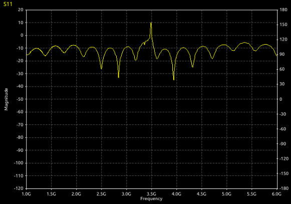

VCO is S11 at output. I simply measured VCO using VNA while it
oscillates but I’m not sure if it’s good method. It seems that
the VCO output has low impedance (probably it makes sense – it’s
OC circuit) so adding 50R in series at the output decreases S11.

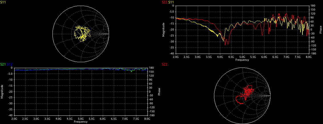

Typical application of BAP64Q 4-diode attenuator – 2.7dB insertion loss, 23dB attenuation at 3.5GHz.
Initially there was
a weird shape of gain characteristic.

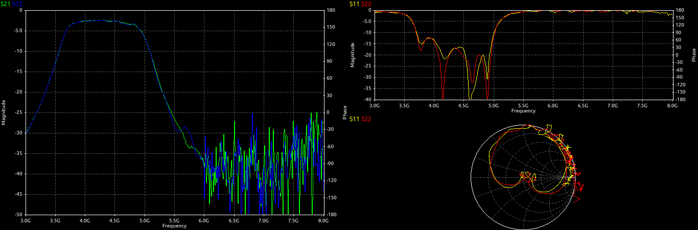

Filters were measured and the results were ok, loss better than 5dB on FR4, only center frequencies should be slightly increased.

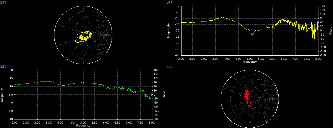

New amplifier was designed, measured and tuned.
Gain of 3 amplifiers connected (note: 2x 10dB attenuator installed – real gain is 22-27dB).

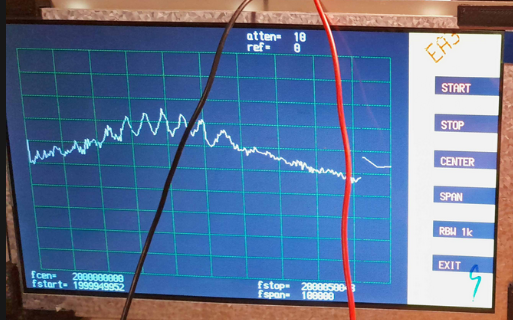

Recently I had chance to access a good spectrum analyzer for a while so I checked the results. The output signal looks bad (spurs, jitter), partially (mostly?) because I didn't even shield anything. Also I'm not 100% sure if everything is stable and not overdriven. The main tone is about 12dBm, it drops to about 8dBm close to 7GHz but in the remaining part of frequency range the output level is surprisingly flat (maybe about 2dB flatness below 6.7GHz). See the video in "files" (note 10dB attenuator was installed).
