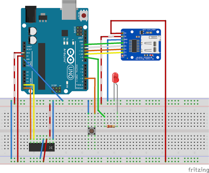

Here is the circuit I used:
I used an SD card breakout similar to the Adafruit one (so I used that in Fritzing, as that was the closest part). The connection is pretty standard — CLK (Arduino Uno pin 13), MISO (Arduino Uno pin 12), MOSI (Arduino Uno pin 11) and CS (Chip select). CS is configurable, though it defaults to pin 10 for hardware CS — I just use that.
For the button, I used the Button library by Jack Christensen, which provides debouncing and a variety of useful stuff in an easy to use package. (https://github.com/JChristensen/Button). The button is using the Arduino’s internal pull-up, so it doesn’t have any external pull-ups and also uses inverted logic (high is OFF, low is ON) — all of these are configurable as parameters to the Button constructor! I’ve hooked up the button to pin 4, but you can use any available pin you like.
I really did not have the time and patience to model Dr. Wattson as a new part in Fritzing, so I cheated, and used the advice of Z-HUT to easily whip up a custom part without much ado. I highly recommend watching it! https://www.youtube.com/watch?v=dfxx8wF3Uhs — thanks Z-HUT! :-)
The only downside is that I have to be content to use the breadboard image of the “generic IC” part that I modified to represent Dr. Wattson. C’est la vie!
Here is a look at Dr. Wattson’s pins (from left to right):
- SCL — for I2C communication, goes to Arduino Uno A5
- SDA — for I2C communication, goes to Arduino Uno A4
- ZCD — Zero Cross Detection — we are not using this feature in this example
- Event — Event indicator — we are not using this feature in this example
- GND — Connect to Arduino GND
- VIN — Connect to Arduino 5V (or to 3.3v on the RPi) - used for bi-drectional level shifting
- 3.3v — Connect to Arduino 3.3v (used to power the Dr. Wattson board)
- GND — Connect to Arduino GND (you only need to connect one of the GND pins)
Here is my Fritzing diagram showing the circuitry:
