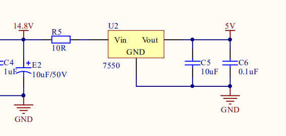

Step 6: MCU Can Use 7550

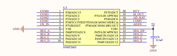

Step 7: MCU
The MCU I use is a Sonix OTP 8-bit control chip, a very cheap one,but it only can be programmed once.

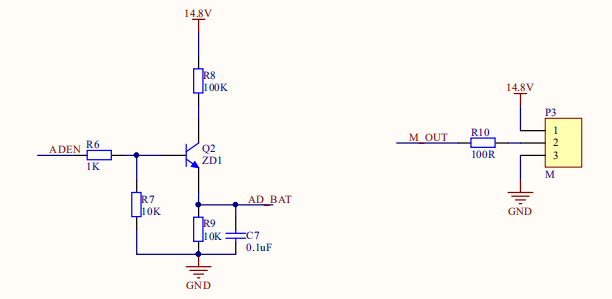

Step 8: Battery Detection and Motor Control

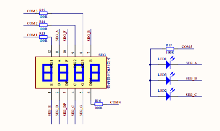

Step 9: Gear Display and LED Display
gear display requires digital tube for display, while LED display is enough for power and charging display
