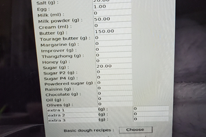

WireViz is a tool for easily documenting cables, wiring harnesses and connector pinouts. It takes plain text, YAML-formatted files as input and produces beautiful graphical output (SVG, PNG, ...) thanks to GraphViz. It handles automatic BOM (Bill of Materials) creation and has a lot of extra features.
Details
This project is maintained on GitHub. Please see the repo, which includes the syntax description, example gallery and short tutorial.
just want to leave a big thank you for this tool. I do actually use it for planning the wiring of my pick and place machine. (https://hackaday.io/project/176900)
Made planning a lot easier!
Vielen Dank und beste GrΓΌΓe aus dem Ruhrgebiet nach Berlin! :) Fabian
It would be great if you could use a database for input, I was thinking this would be very good to document computer fibre optic interconnect across a site. These can get rather large.
Hey Dude,
just want to leave a big thank you for this tool. I do actually use it for planning the wiring of my pick and place machine. (https://hackaday.io/project/176900)
Made planning a lot easier!
Vielen Dank und beste GrΓΌΓe aus dem Ruhrgebiet nach Berlin! :)
Fabian
