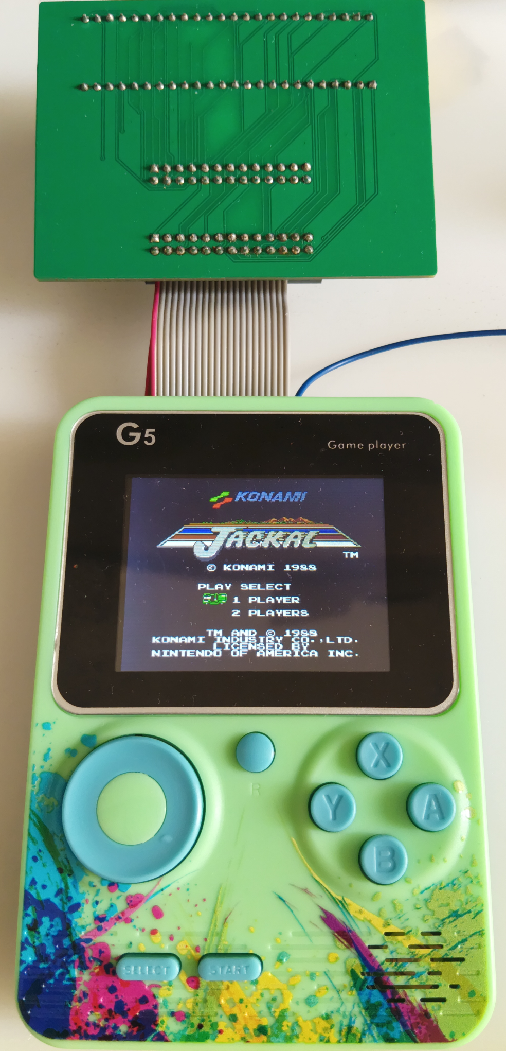

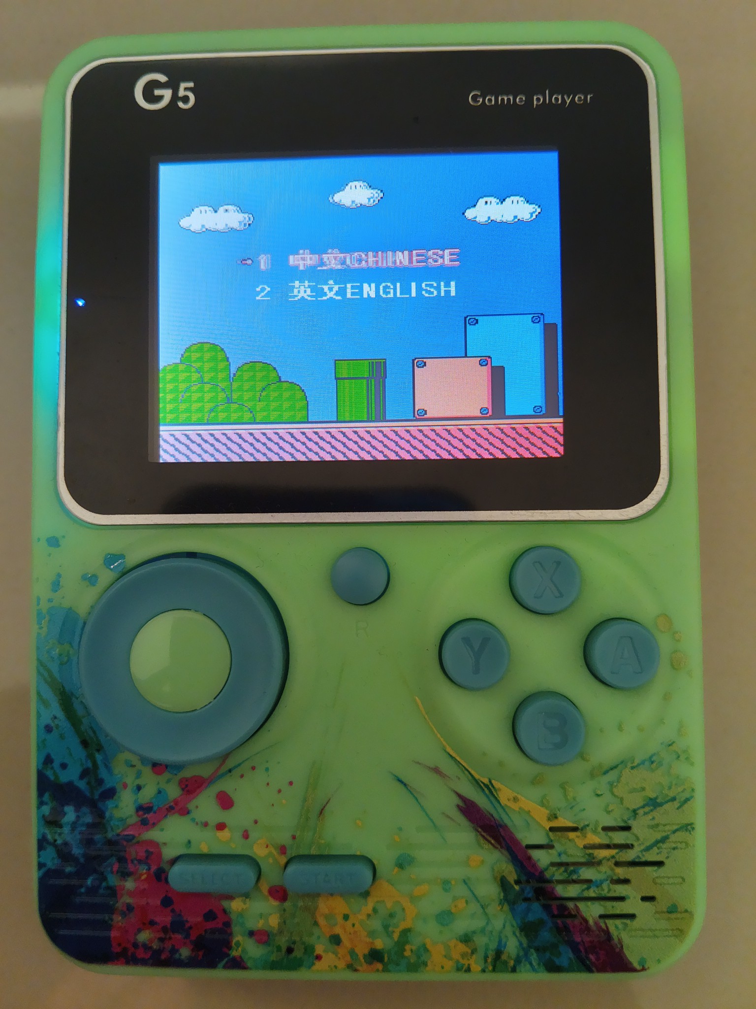

    Over the long weekend after examining the dump I struggled to have this working on the actual handheld. Imitating previous attempt from my site earlier, this one is easily replicated as soldering on the 1.28mm pitch is easier!
    But, when I put that ROM inside, the backlight flashed a moment and then empty screen! Yes the TFT was initialized judging by the gray background on it and nothing on it!
    Out of my curiousity, and the knowledge of the previous attempts, switching on the backlight plus the display often happens when the main menu or the Aaronix test screen is starting.
    I noticed that code fragment and put these onto the startup code that enables the backlight and the display together:
    lda $4139
    ora #$02
    sta $4139
    lda #$1f
    sta $413f
    Well, it worked!

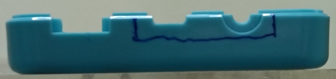

    However, the direction of the cable seemed to be going downward the handheld instead of the other one. The ribbon cables have to be folded upward so that the controller points can be exposed.
    Folding that cable, carefully not jiggle the solder points some more, and made that large cut on that plastic casing (Yes I know I should use a ruler and cut this perfectly - but this would be the other topic in the future!). I even took out the jack that connects it to the TV since it occupied too much space for that thick ribbon cable:
    It seems to play most of the Mapper 0 and Mapper 4 games and looks like there isn't much problem. Oh, and this is only 8MBytes of the stuff - I could use a 16MBytes but this will be another topic in the future.
    Well there it is! I can finally play "Magic Jewelery" on the couch, or I can put other homebrews inside too...

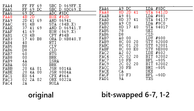

    So from the previous log... I dumped the entire G5 binary inside. Looks fun? Nope. Full of corrupted binary, I jiggled these wires again and again just to get something consistent. And, it doesn't start when I launched it in the EmuVT.
    The lucky part is, there's no data bits being swapped. All the sprites and tiles are in an original condition.
    The more difficult part is: this thing has bits swapped in its opcodes at its startup! I managed to track them when I see familiar numbers such as $412D and $4137 and with a lot of other strange opcodes that don't make any sense.
    Playing around with the bits (and with some previous knowledge on the other 400-in-1 handhelds) I noticed that bits 6,7 and bits 1,2 are swapped on its opcodes. The operands are spared in this process.
    Compared to the other handhelds, the bit-swaps are not just the first few instructions - it has about 200 bytes of them! I wrote a Python script, managed to undo all the bit swapping and it runs now on the emulator!
    I am not entirely sure if this first 512KiB of that program will work anymore when it is placed back into the original handheld (of course with the bits being untouched). A broken dump would mess up the TFT initialization routines inside and could render this whole thing useless immediately! So, at all costs, that startup code must be preserved!!

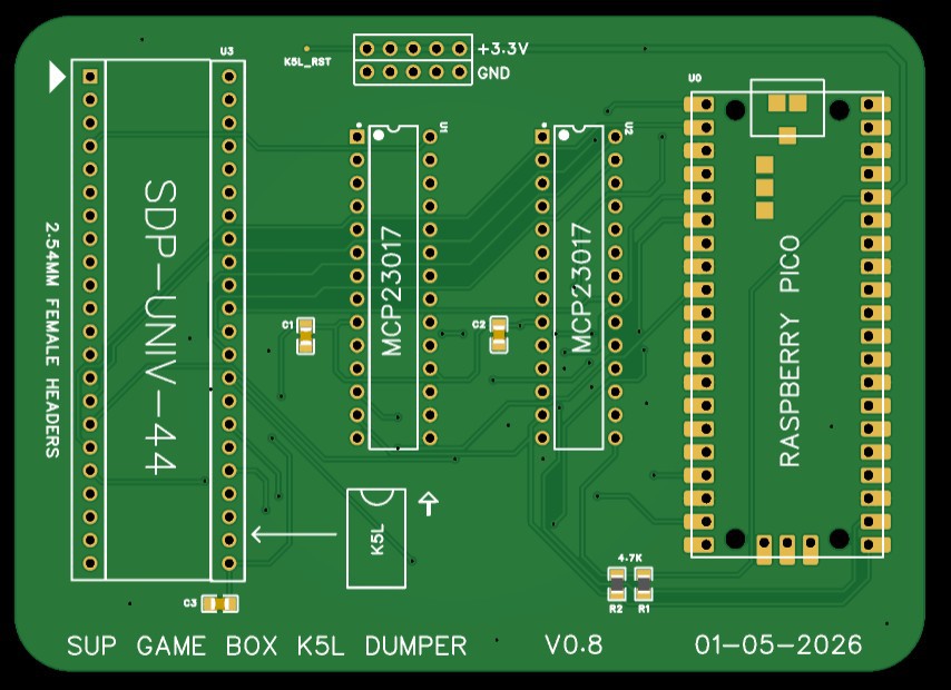

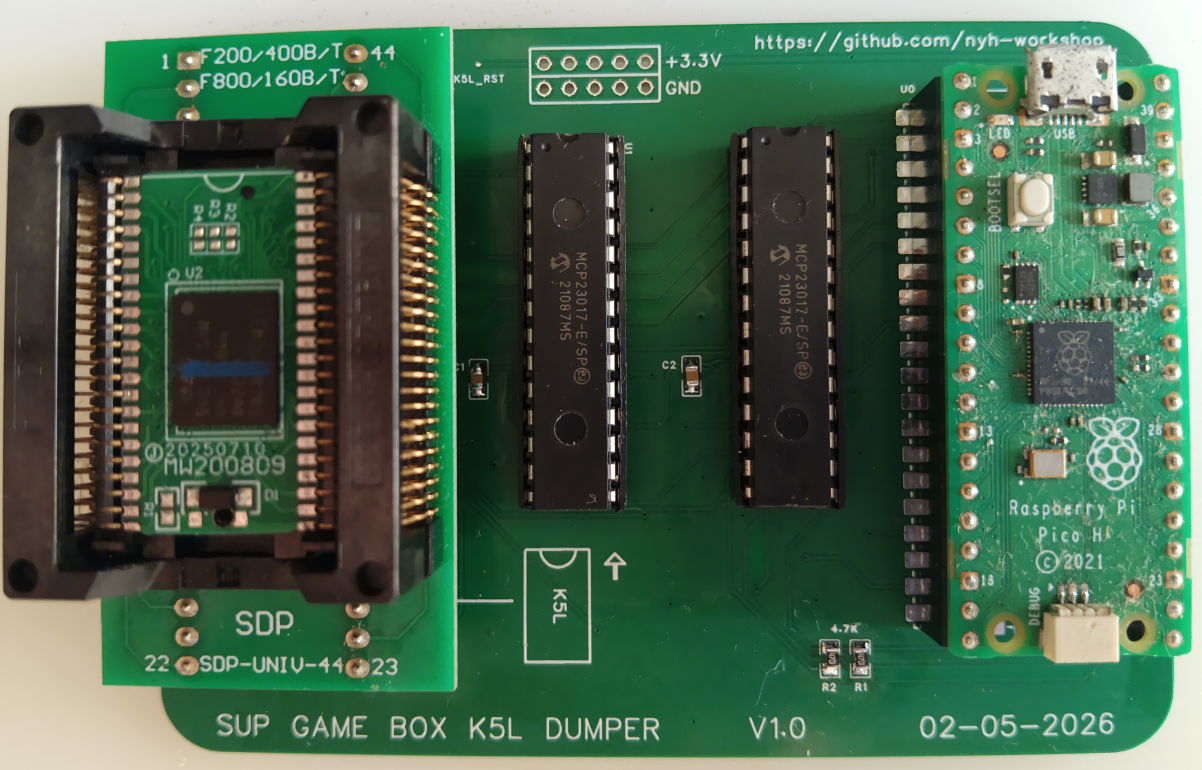

  • Prototype K5L dumper and G5 Handheld
    YH-workshop05/01/2026 at 10:07 0 comments
    This is two topics, but I rather squeeze it into one here today.

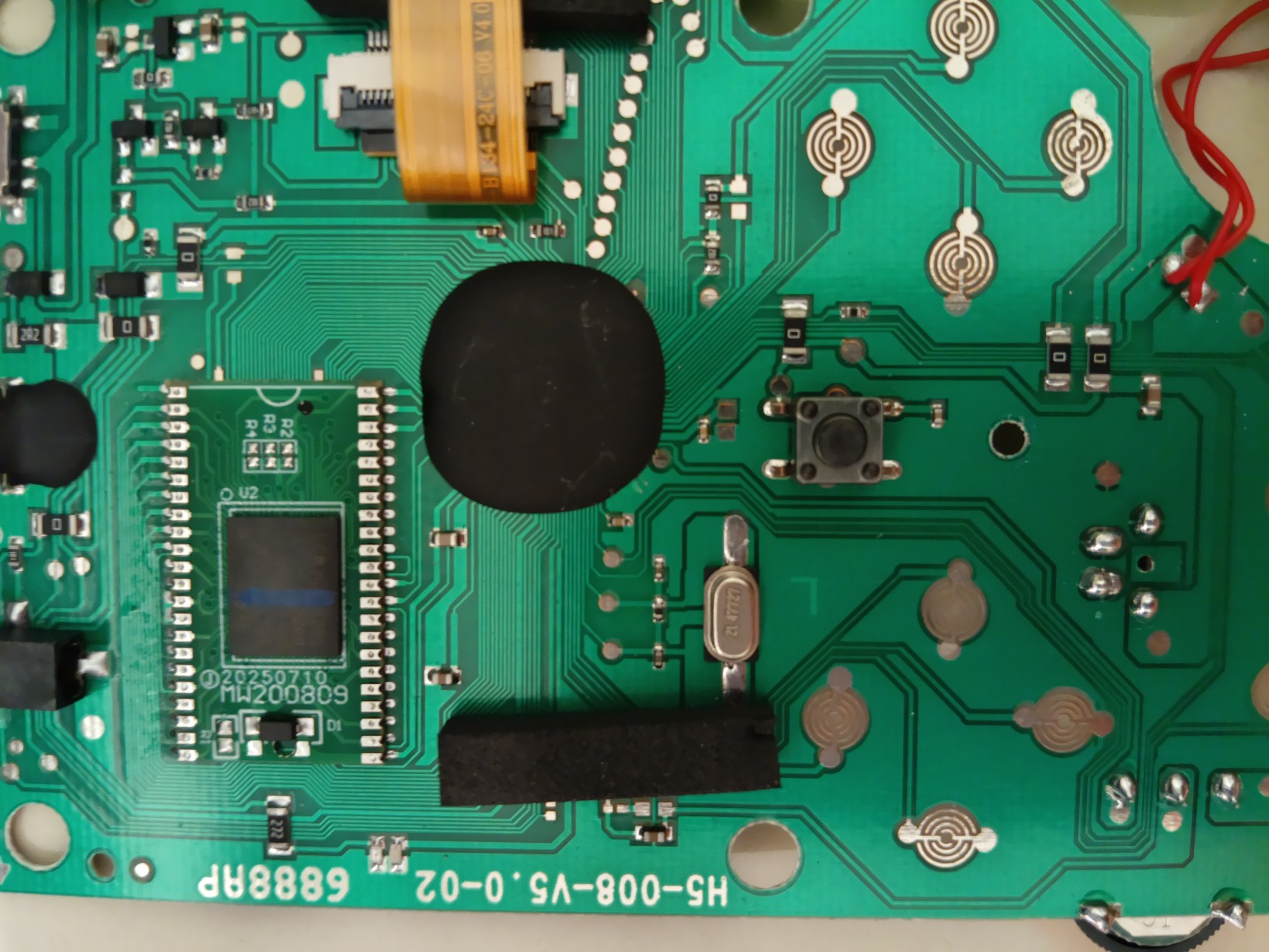

    I also recently got myself those "G5" Handhelds - they were sold for $3 at a certain time of the day and month, so I got myself these too.
    Instead of the casual "400-in-1", I got a "500-in-1" too. The games are mostly identical to the "400-in-1" and they are still mostly filled with mediocre games inside.

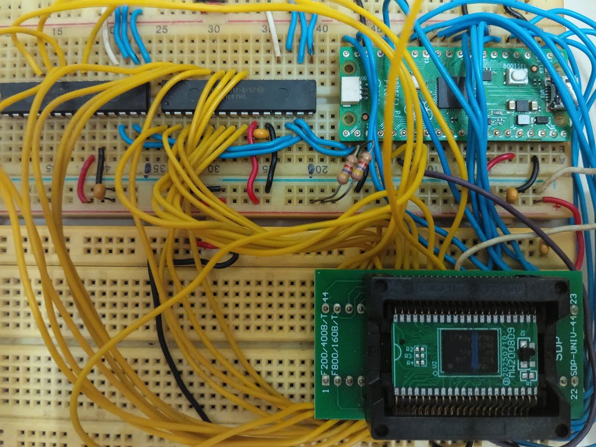

    So I ripped it out and yes, it's that usual BGA Flash Breakout again:
    As usual, took this flash out using "ChipQuik" and did the dumping using my K5L dumping tool there in my github.
    Unfortunately, this dumping isn't any smooth or easy. I kept getting broken tiles and sprites inside, or corrupted binary. There are really loose wires and such all on that breadboard (and it's caked with some dust!) Didn't even use it for a few more months, and there goes all the connections! Breadboarding is only good if I'm testing the prototype, but as it's now working, I should be putting this onto a board instead.
    Fortunately, I know there's this service called PCBWay to help people to build more effective tools in a low cost and reliable way. Then I immediately drew this, and sending this one to the PCBWay over the weekend!
    After messing around with the connections again, I got that bin file dumped in a more consistent manner. Examined it and this belongs to the next log! :D

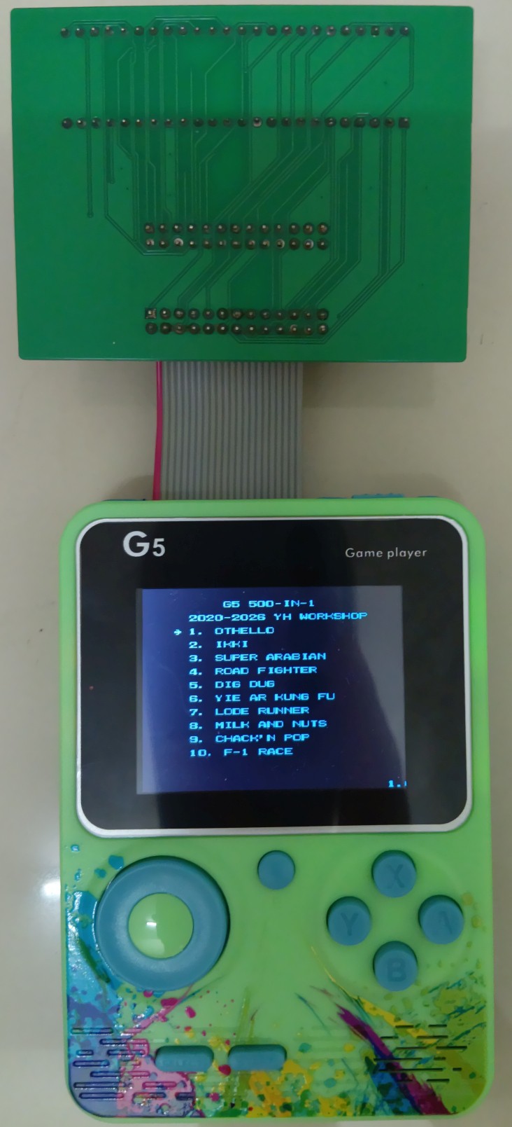

  • Prototype Prototyping In-situ Programmer
    YH-workshop04/26/2026 at 11:50 0 comments

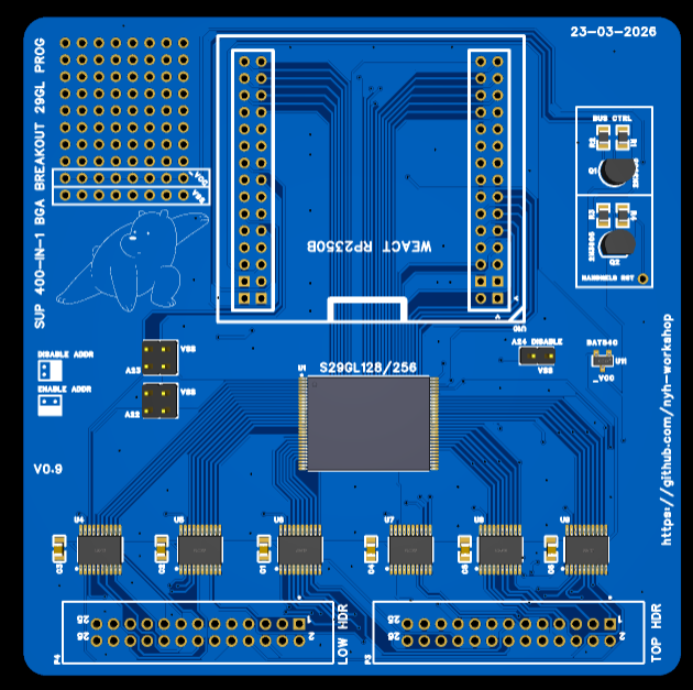

    Whew! With some time in these weekends I managed to draw a prototype of the in-situ programmer that connects the handheld's flash socket to another custom board.
    Hard to explain in words so I rather put a picture of this:
    This enables one to program directly into the flash, while connecting this to the handheld's flash socket.
    This one is a BGA breakout board version - there are ribbon cables connected to the headers below.
    These 6 chips in the middle - the buffer chips, to conveniently isolate the lines from the handheld when programming the flash.
    Generally speaking, it means you don't need to get an expensive T56 programmer and its adapters to prototype your own code to run in the actual handheld.
    You can temporarily do all your prototyping programming on that handheld without moving the chip back and forth.
    When you are satisfied with the code (and it is working on the handheld), you can finally flash the chip and place it back into the handheld.

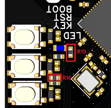

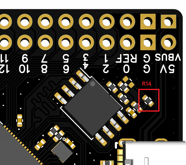

    The Weact RP2350B board (and a few modifications on the board) is required as it has the most GPIOs and can directly connect them to the S29GL flash without using the I/O expanders.
    To have the board fully access all the pins on the S29GL flash you need to remove these components that are in red:
    Trying to get these working is a whole thing of its own. Currently it is going through some revisions:
    - "Busy" pin should be connected and sampled. Trying to read the status after writing a word can be extremely slow and results in corrupted data.
    - S29GL flash must be soldered properly and it means putting more flux during soldering - else data corruption might occur.
    - I have only used the plain GPIO to work on that S29GL flash. Future improvements including using PIO plus the DMA to improve the flashing and reading speed.

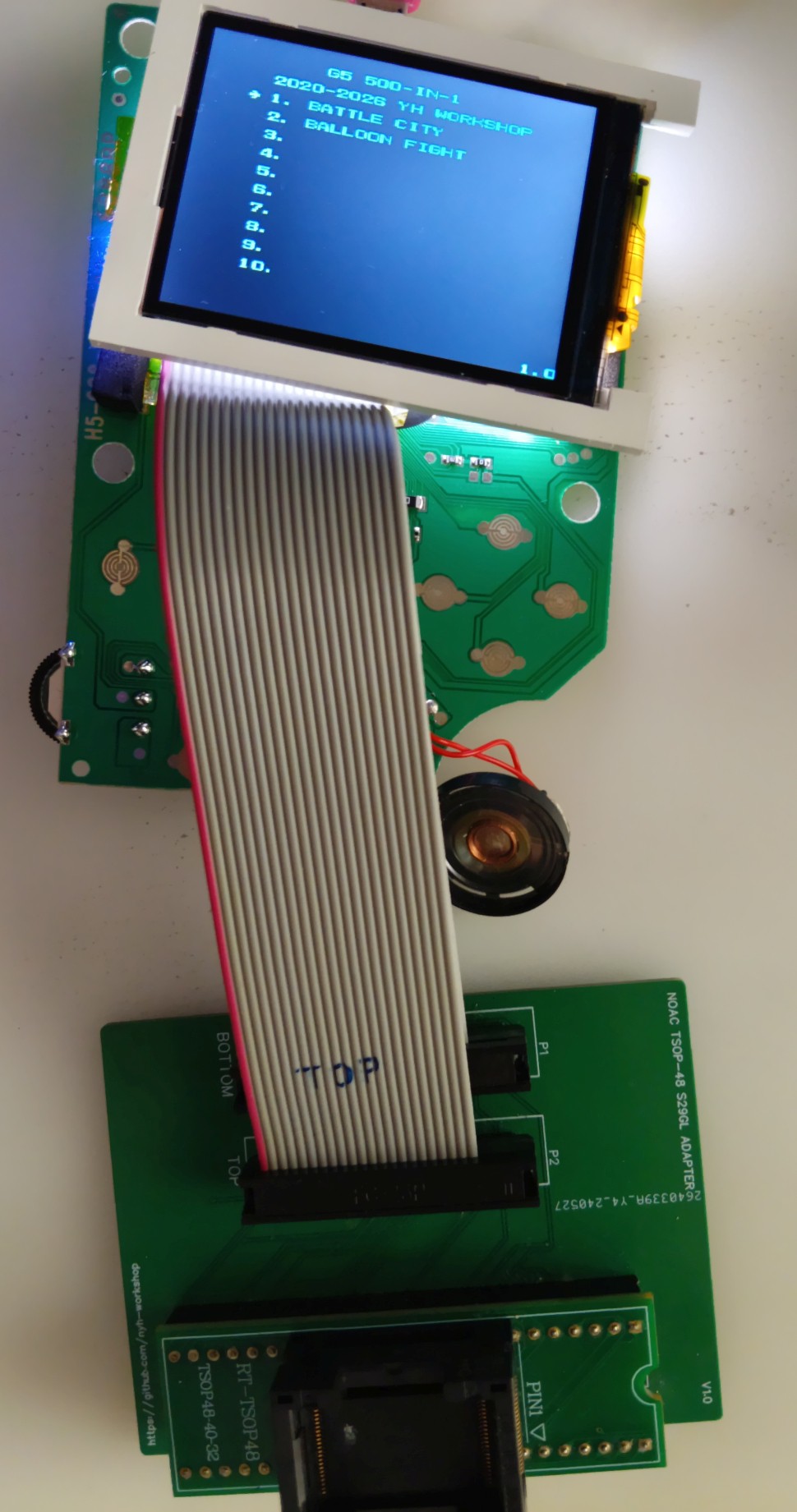

  • New Menu Builder, and Trouble with the TSOP-56s!
    YH-workshop02/13/2026 at 01:58 0 comments
    Hi! Finally I got to revisit it again after checking the disassembly of the software in this github.
    The problem with it is, right now it is very difficult to compile and load the games because:
    • manually place the game graphics and code
    • set the OneBus registers
    • and recompile.
    No, the Nesmaker from NesDev doesn't work - the init code does not match whatever hardware that is on the handhelds. I have read this over and over again to be sure, and I'm open to new feedback for this one! :D
    I have written this builder to facilitate the task of loading Mapper 0 and 4 games and then compile it with the initialization ROM (again, you need to get the ROM dump from the handheld, and the build folder from the custom menu template!):
    This compiles the whole thing into the BIN file for the emulator, and also a separate BIN file for the handheld. There are variations on these handheld such as bit swaps so after all the compilation it reverses whatever it is to be workable for the unit.
    However, the recent one I'm testing are the TSOP-56 variant - the ones with the S29GL flash. It looks... easy right, since I can undo it through the hot air...?
    Not really! Yes, with enough experience, I could do it a few times, but repeated cycles of unsoldering, reflashing and soldering could make these flimsy traces snap very easily! I have messed up one board because of this!
    Worse of all, do not use a vice to hold the PCB of that unit too tightly! Flexing the board would means it breaks immediately!
    Imitating previous work of mine, I might be doing a TSOP-56 version for this one so the board doesn't have to tolerate too many of the repeated cycles of de/soldering. :D
