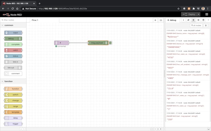

Temporarily we are going to receive all messages from our MQTT broker by setting up topic as: #
(Later we will change it to specific topics once we know what device we want to receive data from.)
Our MQTT receiver is configured. Now we can attach "debug" node to print out all the messages coming from the MQTT broker. Press the "Deploy" button.
In the debug tab we should see incoming messages from the broker. However it is empty now because we do not have any device sending messages. Let's go and make a simple temperature sensor with Cricket to send data here.

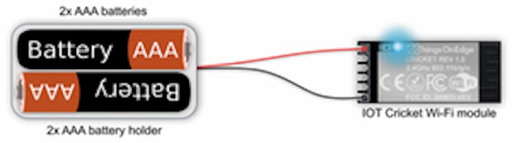

We use IOT Cricket WiFi module to make a sensor which will be sending a temperature value every 30 seconds to our system. It will run on a battery so we can stick it anywhere at home or a garden. Later you can also use Cricket to build various battery powered sensors, alarms, buttons, switches and connect them easily by using the same approach to Node-RED.
In the first step let's attach batteries to Cricket.

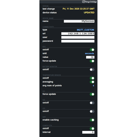

In order to do that open Cricket's configuration panel (see the full steps here):
- press the Cricket button for 5 seconds
- connect to "toe_device" hot spot from any device with browser capabilities
- set the following settings (as shown on the image below, please adjust IP address in "url" box to your RPi)
NOTE: we set it to wake up every 30 seconds, the frequency is good for playing around with data and setting up this project. However once you are done with this project, please change it to make it more sense for example set it to 1 hour or so - it will save the battery a lot.
Now we can exit from the configuration mode.
The device is ready! Cricket is sending data to our MQTT broker every 30 seconds and also our Node-RED system is receiving these messages. We can inspect them in the debug tab as shown on the image below:

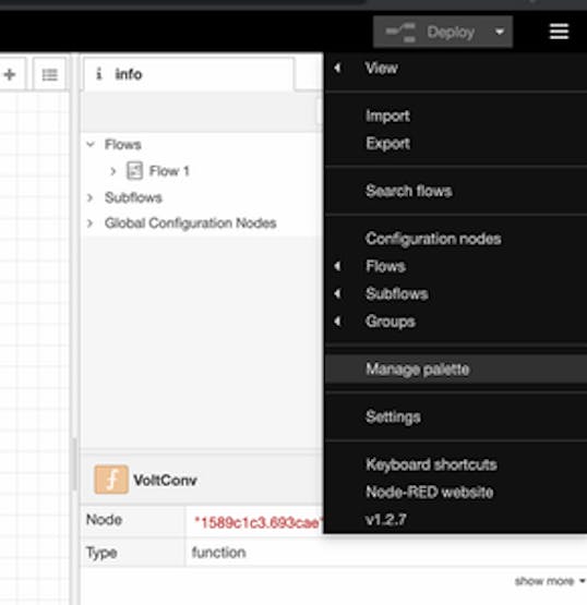

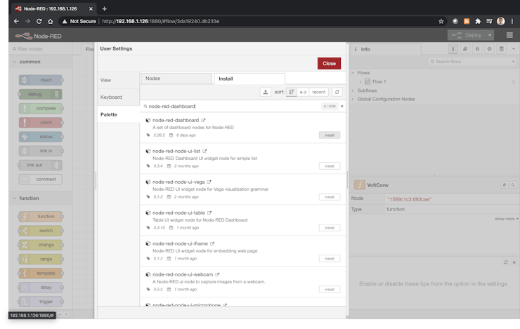

However there is one extra component called "node-red-dashboard", which we have to add to Node-RED. In order to do that, click on the account icon and select "Manage palette" as shown on the image below:
Then go to Install tab, type "node-red-dashboard" and press the install button.

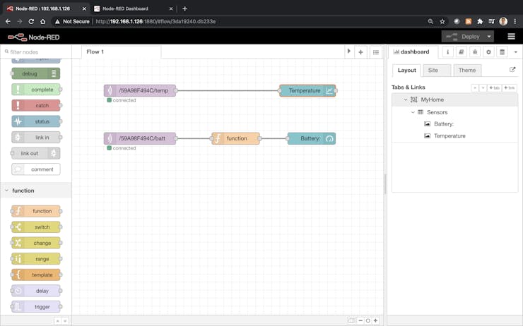

Now we are ready to create a dashboard. We already know our device and the exact topics it is sending out. We can precisely set topics for data which we are interested in. In our case the device is reporting temperature and battery on the following topics:
/59A98F494C/temp
/59A98F494C/batt
So let's create the whole diagram from scratch:
- create two "mqtt in" and assign with the above topics
- create a chart (for Temperature) item and connect it with the temp mqtt input
- create a gauge (for Battery) item and connect with the batt mqtt input

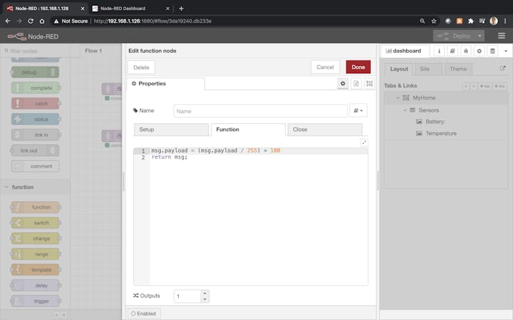

- create a function between the batt mqtt input and the gague item to calculate % of the battery
- create Tab (e.g. MyHome) and Group (e.g. Sensors) - you need to assign group to the chart and gauge items
as shown below:
The function converts the battery value, reported by Cricket, to a percentage. The complete function body is shown below:

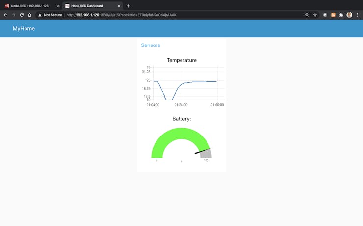

Now we are ready to deploy and open our dashboard by using the same link address as we used to open Node-RED editor. We only need to add "/ui" suffix at the end of the address. In our case the link looks as follow: http://192.168.1.126:1880/ui

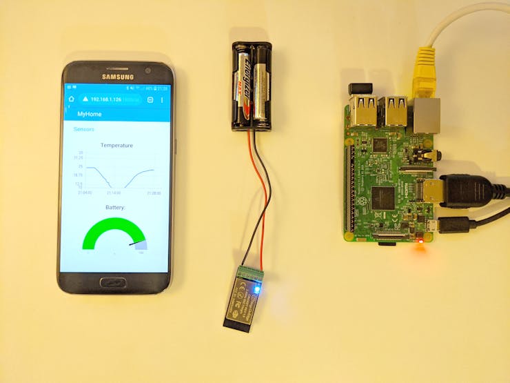

We can now enjoy our own live dashboard of our WiFi automation system on any computer or phone. Of course it's been a very basic project of putting together a temperature sensor and the basis of how to come up with a simple dashboard. But that's the foundation of what you need to build upon for more advanced systems and rich experiences.
In this project we have shown an essential hardware and software needed to start building low power, energy efficient, automation systems. Node-RED and Cricket allow us to build advanced systems without writing any code. This results in a rapid deployment of various IOT solutions and automation.
Now as we have this foundation infrastructure in place, the sky is our limit of what other WiFi devices we can build using Cricket and integrate with Node-RED system.
