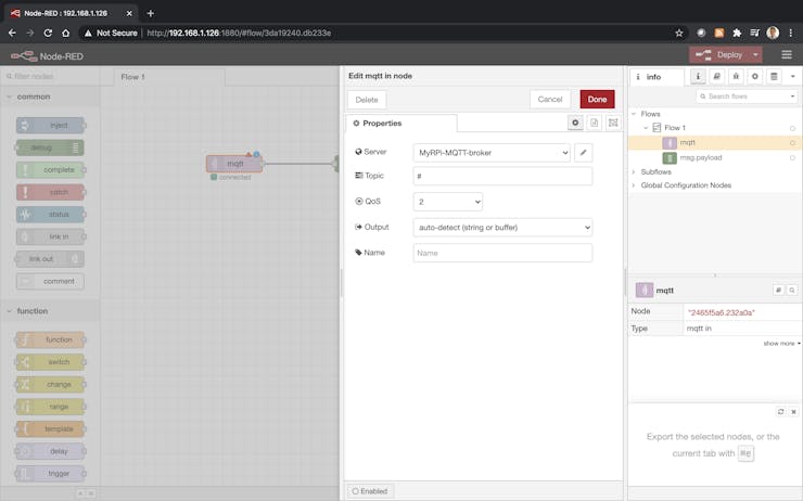

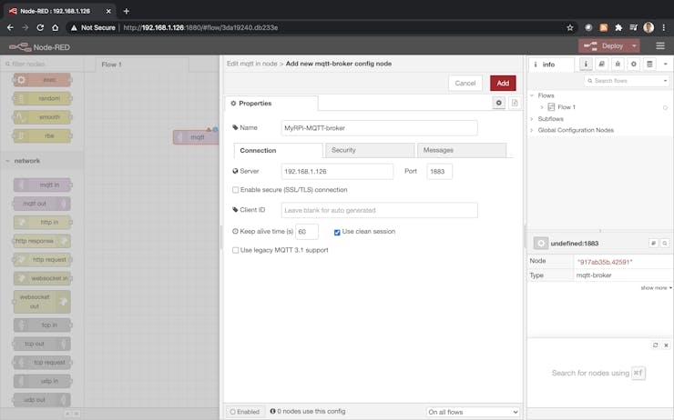

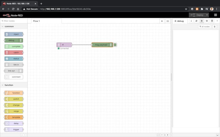

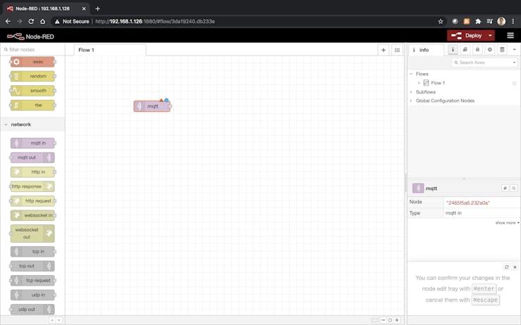

Creating a dashboard in Node-RED
create two "mqtt in" and assign with the above topics.
create a chart(for Temperature) item and connect it with the temp mqtt input.
create a gauge (for Battery) item and connect with the batt mqtt input.
