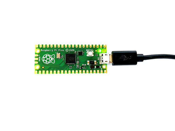

    Raspberry Pi Pico is a tiny, low-cost computer that you can use to build various devices by attaching peripherals. It is a versatile microcontroller with flexible digital interfaces and great support of software making it super easy to code and program those little boards. However, it doesn't come with a WiFi connectivity feature. The good news is it is fairly easy to extend it with WiFi without losing its power efficiency, which we demonstrate in this project. (For more information visit Raspberry Pi Pico official website)
    We strongly recommend, if you are not familiar with Pico, to follow this awesome Getting started with Raspberry Pi Pico tutorial.

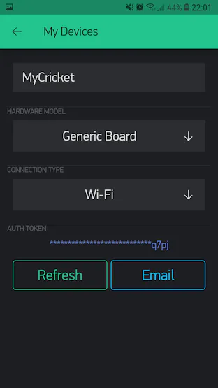

    Once installed we need to configure it. Open Dashboard settings and add the "Generic Board" device with the connection type: "Wi-Fi". Once it is created press the Email button to send an email with a unique authentication token. We will need this token to configure Cricket to send notifications to our phone.

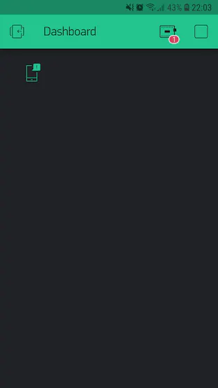

    Now let's add a Notification widget to our Dashboard and press the Play button in the upper right corner.
    This is it! Our app is ready to receive notifications.

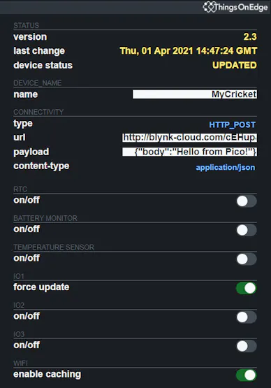

    In this project we use Cricket to make Pico sending notifications to our phone. We configure Cricket in such a way that on every wake up it connects to WiFi and sends a request to Blynk via HTTP POST method. Then Blynk sends the notification to our phone.
    Cricket wakes up when a voltage appears on the WAKE_UP pin. As our Pico's Pin15 is wired with Cricket's WAKE_UP pin, so when it is set to "1" it raises the voltage and wakes Cricket up.
    Let's configure Cricket with the following settings:
    • CONNECTIVITY > type: HTTP_POST
    • CONNECTIVITY > url: http://blynk-cloud.com/YOUR_KEY/notify
    • CONNECTIVITY > payload: {"body":"Hello from Pico!"}
    • CONNECTIVITY > content-type: application/json
    • IO1 > force update: On
    An example configuration may look like this:
    This is it. We can press the switch off button in the top right corner to exit from the configuration and our device is ready to go!

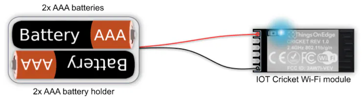

    It's time to put all the components together!
