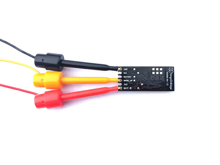

In this project we use Cricket to make Pico sending notifications to our phone. We configure Cricket in such a way that on every wake up it connects to WiFi and sends a request to Blynk via HTTP POST method. Then Blynk sends the notification to our phone.
Cricket wakes up when a voltage appears on the WAKE_UP pin. As our Pico's Pin15 is wired with Cricket's WAKE_UP pin, so when it is set to "1" it raises the voltage and wakes Cricket up.

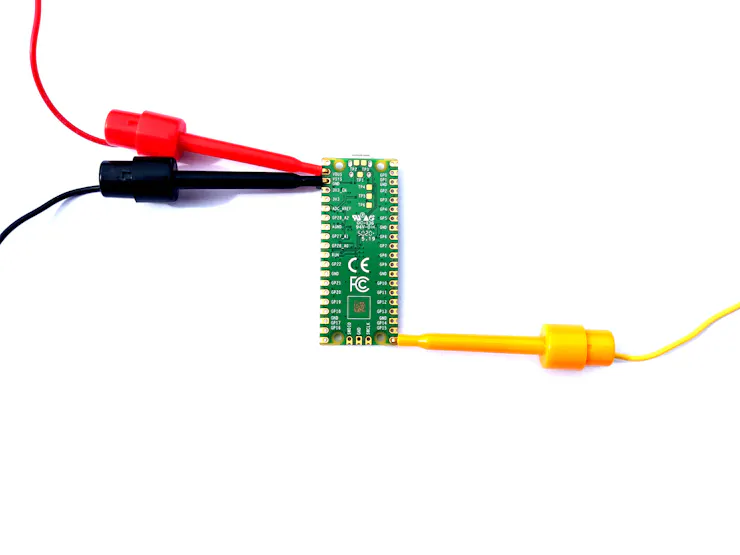

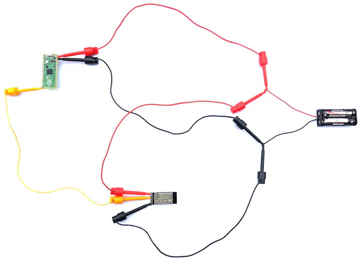

4Step 4) Assembly and final testing
We are going to power both Pico and Cricket boards independently from the AAA batteries so they both have independent power sources.
NOTE: we might want to consider powering Pico from Cricket 3v3 in some use cases. This would further improve power efficiency. It is something to be considered for future projects.
Now let's put all the pieces together and test it out.
- Connect Pico to the batteries and wire a yellow cable to Pin15
A complete project assembly may look like this:
Of course we may compress it to a far smaller form factor by soldering components together. However, in this project we want to clearly show how all components are coming together.

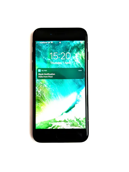

After the assembly and connecting the battery, the project should be automatically up and running. Every 5 minutes the Pico board should be flashing LED and waking up Cricket to send notifications on our phone by using Blynk.
