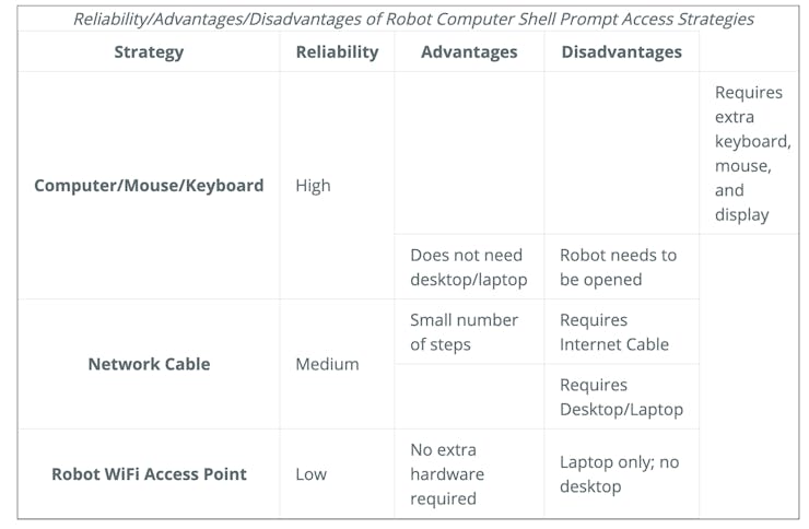

2Working with ROS
There are three ways you can control and code your robot.
The easiest way was to connect the monitor and keyboard to raspberry pi to work with code.
Something we would want to be able to do is to access the ROS communication messages from our laptop.
Spin a Linux machine with ROS Kinetic Kame. Either a virtual machine or a real machine. I used a VMWare-Fusion with Ubuntu 16.04 We will refer to that machine as the Observer machine. The robot is the Master.
You can follow this tutorial to set up the robot as amaster and Laptop as an observer machine.
Notes
- RVIZ won't work in VNC. I tried and failed. You need to use Virtual Box or Vmware to work with ROS remotely.

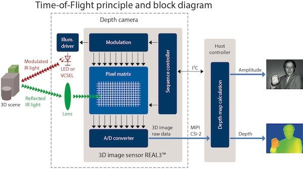

How does LiDAR work?
The basic principles for traditional LiDAR have been seen in time-of-flight-based distance measurement and triangulation-based measurement.
The ToF concept uses the delay time between the signal emission and its reflection to compute the distance to the target. The time delay is not measured for one particular beam’s round trip.
Basic overview of how ToF works. Image courtesy of Mark Hughes.
Instead, the phase shifts for multiple signals are used to indirectly obtain the ToF and then compute the distance. The triangulation method is used to measure the distance between the source and the obstruction.

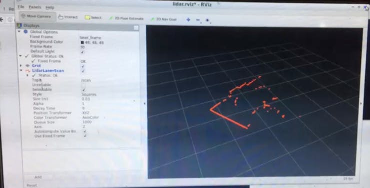

Test the lidar with
roslaunch ydlidar lidar_view.launch
Visualize the scans in Rviz, by adding the topic /scan.
point cloud using Ydlidar X4https://youtu.be/Z1Y9U8EZ1DE It may look something like this.
![point cloud of my room.]()

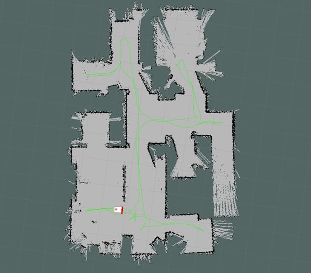

9Save a map.
In separate terminals, run:
roslaunch UVbot UVbot_teleop.launchroslaunch ydlidar_ros lidar.launchroslaunch hector_slam_launch tutorial.launch
And open Rviz from another Linux machine, if possible or in the rapsberry pi monitor to see it
Now, as you’ll be driving around the space (slowly! We want the map to be built accurately, so no need to give it a hard time doing so.) you’ll see a map starting to be built in real-time, in Rviz. The lighter colors are empty space, and the dark ones are obstacles.
When you think your map is sufficiently good, run the following:
rostopic pub syscommand std_msgs/String "savegeotiff"
This will save a.tif and a.tfw files in
~/catkin_ws/src/hector_slam/hector_geotiff/mapsdirectory.This image shows an example map created.
