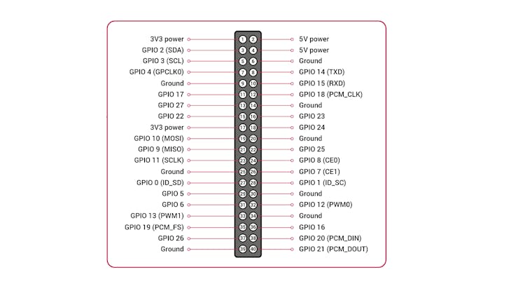

4Setting Up Breadboard version
Before setting up the Breadboard version, the raspberry pi pinout looks something like this!

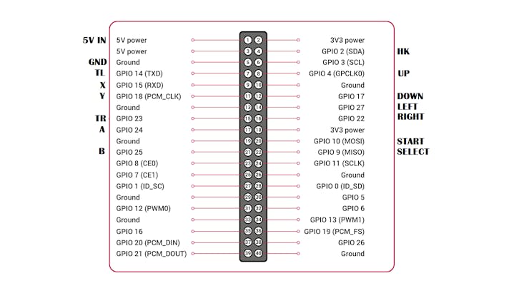

but I'm using a custom GPIO adaptor (which I made from male and female header pins), when we add this adaptor on Raspberry Pi's GPIO Headers, Our Raspberry gets inverted and Pinout becomes something like this- (Inverted)
![Connect each button with GND and mentioned GPIO Pin]()
Each button is added between the GPIO pin and GND, by pressing the button, the attached GPIO pin is grounded.
