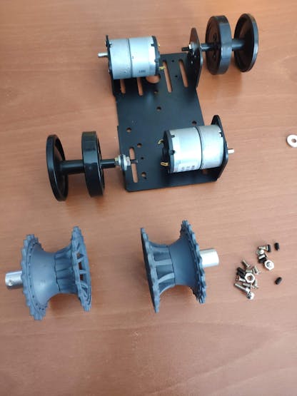

2Assembling the Tracked Robot Chassis
First of all, I assembled the DFRobot Black Gladiator (Tracked Robot Chassis) and connected an L298N motor driver module to the robot chassis to control its DC motors easily with Raspberry Pi GPIO pins.
⭐ Install the load-bearing wheel (first install the M4*50 long screw into the load-bearing wheel) and lock the other side with the M4 screw.
3Assembling the Tracked Robot Chassis
⭐ Place the gasket on the bracket and insert the load-bearing wheel into the hole of the bracket. Then, seal it with the other gasket and the M4 nut.

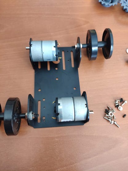

4Assembling the Tracked Robot Chassis
⭐ Insert the motor into the bracket and tighten it with 3 M3*6 flat head screws.

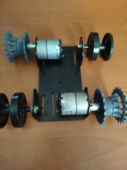

5Assembling the Tracked Robot Chassis
⭐ Join the two sides of the drive wheel and lock it with the M3*8 hex socket screw.
6Assembling the Tracked Robot Chassis
⭐ Attach the drive wheel to the motor and tighten the connection with the black screw sent with the kit.

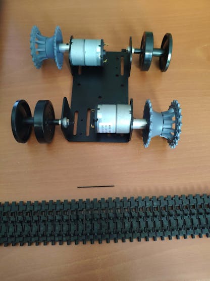

7Assembling the Tracked Robot Chassis

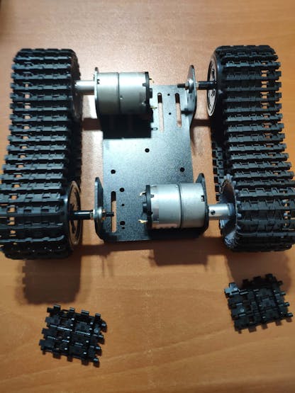

⭐ Disconnect the track to measure the required track length and discard the redundant part.
8Assembling the Tracked Robot Chassis
⭐ Wrap and reconnect the track after attaching it to the wheels.
9Assembling the Tracked Robot Chassis

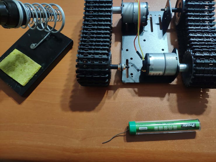

⭐ Solder male jumper wires to motors and connect them to the L298N Motor Driver Module. Then, fasten the L298N module to the bottom of the bracket with a hot glue gun.

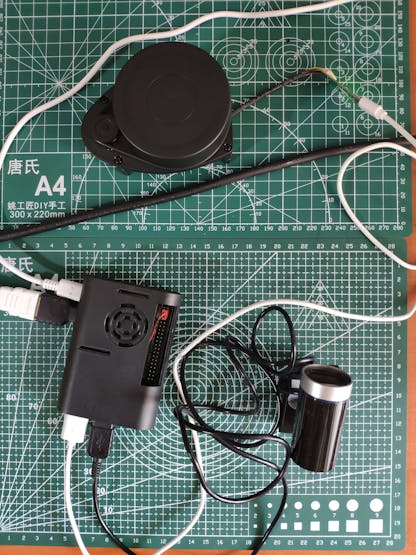

10Building the Litter Detection Robot
Then, I connected the RPLIDAR A1M8 360 Degree Laser Scanner (Lidar) and the USB webcam to the Raspberry Pi 4.
