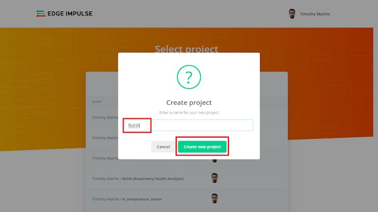

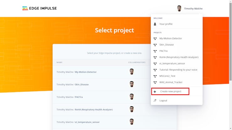

Before you can start developing the tinyML model, you need to have an account on Edge Impulse which is free for developers. Once you have the account, login to your account, choose create a new project
Image: Create new project
and choose name to your project and then click on create new project button.
Image: Give name to your project

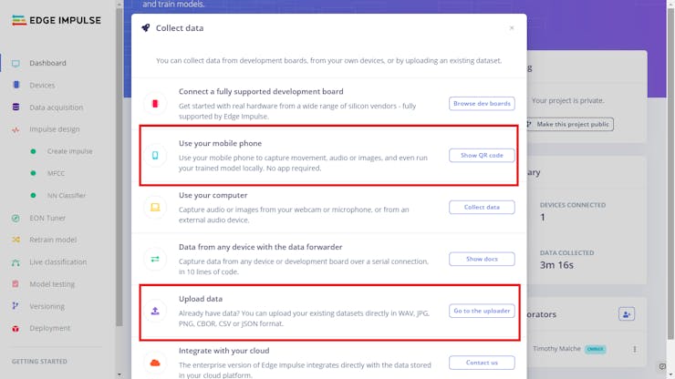

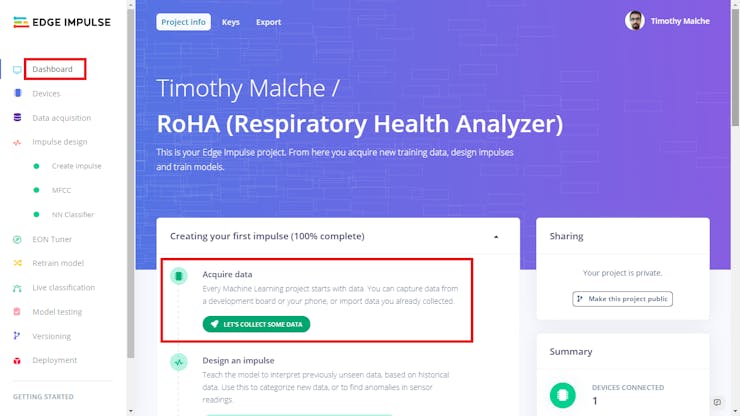

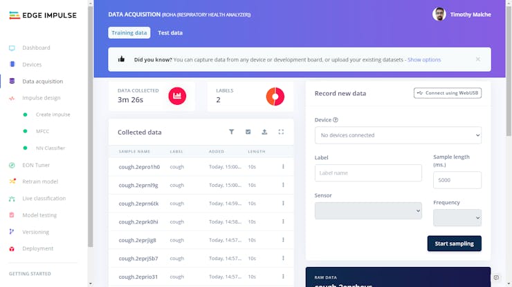

after this, the next step is gathering the data for your project. For this go to dashboard and click on lets collect some data button.
Image: Collect Data
When you click the button the following screen will appear.
Image: Choose data option

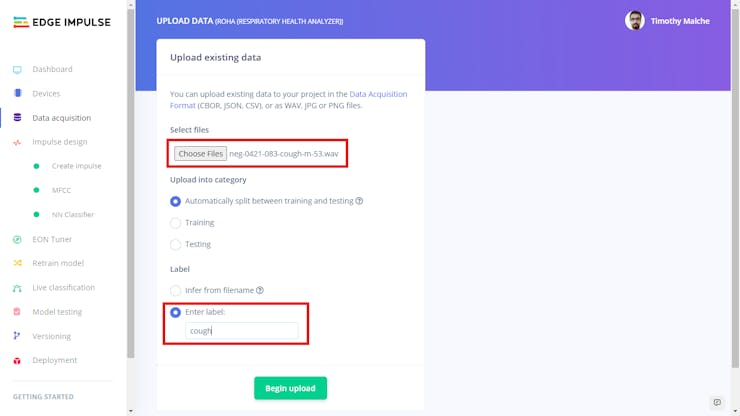

In this screen, if you already have data-set in WAV format then you can use upload data option, other wise choose use your mobile phone option to record data for the model. If you choose upload data option the following screen will appear, from here you can choose one or multiple files and specify label for those group of files and than click begin upload button to upload data.
I have used use your mobile phone option which opens the following window.
Image: QR code for mobile

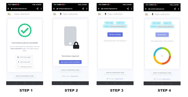

You need to scan this code to upload data from mobile phone. Once you scan and click on the URL, you need to go through the steps as illustrated in following figure.
Image: Steps to record data
In STEP 1 once your phone is connected, click on collecting audio button. In STEP 2 click give access to microphone button. In STEP 3 specify label (cough and healthy breathing in this example), length values and click on start recording button. Then record the data as in STEP 4, the data will be automatically uploaded to Edge Impulse after recording is done. You can record data for different labels in this way. The uploaded data is visible on your project's dashboard on Edge Impulse.
Image: Data on Edge Impulse

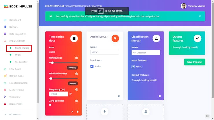

After this choose Create Impulse under Impulse Design in the left navigation and add processing and learning blocks as per following figure.
Image: Design impulse

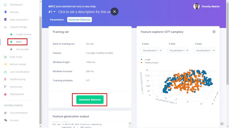

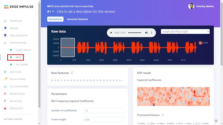

Then go to MFCC and verify your data. You can filter out data at this step.
Image: MFCC verify/filter data
Once you done, click on save parameters option.
Image: MFCC: save parameters
After this the following window will appear, in this window click on Generate Features button.
Image: Generating features

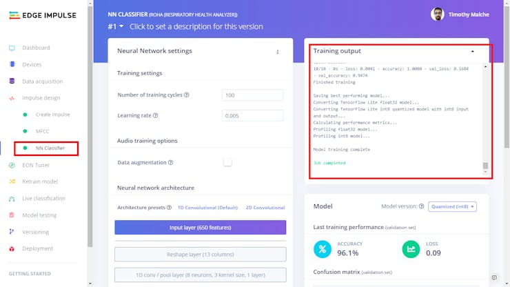

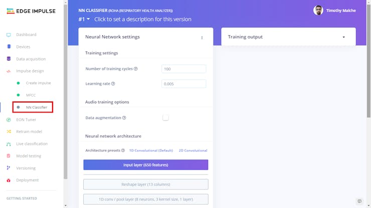

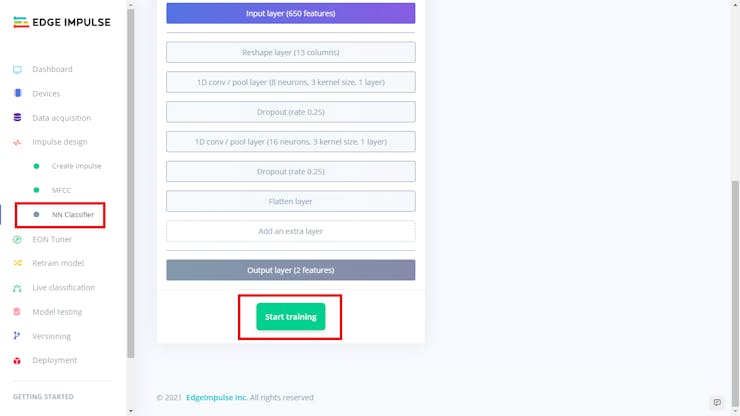

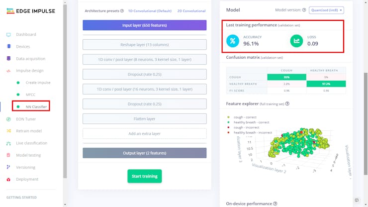

Then choose NN Classifier from left navigation.
Image: NN settings
You can change settings or leave it default. Then click on start training.
Image: Start Training
Your model will be trained and you will see the result.
Image: Training output
Image: Model accuracy

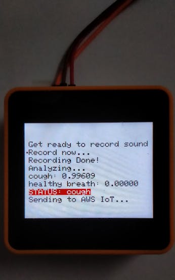

From the above figures we can see that our model is perfectly build and trained on data. You can choose Live Classification in the left navigation to test the data. You can then choose your phone to get data for live sampling by clicking start sampling button or load the existing sample test data by choosing sample data from drop down list and clicking load sample button.

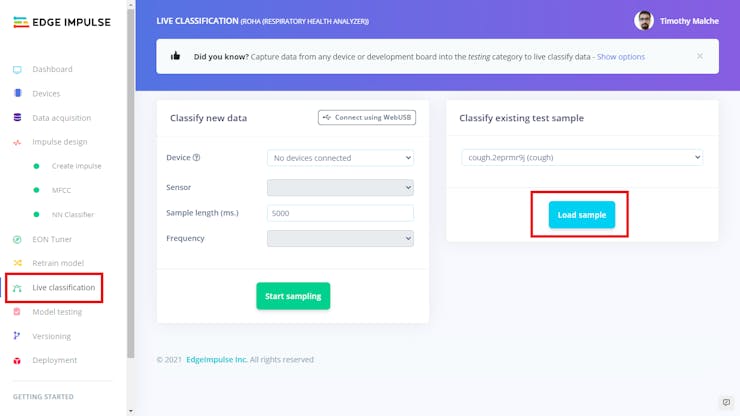

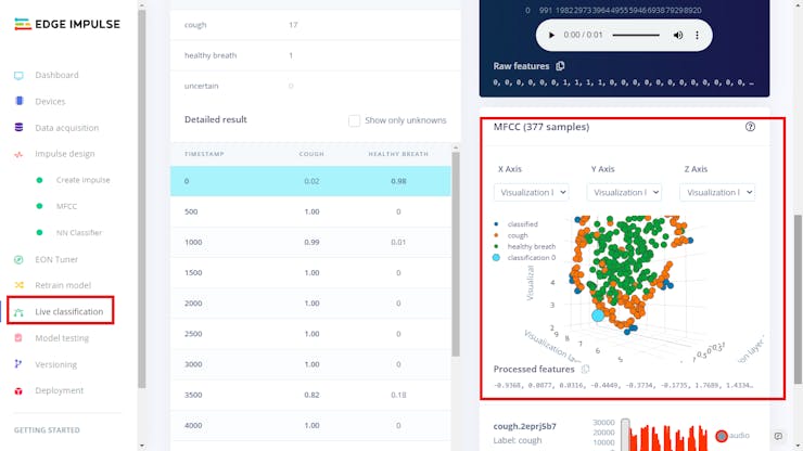

Image: Load sample
When you load the sample, the live classification will be done and you can see the model performance.
Image: Live classification result

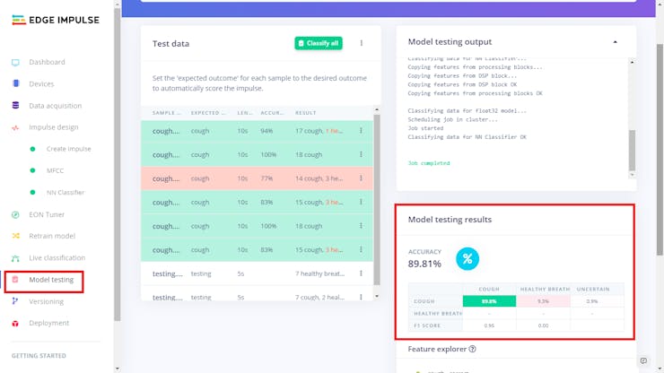

Live classification test your model against single sample at a time. You can choose the Model Testing option to test your model against multiple test samples from test data. For this click on the Classify all button and you will see the model performance. As you can see in following figure that my model is working perfectly.
Image: Model Testing

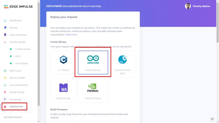

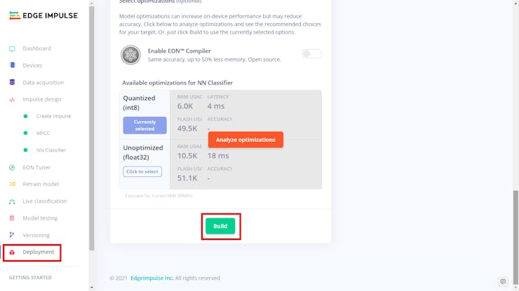

Once you done the testing choose Deployment from left navigation to create the library that we will use later on to build the firmware. In the window that appear choose Arduino Library.
Image: Deploy as Arduino Library
Now scroll down and click on build library button.
Image: Build the library

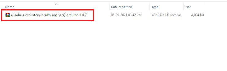

The Edge Impulse automatically build the library and it will be automatically downloaded as zip file.
Image: Arduino library as Zip file
Keep this zip file for next step.

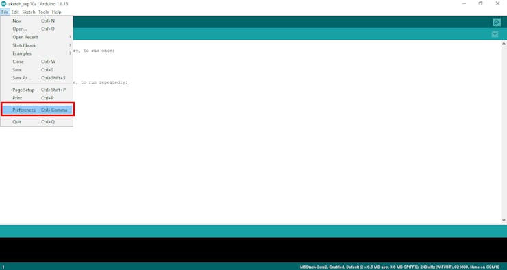

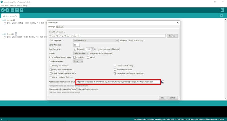

First download the official Arduino IDE. Now first we need to install ESP32 Boards Manager. For this open up the Arduino IDE, and navigate to
File -> Preferences -> Settings
.Image: Arduino settings
Add the following ESP32 Boards Manager URL to Additional Boards Manager
https://m5stack.oss-cn-shenzhen.aliyuncs.com/resource/arduino/package_m5stack_index.json
Image: Additional Boards Manager URL

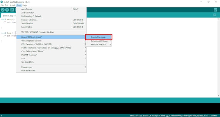

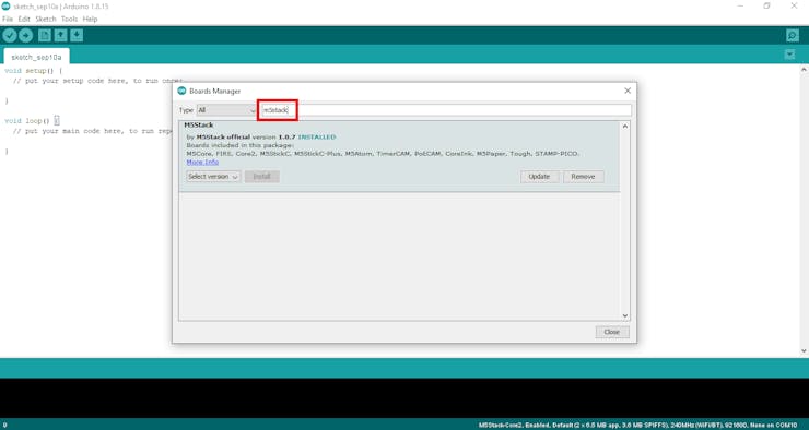

Then
go toTools->Board->Boards Manager
Image: Boards Manager
And search
m5stack
in the Boards Manager window, and click Install.Image: Install M5Stack Board

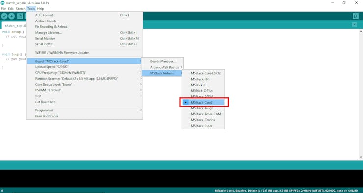

Once board is installed, go to
Tools -> Board: -> M5Stack Arduino -> M5Stack-Core2
as your board as shown in the following figure.Image: Select board

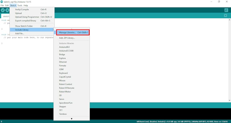

Now we also need M5Stack Library to work with. Go to
Sketch -> Include Library -> Manage Libraries...
Image: Manage Library

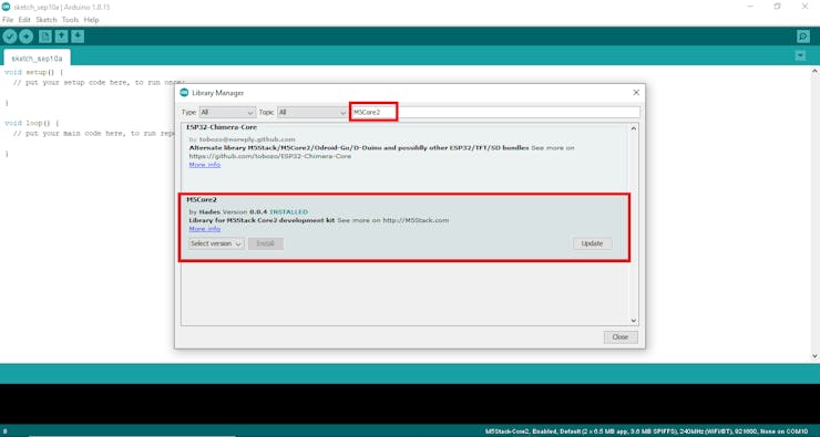

Then search
M5Core2
, find it and click Install.Image: Install M5Core2 Library

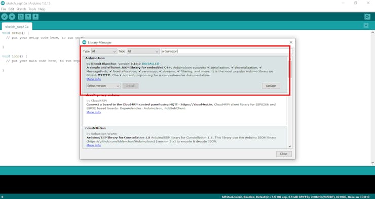

You will also need ArduinoJson library that we will use later on.
Image: Installing ArduinoJson Library

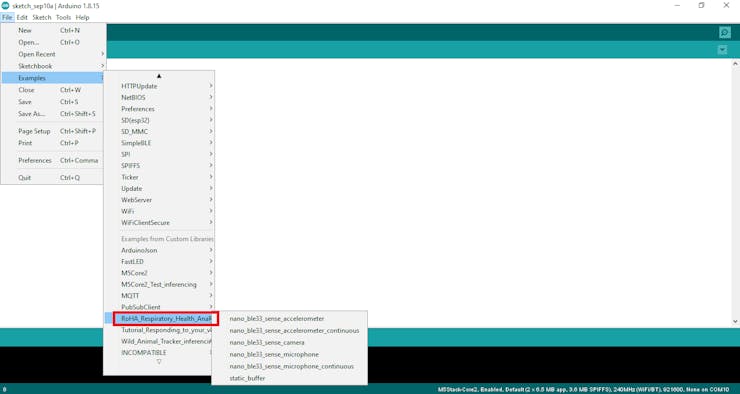

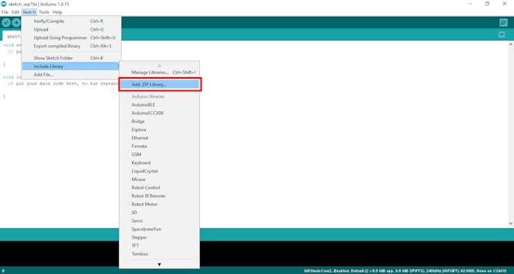

Now we will add the zip library for our model that we have developed using Edge Impulse. For this go to
Sketch -> Include Library -> Add ZIP Library...
Image: Add ZIP Library
and
select the ZIP library.Image: Select ZIP library
Once the library is installed you can see it in Arduino IDE.
Image: RoHA Library is installed

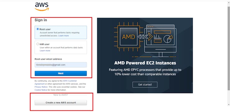

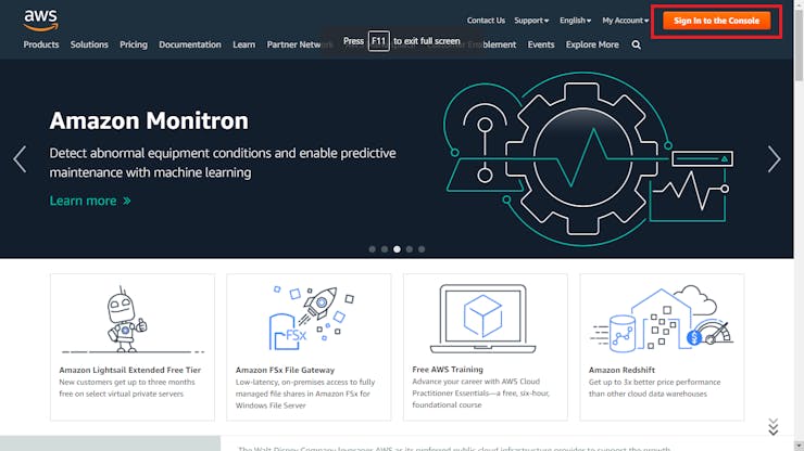

For this step first you need AWS account and need to sign in to the AWS Console your account.
Image: Sign in to Console
If you don't have account then click on create new account otherwise sign in.
Image: Sign in to AWS Console or create account

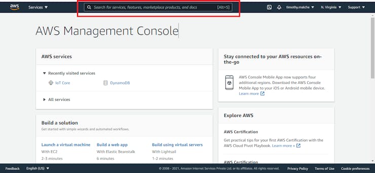

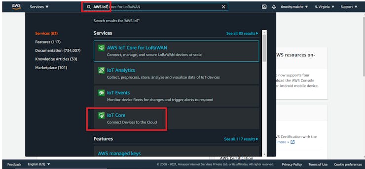

After you sign in you will see AWS Management console. We will use the search box to access different services.
Image: AWS Management console (main page)

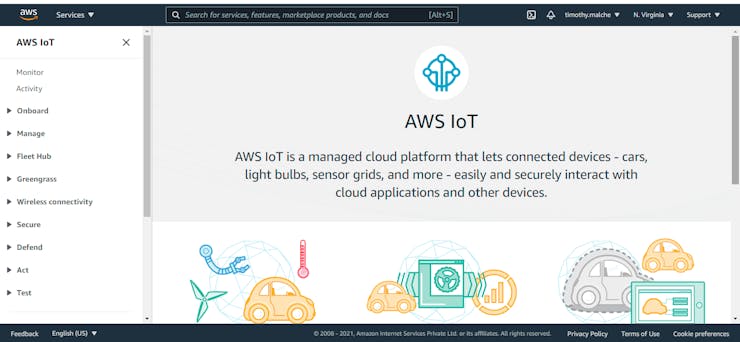

In the search box type AWS IoT and select IoT Core.
Image: Select ASW IoT Core
You will see the following page.
Image: AWS IoT main page

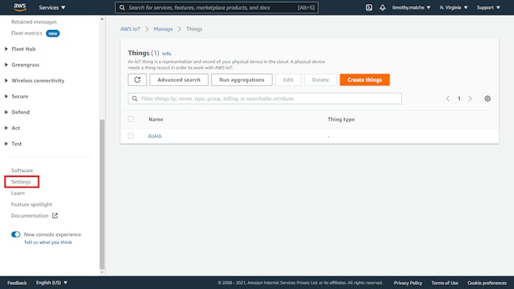

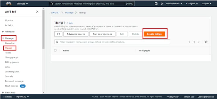

Now go to Manage in on the left navigation and choose Things and in the window on the right click Create things Button.
Image: Creating Things

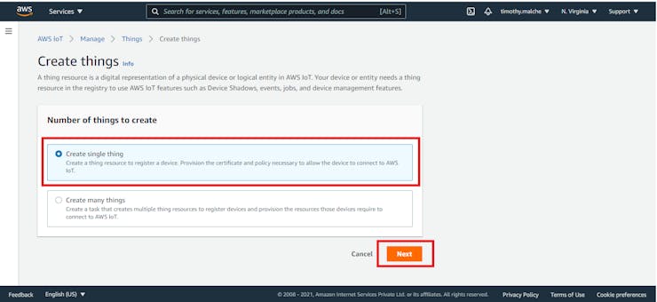

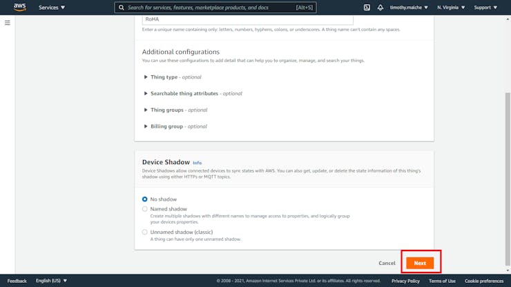

In the next window choose Create single thing option and click on Next button.
Image: Create a single thing

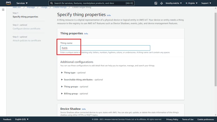

Next, specify your Thing name.
Image: Specify Thing name
Leave other settings as it is and click on Next button.
Image: Create Thing

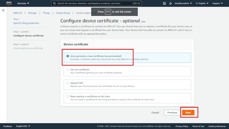

In the next window choose option Auto-generate a new certificate and click next.
Image: Auto-Generate certificate

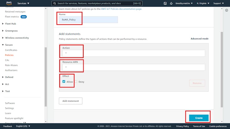

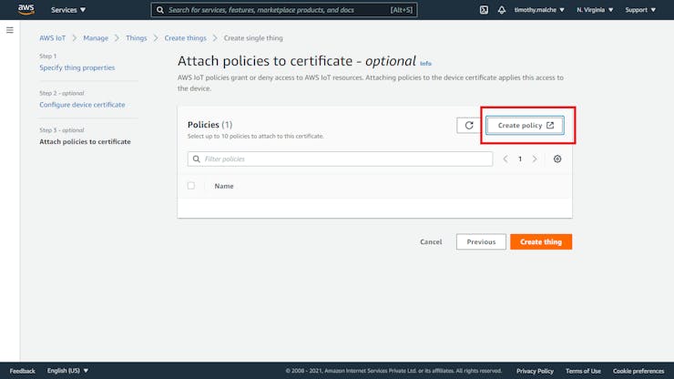

In the next window click Create policy. It will open in new window. You can also create and attach policy later on but its good to create it here.
Image: Create policy
In the window that appear in new tab/window of your web browser, specify a unique name to the policy and Action as * and Resource ARN as * as well and under Effect select Allow. After this click on Create button.
Image: Policy Settings
Image: Policy created

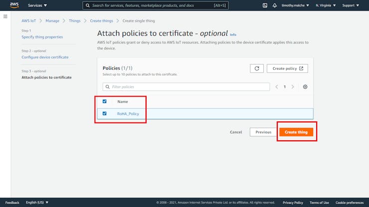

Now come back to previous window from browser tab there you will see the name of policy you have created. Now select the policy to attach it with your Thing and then click on Create thing button.
Image: Attach policy and create thing

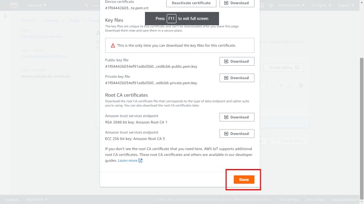

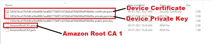

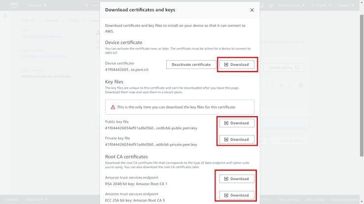

When thing is created you will be prompt to download certificate and keys. Download them and keep at safe place.
Image: Download certificate and keys
After you have downloaded, click Done button.

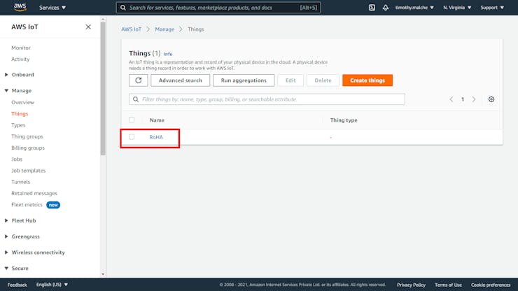

Image: Create Thing
You will see your thing created with the policy attached to it.
Image: Thing created

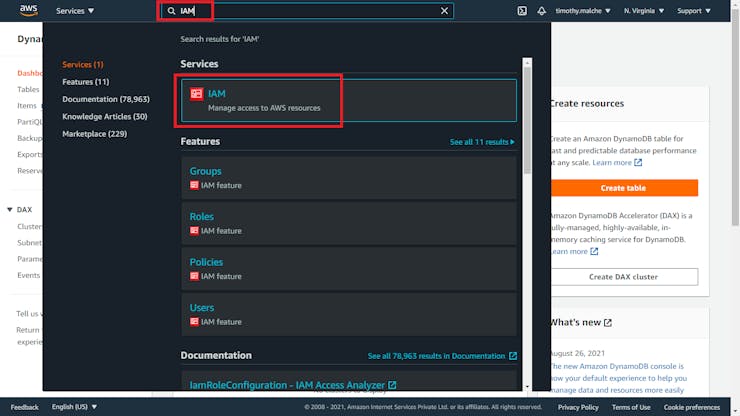

4Configure IAM
AWS Identity and Access Management (IAM) enables you to manage access to AWS services and resources securely. Using IAM, you can create and manage AWS users and groups, and use permissions to allow and deny their access to AWS resources. We need this step as we will be using DynamoDB service in PHP application. Therefore to access DynamoDB programmatically or through the AWS Command Line Interface (AWS CLI), we must have an AWS access key. Access keys consist of an access key ID and secret access key, which are used to sign programmatic requests that you make to AWS. For this we first need to create IAM user and then create the access key. To access IAM service type IAM in the search bar of AWS console and choose IAM.
Image: Access IAM service

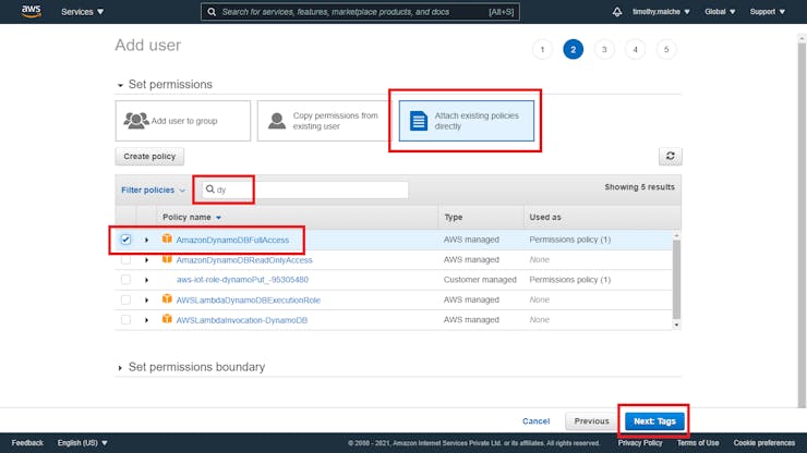

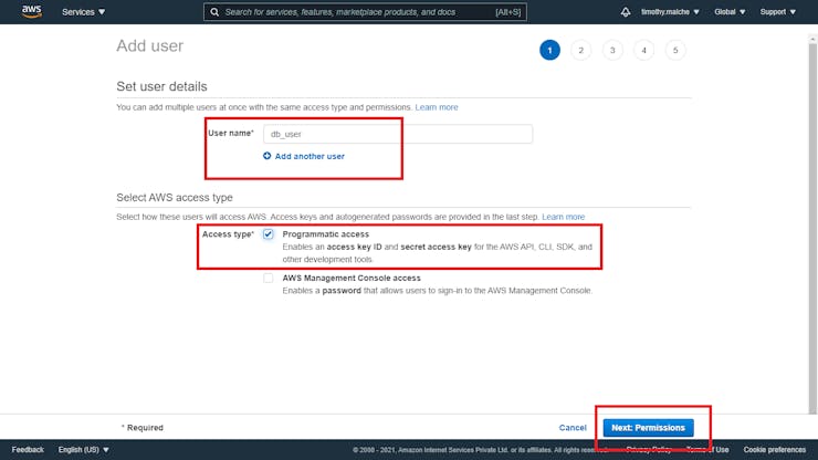

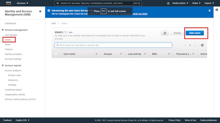

In the dashboard click on users on the left navigation and then click Add user button on the right side.
Image: Adding User
Specify the unique user name as db_user and and select Programmatic access and click on next button.
Image: DB user settings
In the next window click on tab Attach existing policies directly and in filter policies type 'dy' and select AmazonDynamoDBFullAccess. After this click on next button.
Image: Attach policy to user

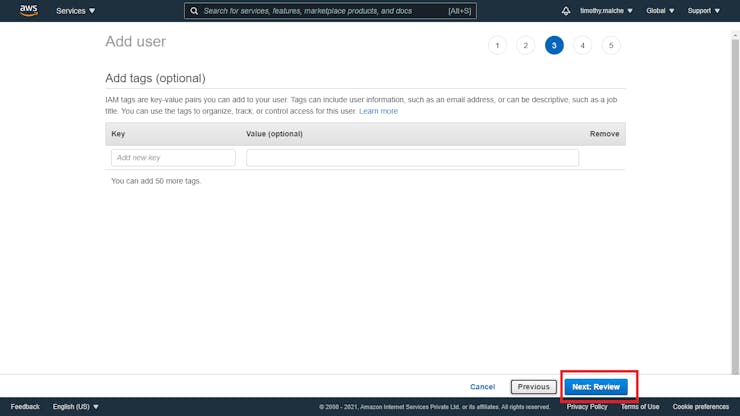

The Add Tag window will appear. This is optional step so just go to bottom of page and click next.
Image: Add tag (no setting required)
Next, review the settings and click Create user button at bottom.
Image: Review settings

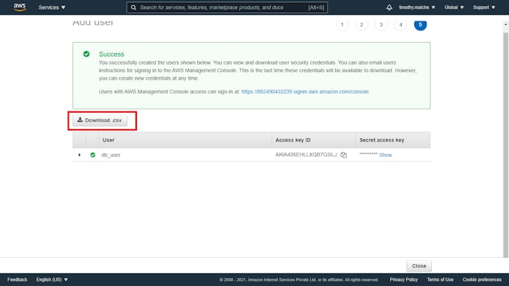

The user will be created. You can now get the Access key ID and secret key from the page and even you can download the same in CSV file for later use. This will be required in our PHP program.
Image: IAM User credentials

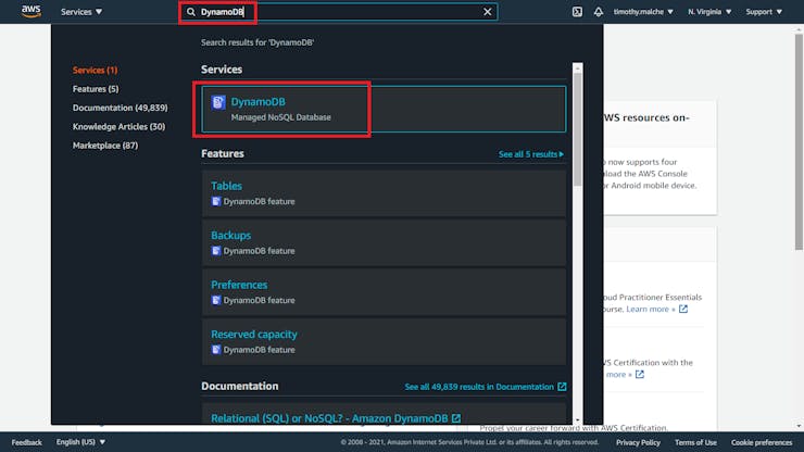

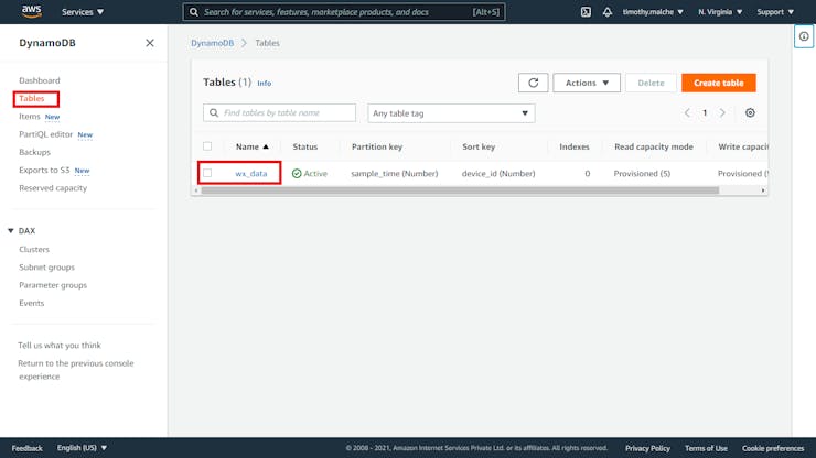

5Configure DynamoDB service
In this step we are going to configure DynamoDB database service where our data will be stored permanently. To access DynamoDB service, go to AWS Console and in search box type DynamoDB then from the list select DynamoDB.
Image: Search DynamoDB service
The dashboard of DynamoDB will open.
Image: DynamoDB Dashboard

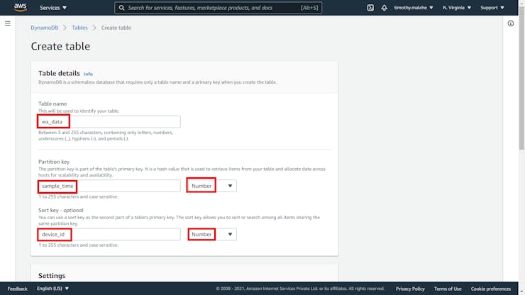

In the dashboard click on Create table button. We'll create a DynamoDB table to record data from sensor node.
- In Table name, enter the table name:
wx_data
. - In Primary key, in Partition key, enter
sample_time
, and in the option list next to the field, choose Number. Check Add sort key. - In the field that appears below Add sort key, enter
device_id
, and in the option list next to the field, choose Number. - At the bottom of the page, choose Create.
We'll define
device_data
later, when we configure the DynamoDB rule action.device_data
field will be used to store the actual data from sensor node.Image: Table details

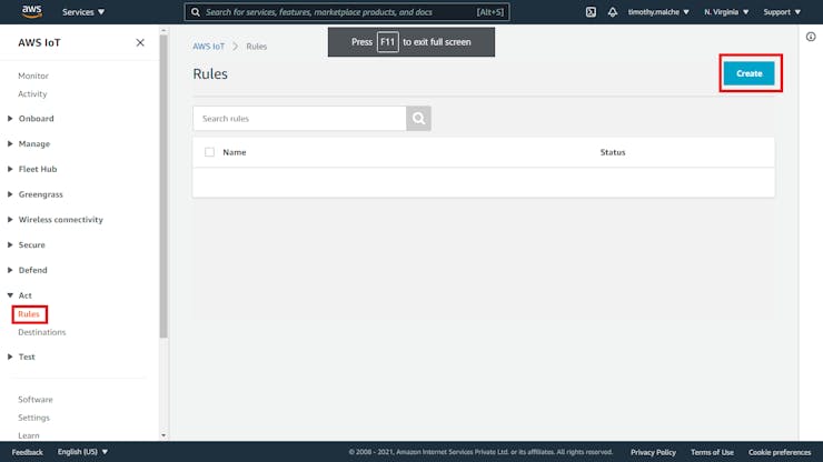

- Open the Rules hub of the AWS IoT console.
- To start creating your new rule in Rules, choose Create.
Image: Creating rule

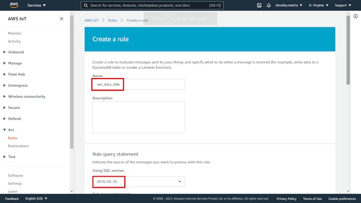

In Name, enter the rule's name,
wx_data_ddb
. In Using SQL version, select<b>2016-03-23</b>
.Image: Specify rule name

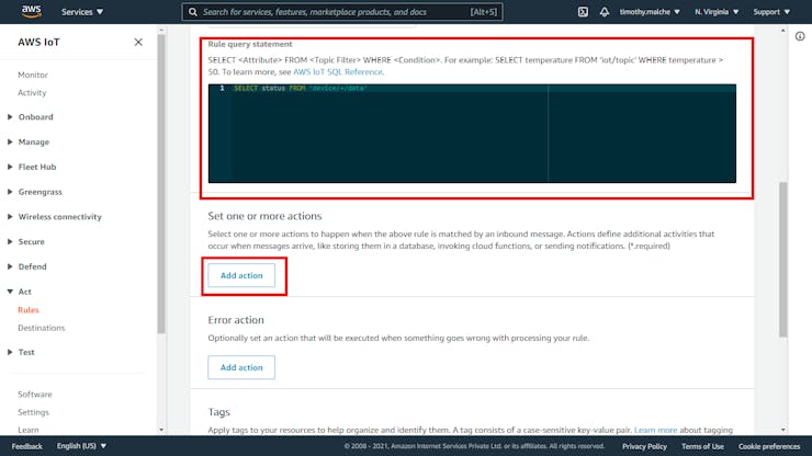

In the Rule query statement edit box, enter the statement:
SELECT status FROM 'device/+/data'
and then click Add action
Image: rule query statement

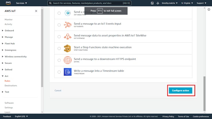

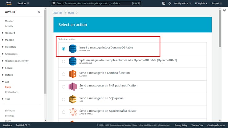

In Select an action, choose Insert a message into a DynamoDB table.
Image: Select an action
and then click Configure action.
Image: Select action

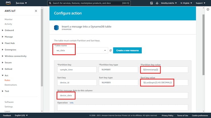

Now the configure action window will open.
- In Table name, choose the name of the DynamoDB table you created in a previous step:
wx_data
. - In Partition key value. enter
${timestamp()}
. - In Sort key value, enter
${cast(topic(2) AS DECIMAL)}
. - In Write message data to this column, enter
<b>device_data</b>
. This will create thedevice_data
column in the DynamoDB table to store data from sensor node. - Leave Operation blank.

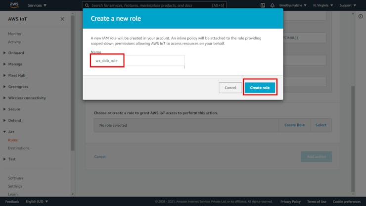

- In Choose or create a role to grant AWS IoT access to perform this action, choose Create Role.
- In Create a new role, enter
<b>wx_ddb_role</b>
, and choose Create role.At the bottom of Configure action, choose Add action. - To create the rule, at the bottom of Create a rule, choose Create rule.
Image: Create role

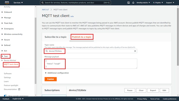

7Test the AWS IoT rule and DynamoDB table

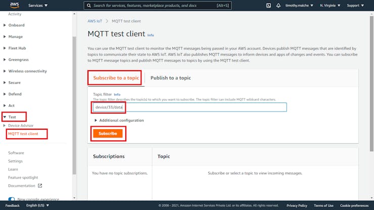

Now we will test if the rule is working. To test the new rule, we'll use the MQTT client to publish and subscribe to the MQTT messages used in this test. Go to AWS IoT Core, in the left navigation go to
Test -> MQTT test Client
In the MQTT client, choose Subscribe to a topic. For Topic filter, enter the topic of the input topic filter,
<b>device/+/data</b>
. Choose Subscribe.Image: MQTT Subscribe

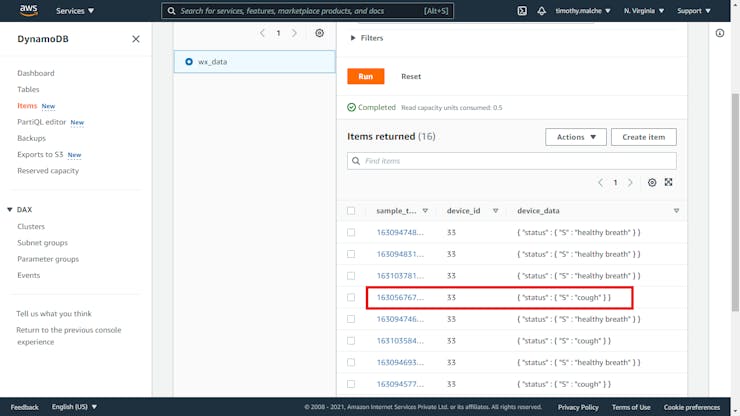

Now, publish a message to the input topic with a specific device ID, device/33/data. You can't publish to MQTT topics that contain wildcard characters.
In the MQTT client, choose Publish to a topic. For Topic name, enter the input topic name, device/22/data. For Message payload, enter the following sample data.
{"status" : "cough"}
Image: MQTT Publish

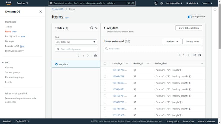

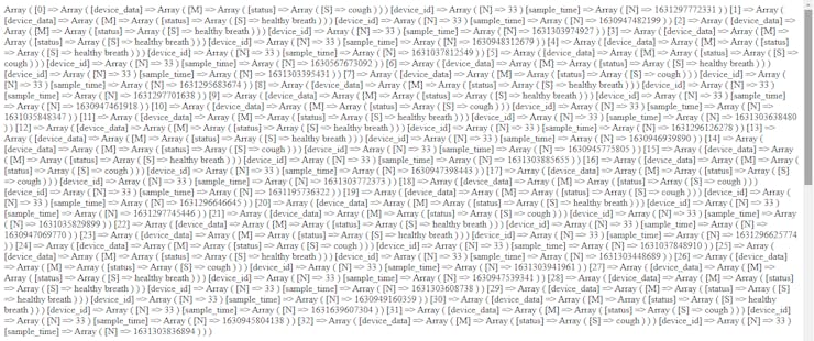

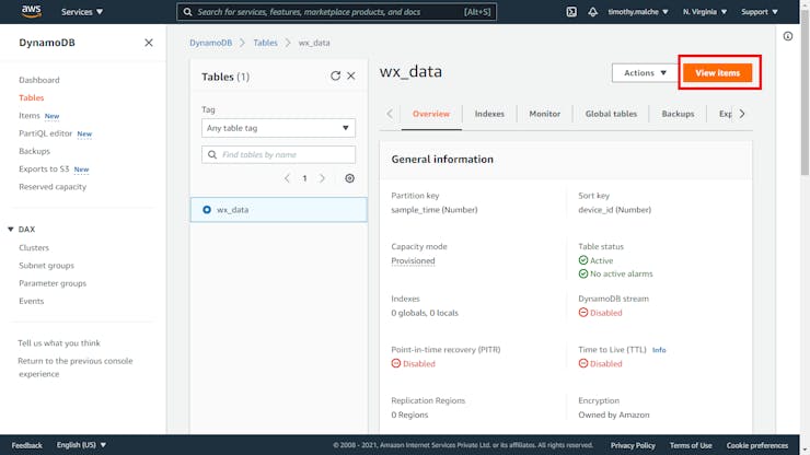

When you click publish button, you will see the data published and when you open the DynamoDB table you will see the same data being stored there.
To view data published go to DynamoDB dashboard, click on Tables in the left navigation and in the window on right click on your table name.
Image: Select table to view data
In the next window, click on view items.
Image: Click to view table data
In the open window, scroll down to view data there you can see the data.
Image: View DynamoDB data

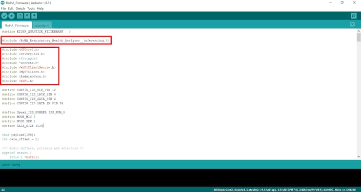

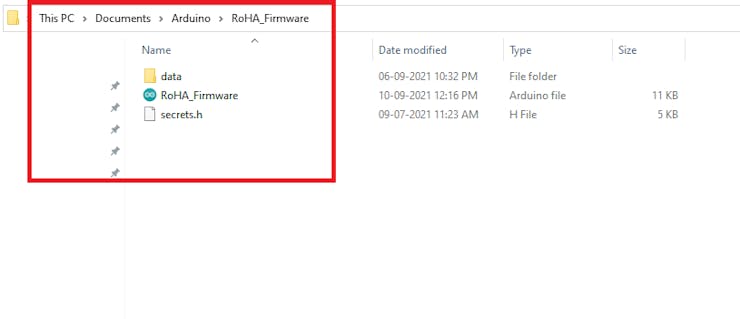

8Build the firmware

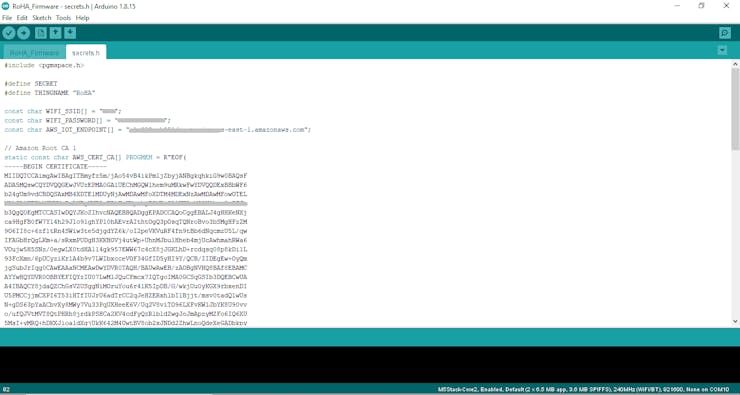

Open the Arduino IDE and create a new sketch with name
RoHA_Firmware.ino

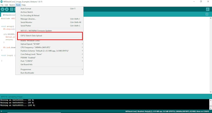

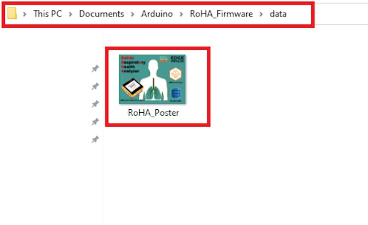

. Create a header file with namesecrets.h
in the same folder and one subfolder named data.secrets.h
header file stores device certificate and keys and data folder will contain an image that we will load on sensor node when it boots up. Your directory structure would look like following.Image: Firmware directory structure
Following is the structure of
secrets.h
file#include <pgmspace.h> #define SECRET #define THINGNAME "RoHA" const char WIFI_SSID[] = "WIFI SSID"; const char WIFI_PASSWORD[] = "WIFI PASSWORD"; const char AWS_IOT_ENDPOINT[] = "YOUR AWS END POINT HERE"; // Amazon Root CA 1 static const char AWS_CERT_CA[] PROGMEM = R"EOF( -----BEGIN CERTIFICATE----- -----END CERTIFICATE----- )EOF"; // Device Certificate static const char AWS_CERT_CRT[] PROGMEM = R"KEY( -----BEGIN CERTIFICATE----- -----END CERTIFICATE----- )KEY";
In the file you need to paste the
Amazon Root CA 1
,Device Certificate
, andDevice Private Key
which we have downloaded in the Configure AWS IoT core step of this project documentation. You also need to specify yourWiFi SSID

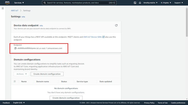

,PASSWORD
, andAWS Endpoint
. It will look something like following.Image: secret.h file
You can get the values to
Amazon Root CA 1
,Device Certificate
from the files downloaded in step Configure AWS IoT core. See the following figure.The files the stores the credentials of AWS IoT Core for secrets.h file
Also, you can find the AWS IoT endpoint from AWS IoT Core console. Scroll down the IoT Core page to find the settings on the left navigation.
Image: Settings of AWS IoT Core
Click on settings, the following page will open. Copy endpoint name from there.
Image: AWS IoT Endpoint name
Now you can use the firmware code attached with this documentation in
RoHA_Firmware.ino
file. Before uploading the firmware we are first going to store the image to AWS IoT EduKit. This image will be used as startup image that will appear on sensor node screen when the firmware loads. To upload image we need a Arduino ESP32 filesystem uploader plugin for Arduino. Download the ESP32FS-1.0.zip file and extract it to../Arduino/tools

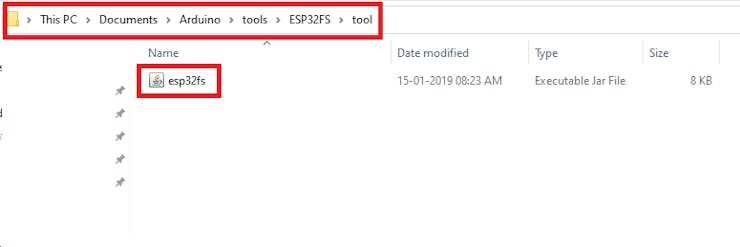

folder. The directory structure should look like following.Image: Data uploader plugin path
If there is no tools folder under Arduino folder then create it.
Restart the Arduino IDE and you should be able to see the option to upload data as shown below.
Image: ESP Sketch data upload
now store the image in the data folder within the main firmware folder. The directory structure will be as follows.
Image: Firmware Data Folder
The resolution of image should be 320x240.
Now first upload the data using ESP32 data upload tool in Arduino and then compile and upload the firmware also. Make sure that you have included the correct model library and other required library.
Image: RoHA Firmware Code
We will now understand the few important lines in firmware code. In the code the following variable is used to store data from microphone.
static signed short sampleBuffer[2048];
The topic to which sensor node can publish and subscribe are following.
// The MQTT topics that this device should publish/subscribe #define AWS_IOT_PUBLISH_TOPIC "device/33/data" #define AWS_IOT_SUBSCRIBE_TOPIC "device/33/data"
The
connectAWS()
function connects to AWS IoT core. The function uses AWS IoT devices credentials and endpoint fromsecrets.h
header file.void connectAWS(){ WiFi.mode(WIFI_STA); WiFi.begin(WIFI_SSID, WIFI_PASSWORD); Serial.println("Connecting to Wi-Fi"); while (WiFi.status() != WL_CONNECTED){ delay(500); Serial.print("."); } // Configure WiFiClientSecure to use the AWS IoT device credentials net.setCACert(AWS_CERT_CA); net.setCertificate(AWS_CERT_CRT); net.setPrivateKey(AWS_CERT_PRIVATE); // Connect to the MQTT broker on the AWS endpoint we defined earlier client.begin(AWS_IOT_ENDPOINT, 8883, net); // Create a message handler client.onMessage(messageHandler); Serial.print("Connecting to AWS IOT"); while (!client.connect(THINGNAME)) { Serial.print("."); delay(100); } if(!client.connected()){ Serial.println("AWS IoT Timeout!"); return; } // Subscribe to a topic client.subscribe(AWS_IOT_SUBSCRIBE_TOPIC); Serial.println("AWS IoT Connected!"); }
The sensor node publishes the topic to AWS IoT Core.
void publishMessage(){ StaticJsonDocument<200> doc; doc["status"] = payload; char jsonBuffer[512]; serializeJson(doc, jsonBuffer); // print to client client.publish(AWS_IOT_PUBLISH_TOPIC, jsonBuffer); }

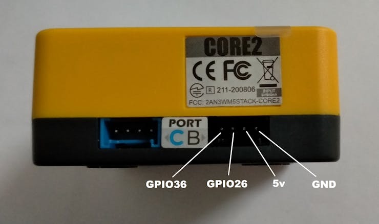

In the
setup()
function the PIR sensor is configured on pin 36 on PORT B.pinMode(36, INPUT);
Image: Pins on PORT-B

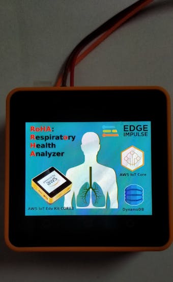

The following code in
setup()
display the startup image on device LCD when firmware is loaded.M5.Lcd.drawPngFile(SPIFFS, "/RoHA_Poster.png", 0, 0);
The main
loop
display the main screen of firmware and PIR sensor data and waits for users input to record the vocal data. When the user press the left button on AWS IoT Edu Kit, the voice data recording starts and after recording is done the inference is run and output is displayed on screen. Afterwards the data is published to AWS IoT core and the main screen is again displayed to user.void loop() { M5.update(); display_title(); //Display main screen display_pir(); //Display person contact alert //Enables touch on LCD TouchPoint_t pos= M5.Touch.getPressPoint(); //Detects left button click position if(pos.y > 240) if(pos.x < 109) { //when left button is pressed if(M5.Touch.ispressed() == true){ //Recording starts and then inference is run record_and_inference(); delay(2000); //send the inference data to AWS IoT Core send_data(); delay(2000); } } }
In the
function the following code displays the inferencing result on LCD of the device.record_and_inference(){ ... //Printing inferencing result on M5Stack LCD M5.Lcd.setTextColor(BLACK); M5.Lcd.setCursor(10, 126); M5.Lcd.printf("%s: %.5f\n", result.classification[0].label, result.classification[0].value); M5.Lcd.setTextColor(BLACK); M5.Lcd.setCursor(10, 146); M5.Lcd.printf("%s: %.5f\n", result.classification[1].label, result.classification[1].value); //checking which label has closest value if(result.classification[ix].value > 0.50000){ //storing the label text in payload strcpy(payload, result.classification[ix].label); //check what is the status and set text and background color accordingly if (strcmp(result.classification[ix].label, "cough")==0){ M5.Lcd.setTextColor(WHITE, RED); }else{ M5.Lcd.setTextColor(WHITE, BLUE); } M5.Lcd.setCursor(10, 166); M5.Lcd.printf("STATUS: %s", result.classification[ix].label); } ... }
The following function is invoked within
pdm_data_ready_inference_callback()
used to read data from microphone.i2s_read(Speak_I2S_NUMBER, (char *)(sampleBuffer), DATA_SIZE, &bytesRead, (100 / portTICK_RATE_MS));
The full firmware source code is attached with this document. Read instruction specified with the attached file before you upload it.

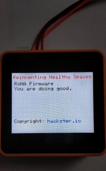

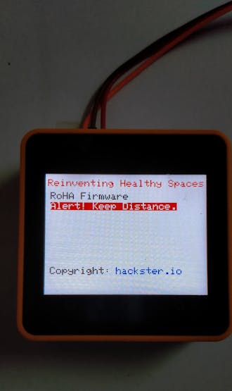

Image: Start Screen
Image: Main screen (social distancing maintained)
Image: Main Screen (Alert - person detected)
As you can see in the above figure, that an alert message is displayed whenever a proper distancing is not maintained. The

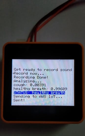

The following images show the result of inferencing.
Image: Inferencing result (healthy breath)
Image: Inferencing result (cough)
The sensor node activity can be tracked on AWS IoT Core using the Monitor option in the left navigation.
Image: IoT Core 'Monitoring' tool
The uploaded data can also be viewed in DynamoDB.
Image: DynamoDB Table values

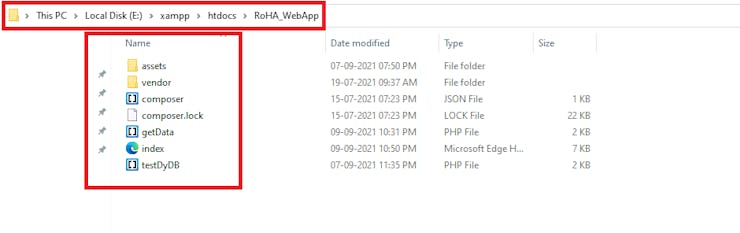

10Get AWS SDK for PHP & build Web App
Navigate to htdocs folder in the XAMPP webservers root directory and copy paste the entire
RoHA_WebApp
folder. This is your web application. It contains the files and directories as shown in following figure.On my system I have installed the AWS SDK for PHP in the
RoHA_WebApp
folder. Although the SDK is already included in the web application, you do not need to reinstall it. However you can find the installation steps here for knowledge.The directory structure of the
RoHA_WebApp
is as following.Image: Web Application Directory Structure

In the above code replace
YOUR_ACCESS_KEY_ID
with your access key id andYOUR_SECRET_KEY
with your secret key from the configure IAM step of this documentation. I used the scan to get data from dynamoDB.$response = $dynamodb->scan(array( 'TableName' => 'wx_data' ));

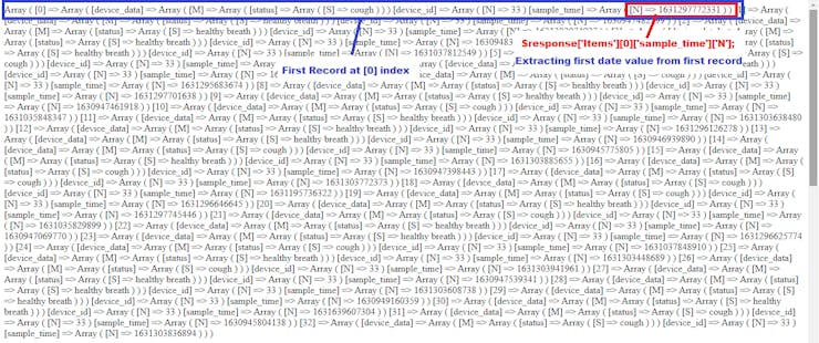

The DynamoDB scan operation returns the result in the form of array as shown below.
Image: DynamoDB Scan result
Therefore in order to display meaningful information to user we must extract the information from this data. For example the following line extract the first date time value from the result set.
$latestdate = $response['Items'][0]['sample_time']['N'];
The first date value is extracted as shown in image below and stored in
$latestdate
variable.Image: Accessing the first date value
Similarly the other values can also be extracted as shown in following image.
Image: Fetching values
