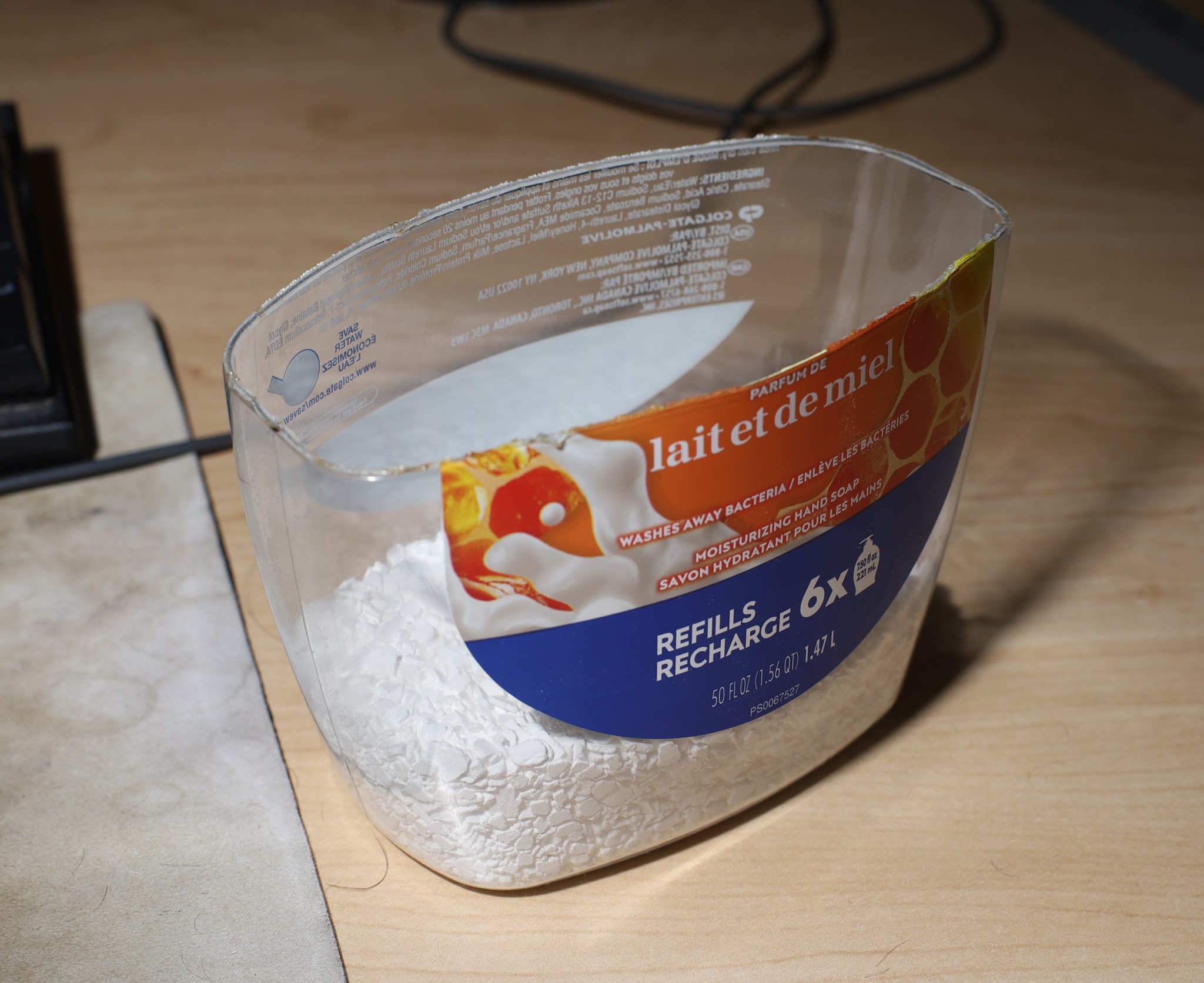

    Something needed to be done to improve the effectiveness of the desiccant, starting with getting rid of any kind of cover.  A new idea for storing the desiccant was an erlenmeyer flask inspired container with 2 holes.  Wet air would be forced in 1 hole so dry air emerged from the other hole.  The same fan should circulate air around the filament.  There wasn't enough room to fit such a flask in the drier.
    Eventually settled on a tall desiccant bin from a 50oz soap bottle.  64oz soap bottles from 10 years ago would be too wide.
    Helas, the tall desiccant bin requires the container to always be stored vertical.

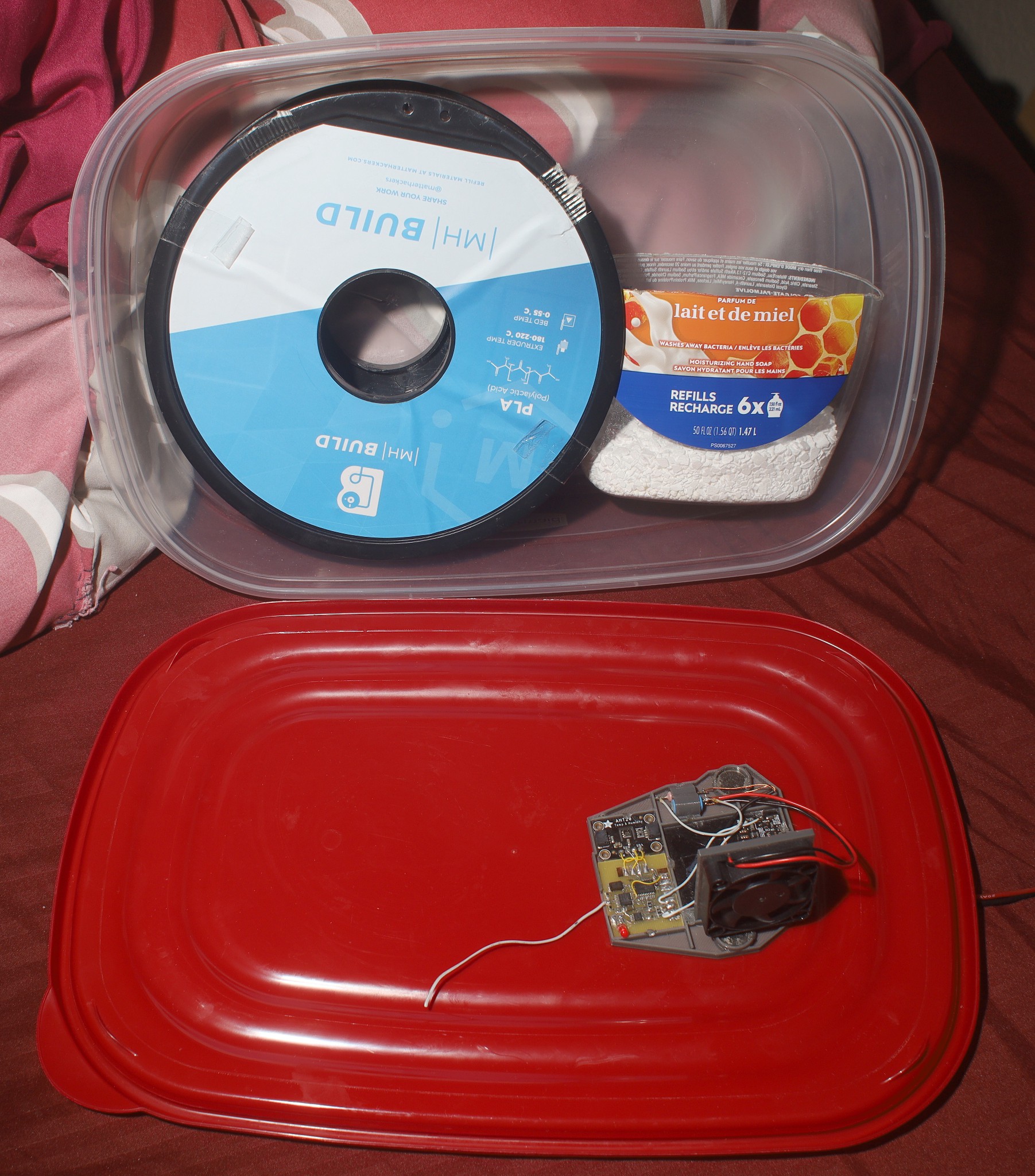

    Would have been easier if the jumper wires were straight across, but mounting the AHT20 at a right angle would make it vulnerable to vibration.
    The mane router upgrade was an LED for received desk code.  It's suffering from extreme packet corruption but desk 1 also seems to miss a lot of wifi packets.  It may require a 2nd microcontroller for just decoding the 433Mhz signal.
    Adding filament drier data to the apartment server was a big job, it's remarkable that the exterior weather station still works, given its condition.  There is a desire to upgrade all the radios to 100kbaud, but this would make it difficult to parse the 433Mhz signal in software.
    A few hours with this showed the new container getting a lot hotter than the old container.  Less leaking & more exposed area got it to roast.
    The 1st data logging attempt had a few problems. The mane problem is the lid not being flat. The only place for it is right next to the filament. The antenna can't be extended & the fan has to be right next to the filament.  The signal still reaches the router.
    The fan has to go in the middle on the opposite side.  The magnets have to go right next to the charger  coil & diagonally.  The RC circuit needs some fixtures.
    If the Qi receiver is folded over & double sided taped together, it should free up more space.
    The Qi receiver still needed a 5 ohm, 220uF RC circuit to power the fan.
    A big problem is the desiccant spilling everywhere despite being covered.

    So the aquarium sealant on the previous container degraded & let air through.  Powering a fan without penetrating the container was the great task.
    A quick test with a used Qi charger said fuggedaboudit. It couldn't power the inductive load of the .4A fan for any amount of time. The BQ51013 got to 4.4V, got hot & it constantly reset.  There are BQ51013 breakout boards with better heat sinking, for a price.
    If it charged a battery which powered the fan, no battery would survive inside the heated chamber.  Then of course, there's blocking out part of the chamber with solar panels.  It would only work during the few hours of direct sunlight & it wouldn't get as hot.  A double Qi charger might do the job but burn at least $20.

    The optimum container for side by side placement was a 1.1 gallon Rubbermaid.
    The bigger problem is the container longevity. Container longevity & getting signals in the container without creating holes is a super hard problem. There are concepts for inductive power, but getting enough power for the fan is tricky. For now, the fan & sensor were abandoned.
    A few days of this yielded perfect parts.  Results seem to take just 1 day in the sun with no fan.
